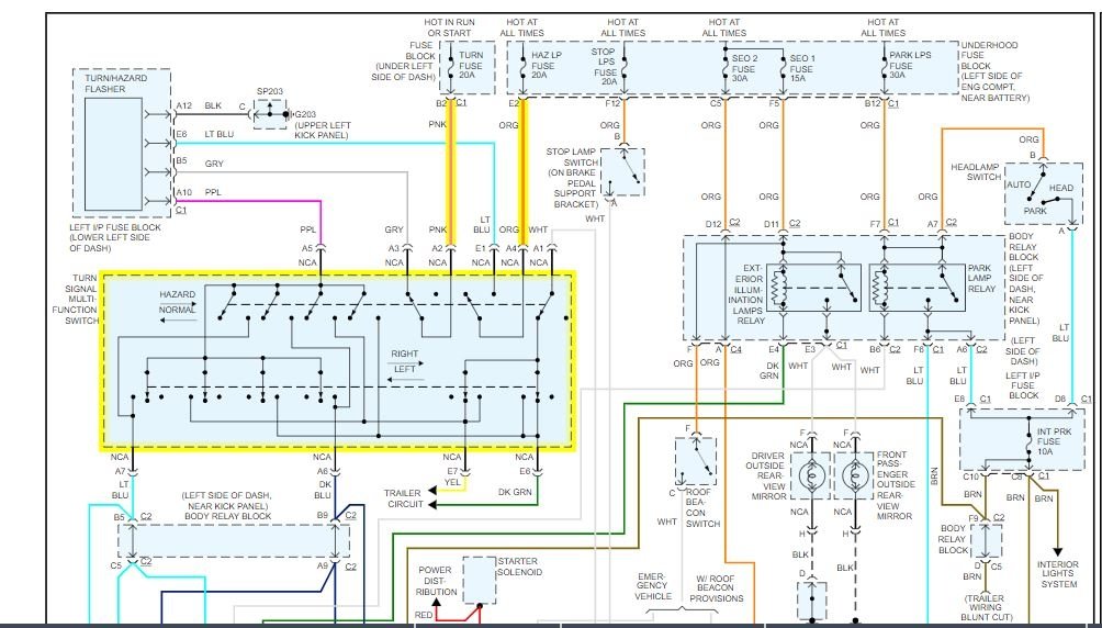

Replaced combination switch because of a short and loose wire. replaced light control switch which turns on and off lights with the dimmer wheel on it. still no lights.
Apr 20, 2019 at 7:36 AM
Good evening,

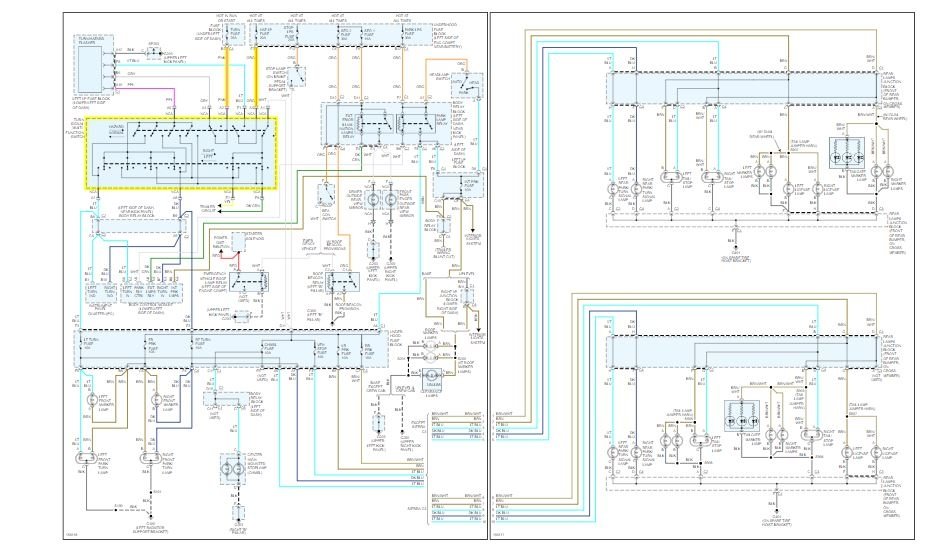

I attached a wiring diagram for you to view. Verify power on both fuses on both sides for the power to the switch.
If you have a test light, check for power out of the switch with the lights on.
