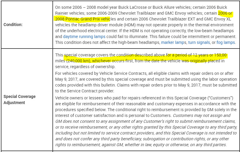

My low beams stopped working only the high beams. I fixed the relay and the low beams worked again. Now low beams turn on and off. Trun on for a few seconds then turn off, only headlights working are high beams, and while the high beams on the low beams come on and off.
Oct 13, 2022 at 1:43 AM
  • 110,248 POSTS
Hi:

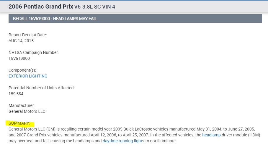

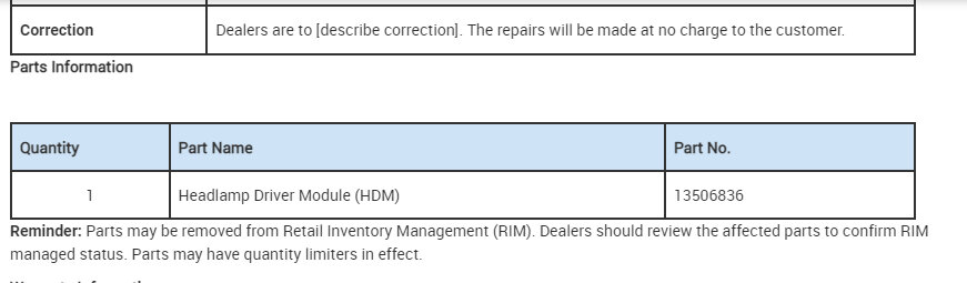

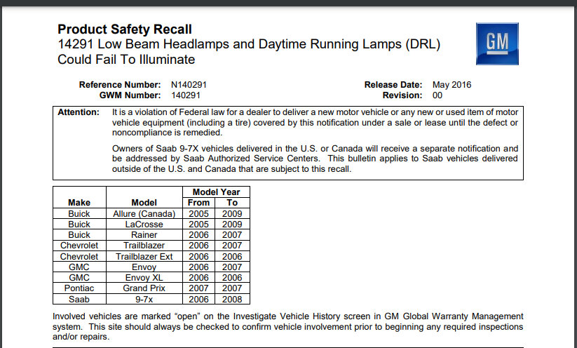

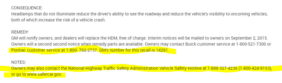

I have a feeling the headlamp driver module (HDM) is bad. There was actually a recall on this issue for the 2006 - 2008 model year vehicles.
I attached a few pics below that provide info related to this issue. I'm thinking they may not cover it because of the model year. However, contact a (GM) dealer and see what they suggest.
Let me know what you find.
See pics below. Note: the last two pics are from my manual and provide directions and phone numbers to contact.
