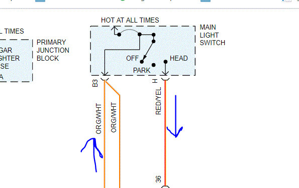

Car listed above is the LX model. First left bulb went out then right bulb, changed light bulbs work for 5 miles then headlights turned off. parking lights still work. cleaned and made sure grounds are all good connections. Still no headlights. I'm wondering if there's any common problem with headlights with these vehicles. if anybody could help I would definitely appreciate it! TYA

Does the vehicle have daytime running lights? Also, do they work and then stop again?When they fail to work, is it both high and low beam?

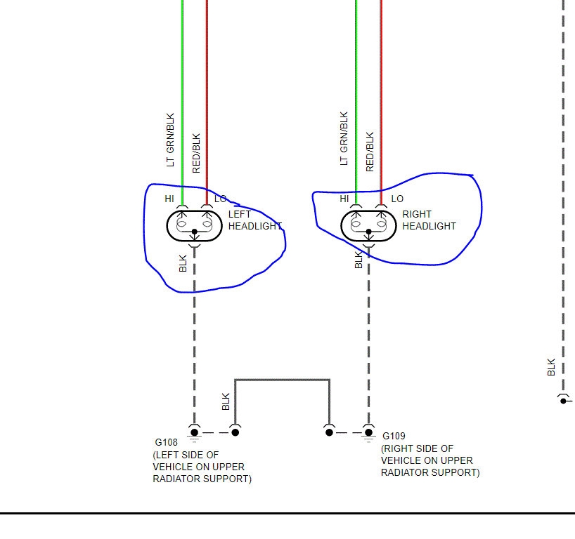

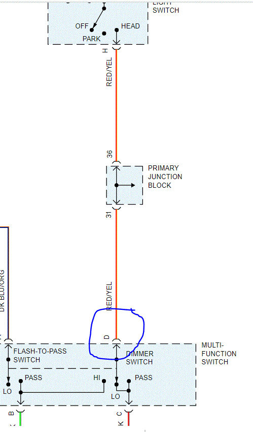

If you look at pic 1, it shows this is a basic design, so we need to first, confirm that there is no power to the wiring at the lights. If there isn't, move back to the dimmer switch to check power at the wire I circled in pic 2.

I suspect it is the switch itself. In the early 1990's and older, many of these vehicles had an internal circuit breaker in the switch.
So, what needs to be done is this. Go to the switch and confirm there is power to it. Look at the attached pics. Following my arrows, power goes to the switch via the orange / white wires. Confirm there is power. Next, with the lights on, check for power from the red/yellow and let me know what you find.
