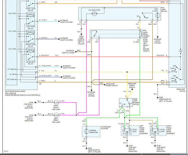

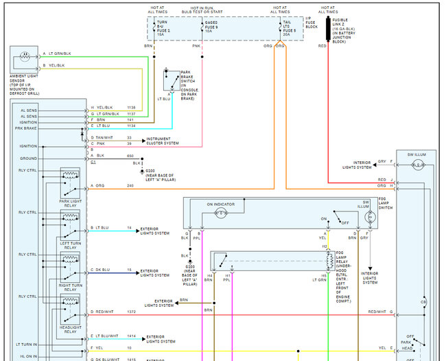

I need the wiring diagram for a 96 Pontiac firebird headlight switch.
Feb 8, 2026 at 2:11 AM
Experienced Mechanic
55,691 POSTS
Sure, here is the wiring diagrams for the headlight switch as requested. Check out the images (below). Let us know if you need anything else.
