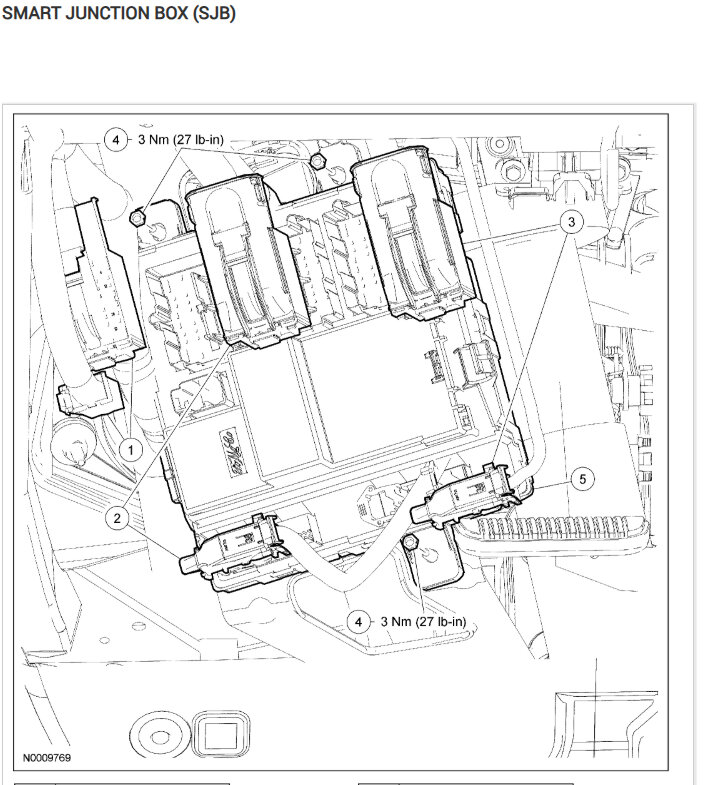

Yep, I would look for melted connector at the fuse #19 which is in the fuse panel under the hood and can cause this issue. You can upload a short video or image of the fuse if you are unsure. If that look okay chances are the SJB is bad which is at the left side of the dashboard and it is very common to go bad. Here is the location so you can swap it out which should fix the problem. I will email you the SJB as well. Check out the images (below). Please let us know what happens.

thanks. The thumbnail doesn't show anything. I got an email from you with sbj diagram but not the legend that tells me what the numbers are pointing to.

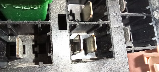

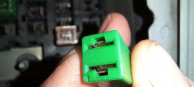

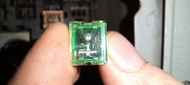

the diagram you sent doesn't have any labels. I don't know what I'm looking for on the sjb. here is a video of sjb and pics of fuse.

  • 55,748 POSTS
The image of the fuse is hard to tell what is it is good or not so I would try a new fuse or test that one with a volt meter set to continuity. Yep, that is the BCM - SJB here is a scanner that will work for your 2005 car.

DAVENOOB
  • 371 POSTS
The fuse is intact with no corrosion on tabs or insert. The sjb I have issues with. How do I get those big wiring harnesses off? I unlocked the catch but not sure if I can wiggly it out or pry it out? Where am I supposed to be looking for damage? I can't see anywhere around the box. Do I need to remove the box to see properly? If so do yiu have a video? I have no clue when it comes to electrical. Thanks again. will run continuity test on fuse. Now if I run a continuity test where the fuse goes should it beep or have any voltage readings? Will that help diagnose?
Nov 23, 2025 at 7:29 AM
DAVENOOB
  • 371 POSTS
fuse past the continuity test. I put multimeter to the tabs where the fuse goes and it read 12.38v with the engine and lights off. I tested other fuse spots and they had no voltage draw. I don't know what that means but does this help or prove anything?

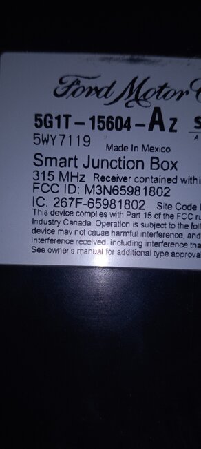

I pulled this sjb off the exact same car but numbers seem different. Will this one work?
Dec 14, 2025 at 8:58 AM
  • 55,748 POSTS
It might, if the connectors plug in I would give it a try. Let me know please. Ken
