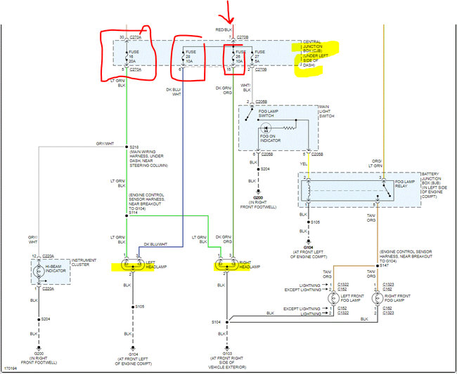

If I pull backwards on the turn signal lever, I can get the lights to come on. But normally the low beams or brights do no turn on. I have replaced the bulbs, I have checked all fuses labeled headlamp, I have replaced the headlight switch, and I still cannot get the headlights to come on.

If you get high beam when you pull on the multi-function switch lever, we have to start at the main switch.
I have attached two pics below. They are the wiring schematics for the vehicle. Note: I selected one without daytime driving lights (DRL). If you have DRL, let me know.

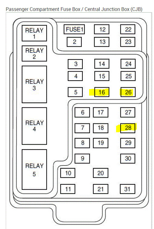

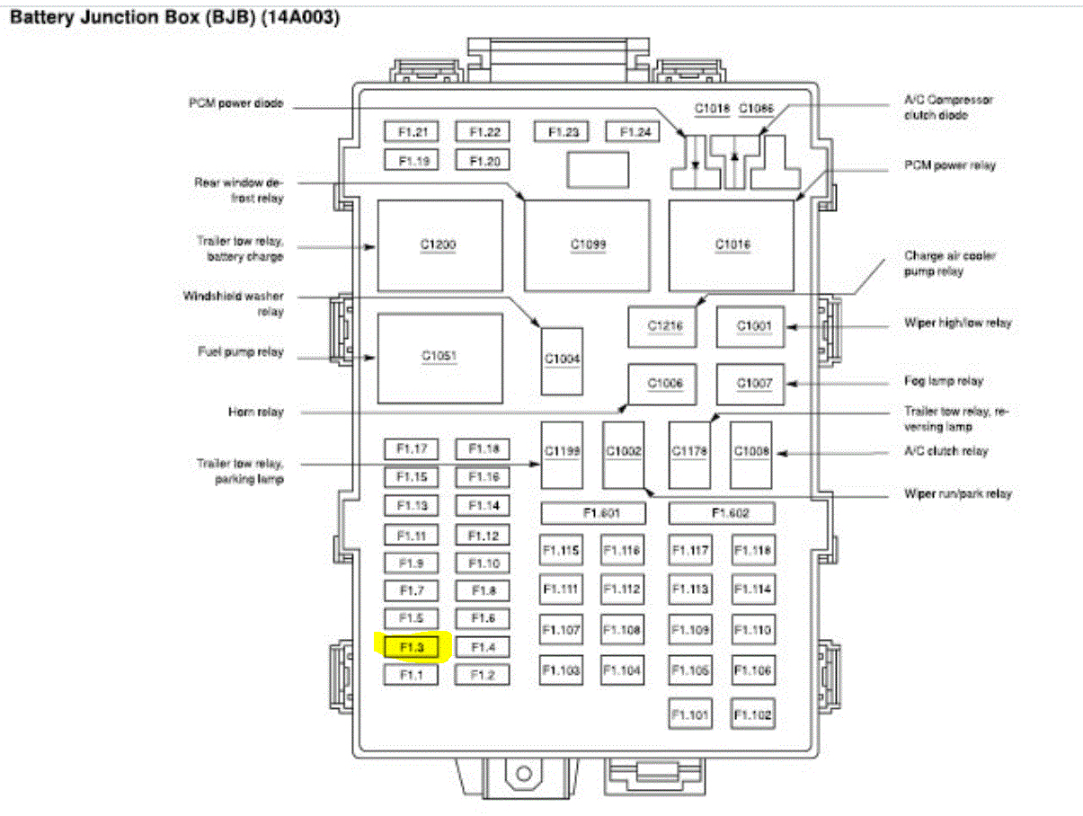

So, there are several fuses that need to be checked. In addition to checking the fuses, I need you to confirm there is power to and from them. Here is a link you may find helpful:
In the pics below, I circled the fuses. Some are under the hood and others are in the vehicle.

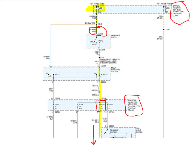

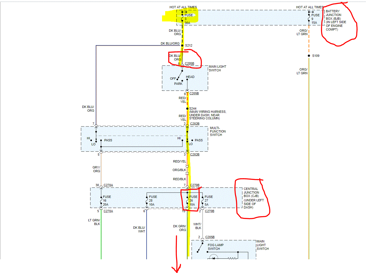

If all fuses are good, start at the main switch. In the connector will be a dark blue wire with an orange tracer. It should have 12v at all times.
If it does, check the red wire with the yellow tracer at the switch. It should get 12v when the headlamp switch is in the on position.

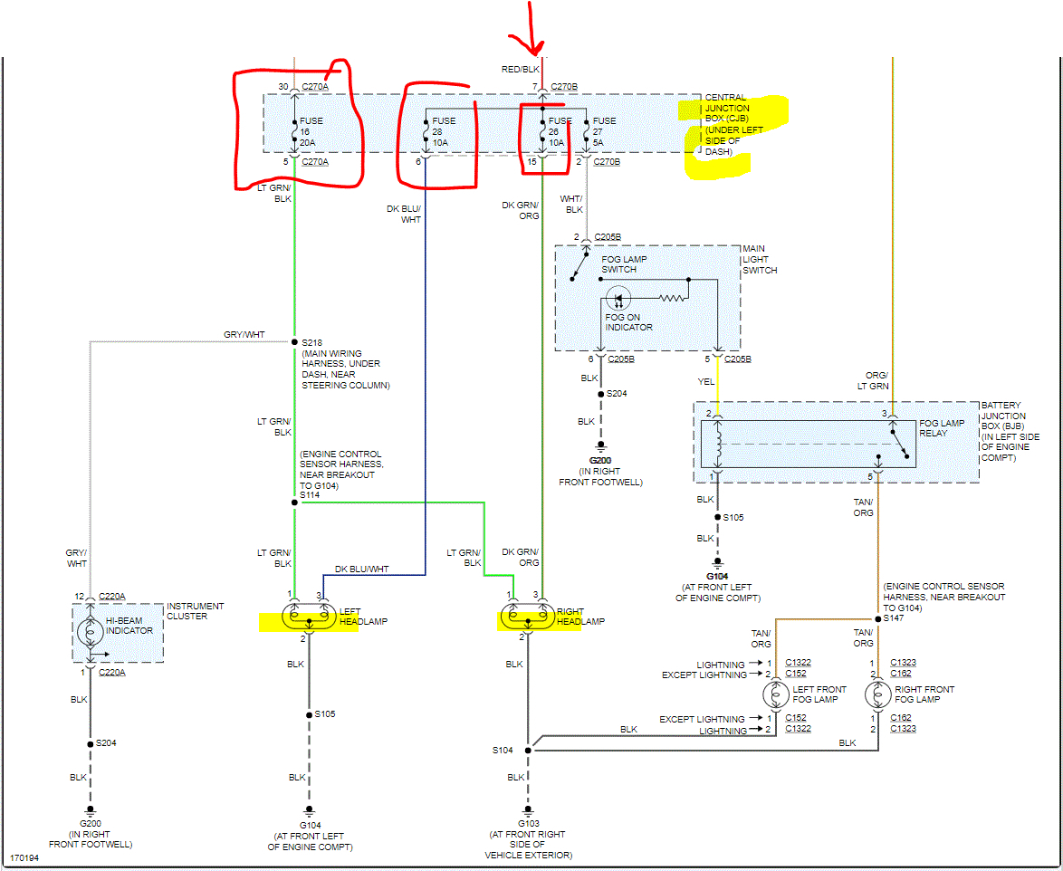

If it is good, check for power at the red/yellow wire at the multi-function switch. If power is there and out from the switch, confirm again there is power to the fuses in the central junction box under the dash. Note: Those fuses will only have power when the lights are turned on.
From that point, power is distributed to the lights. So if you have power the entire way to the fuses in the central junction box and out from it, then go to the headlamp sockets and check for power.
Since you get headlamps when you pull the multi-function switch, I suspect the problem is between the fuse box under the hood and the main headlamp switch. I realize the switch is new, so I'm questioning if the fuse is good and if there is power to the fuse in the underhood fuse box.
Pics 3 and 4 below are the fuses I need you to check. Pic 3 is the underhood fuse box and pic 4 is the one in the vehicle. Remember, in addition to checking the condition of the fuse, you need to confirm there is power to and from them.
I know this seems like a lot, but we need to know where power is lost. Normally, I work backwards from the headlamps back. I went the opposite way hoping it is one of the first things you check.
