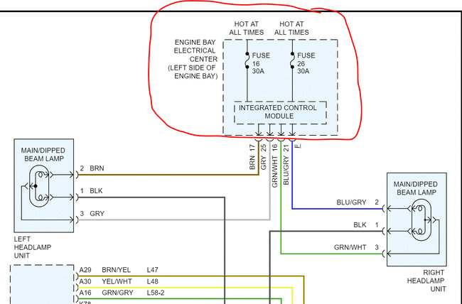

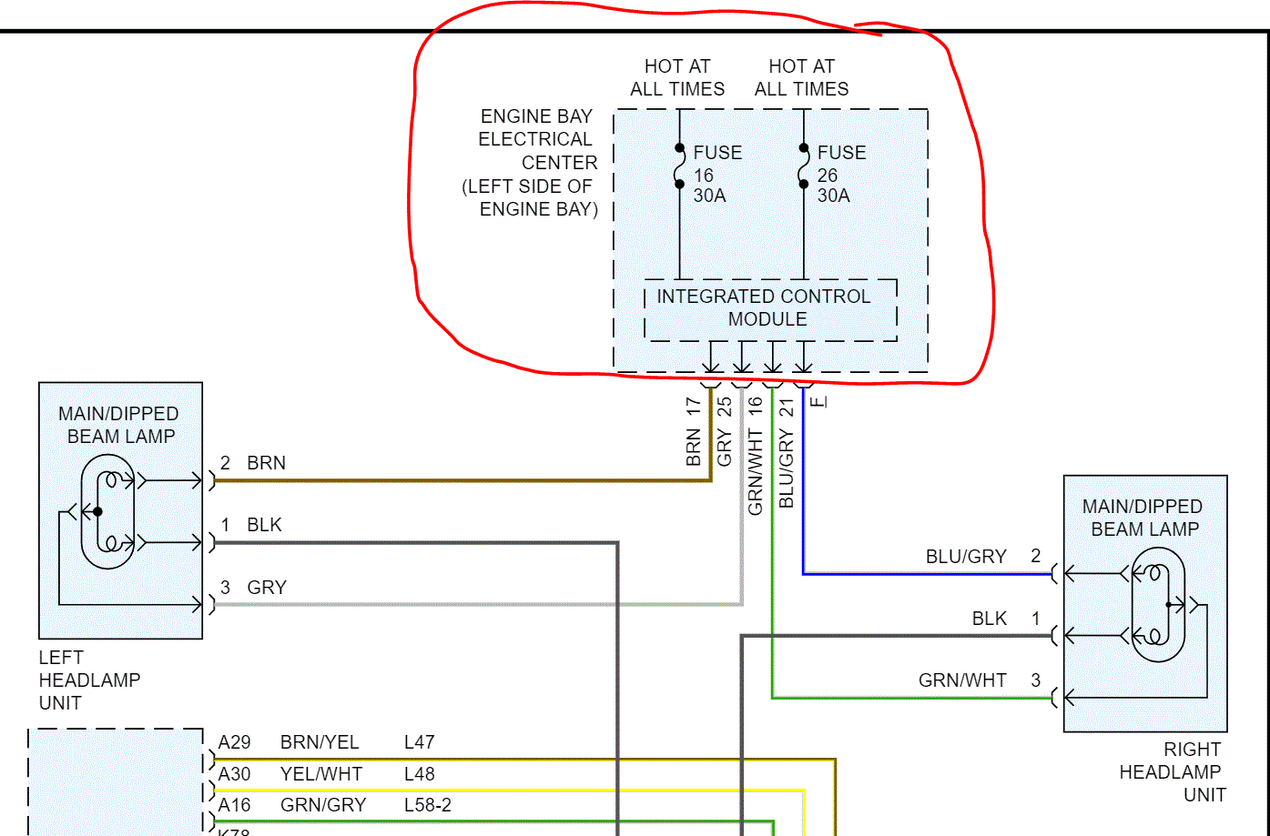

I hate to ask, but are you sure they aren't burned out? Also, have you checked both fuses in the power distribution box under the hood?
If you haven't checked the fuses, I attached a pic below from the wiring schematic which indicates the two needing checked. Do this first and let me know what you find.
Jun 9, 2020 at 11:51 PM
CERCOLANI
  • 9 POSTS
hi, yes I checked fuse 16 and 26 and they look okay.

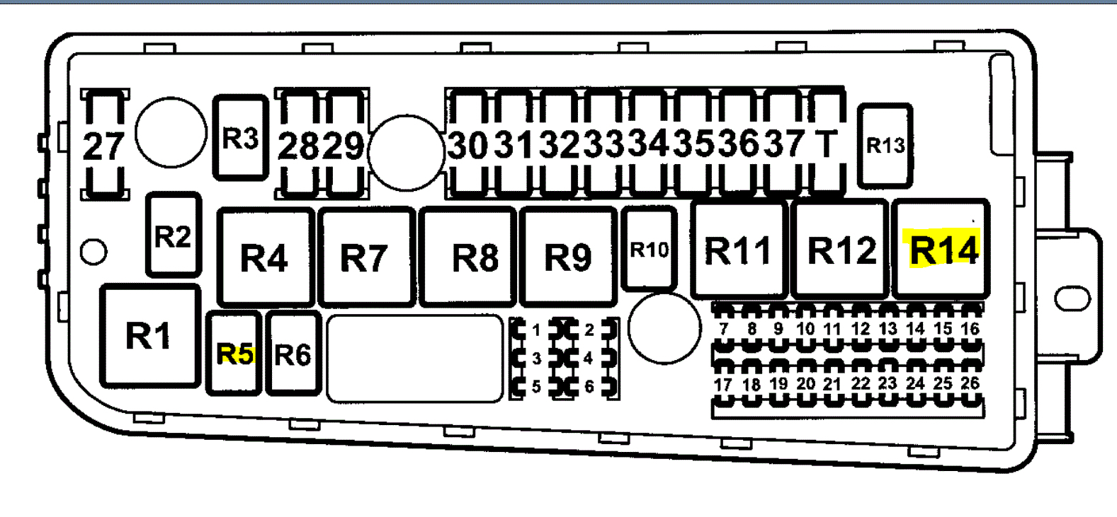

all the box fuses/relays that are in the fuse area under the hood and i saw that the orange one (boxed shaped fuse/relay ) may be the problem.
how to i check them?

No problem. I think you want to check the relay. The easiest thing to do is find another on in the box with the same part number and switch them. If there isn't one there, here is a link that explains how to do it:

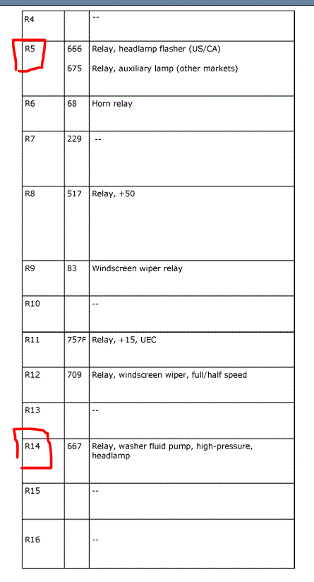

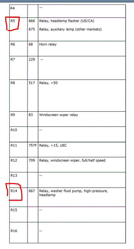

thank you Joe, is it possible to send me the relay identification diagram for a 2004 9-3 Saab?
i don't have the owner's manual and when i check online, i get the images for the layout of the relays, but not what specifically each relay is for.
Thank you again.
Jun 10, 2020 at 2:06 PM
  • 110,244 POSTS
I attached what I was able to find. Let me know if it helps. There are two relays indicated related to the headlamps, but they are extremely vague.
