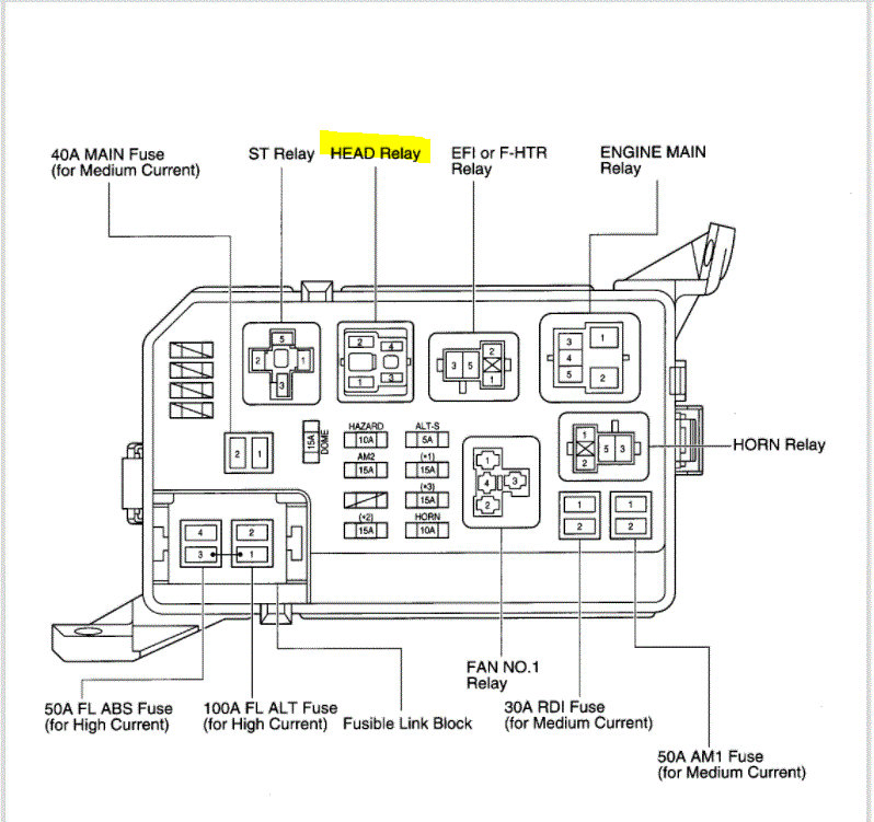

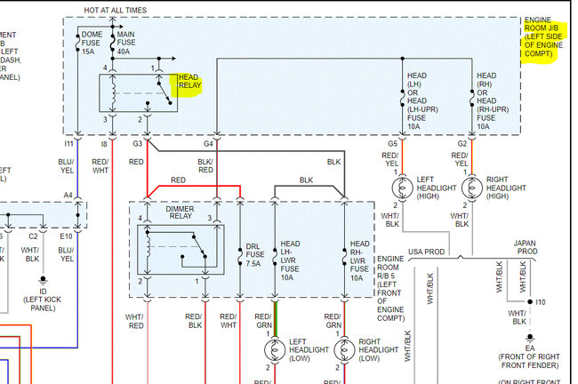

When I park and turn off my car, then turn off the headlights my corner lights will not turn off. The switch still clicks when I fully turn the lights off, I checked the fuses but they are all in tact. I tried to look at the relay but I’m not sure what a bad relay looks like.
Oct 23, 2020 at 10:52 AM
  • 110,251 POSTS
The headlamp relay is located under the hood in the relay/fuse box. What I would suggest is this. Check to see if there is another relay in the box that has the same part number and switch them to see if it makes a difference. Or, here is a link that explains how to test a relay:
I attached two pics below. One shows the relay as part of a wiring schematic and the other shows location.
