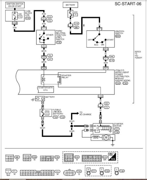

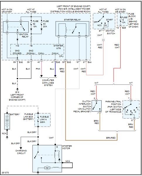

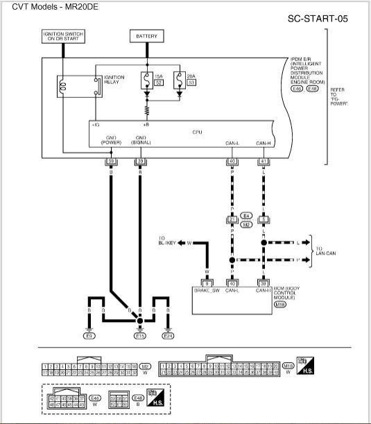

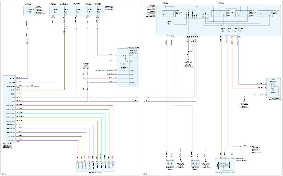

Hi Crystal,
It's a start going off the info I have so far give it a review, I'm sure you will have more questions on it just let me know and we will go through it.
I have put together the diagrams of both the starting and the headlight systems in your car, 2.0l the 2.5l should be the same for these systems. If you have a test light this will be of some help. Note one of the main grounds is located at the left kick panel area be sure to check that out.
Tom

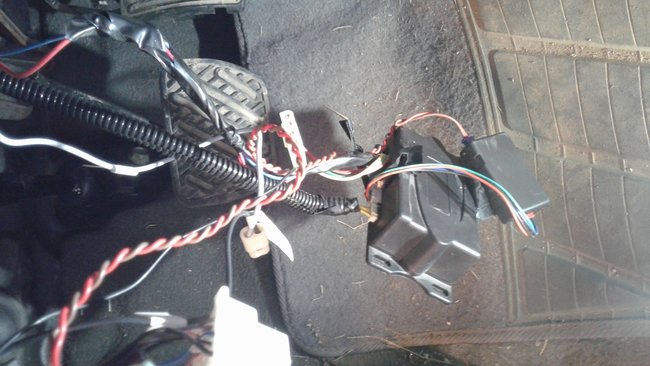

I tried to attach a couple of videos. I did the battery cable test again. Still no change. The wipers did come on by themselves for a couple seconds.

That first still shot doesn't look like OEM. Is that just because it just not mounted secure like the factory does it and it is original? We must be over looking something. The three main things that would cause this is would be; the the whole switch arm, low voltage or the CAN system.On newer cars even slightly low voltage will confuse the computer. The most common is the switch arm being the piece with all the daily movement. Were these problems occurring on your Mom? Knowing what happened the very first time the symptoms occurred is helpful too. My feeling is that it's the switch arm, getting to the plug connection of it with a test light you should be able to check its outputs using the diagrams posted earlier.

The cruise control, I stated at first it is after market that was installed by previous owner. Everything is a little dangling from me trying to check stuff.
