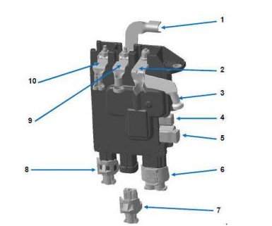

First get your mechanic to check fuse F7, 5A, on the side of the battery fuse box.
This fuse box is directly attached to the rear of the battery. Fuse F7 is usually covered by a small rubber cap.
See image below, check item 4+5.
Hope this helps.
Cheers, Boris

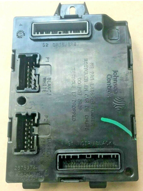

The headlights, wipers and charging are controlled by the Auxiliary Body Control Module, XBCM. The unit is located to the left of the clutch pedal.
See image below
This unit is not serviceable.
You could try and replace it with a secondhand unit but as it needs to be programmed to your vehicle it will have limited functionality, and the Stop/Start system will not work. A used module cannot be programmed again. But this will prove the old XBCM is faulty.
Cheers, Boris

BALLER1980
Hi Boris,
My auto electrician is looking to clone the xbcm? Is this possible?
Auto electrician has van now will be in touch once completed.
Thanks again.
