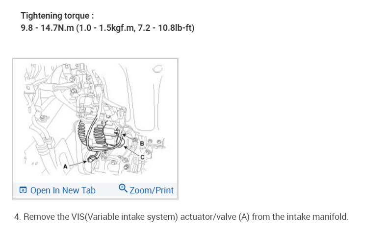

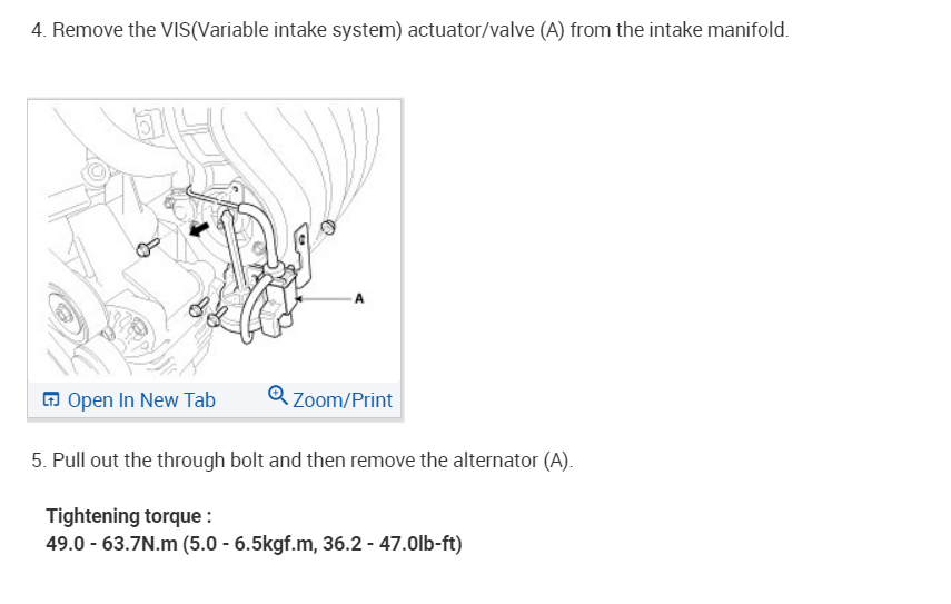

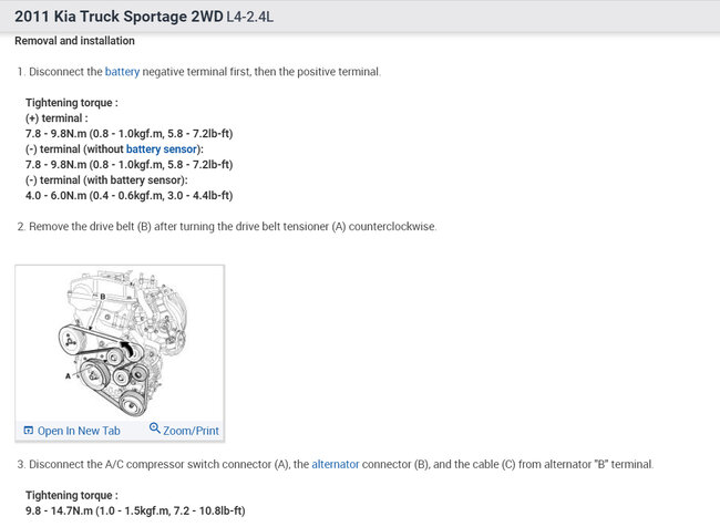

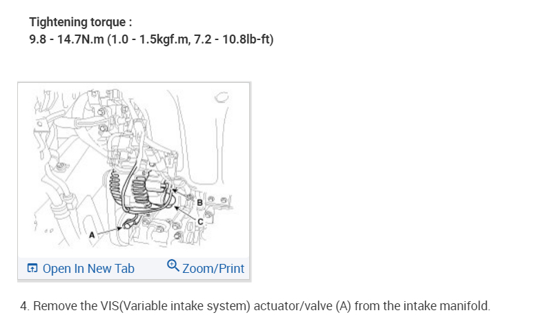

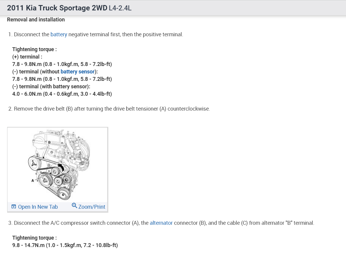

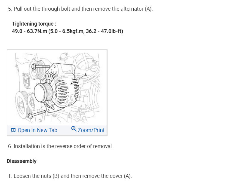

It sounds like the alternator is weak on recharging the system but to be sure here is a guide to help and I have included how to change the alternator out in the images below.
Check out the images (below). Please let us know if you need anything else to get the problem fixed.
