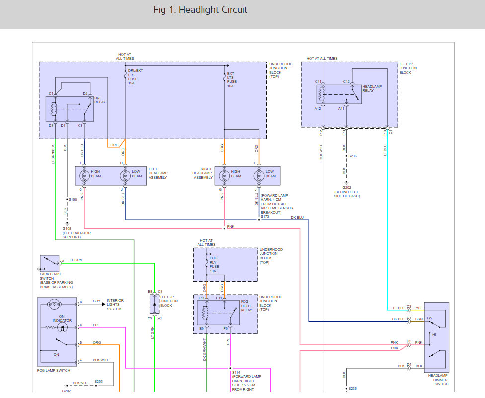

Headlights not working
65,000 MILES
JOHN O'REILLY
Only DRL working.
May 6, 2019 at 4:23 AM
  • 55,710 POSTS

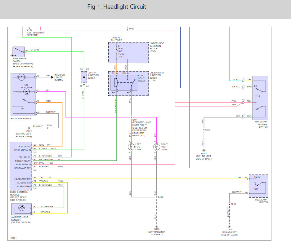

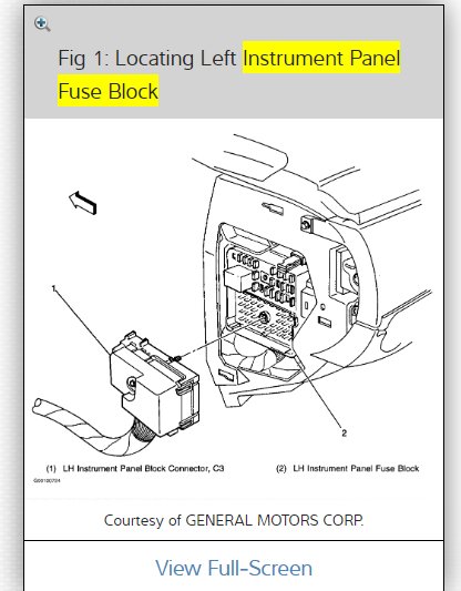

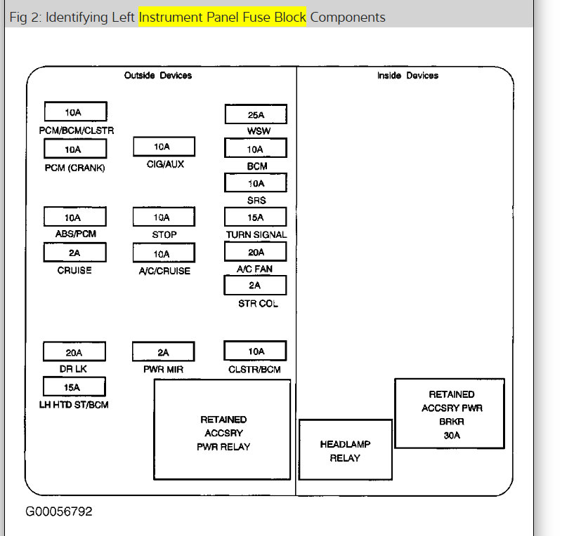

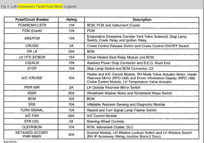

It sounds like the headlight relay went out. to be sure here is a guide to help you test the relay with the relay location below along with the headlight wiring diagrams so you can see how the system works:
