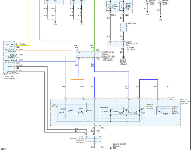

need a wiring color diagram for high and low beam headlights. please

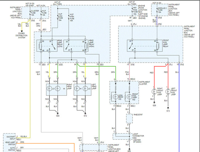

If you look at the pics below, I attached the entire wiring schematic for this vehicle without daytime driving lights. If you have daytime driving lights, I have to get a different schematic.
I had to cut the pic in half to make it readable, but I did overlap them so you can follow them easier.
