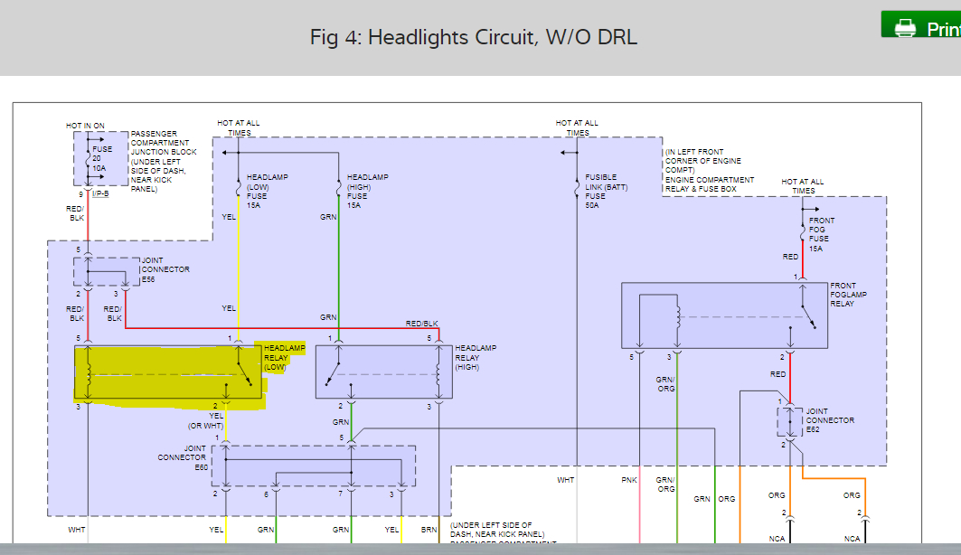

My high beams work on my car but not my regular lights. I have changed the fuse didn't work. I don't know what to do.
May 25, 2019 at 2:53 AM
SCGRANTURISMO
  • 4,897 POSTS

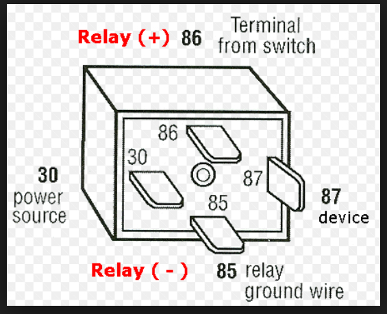

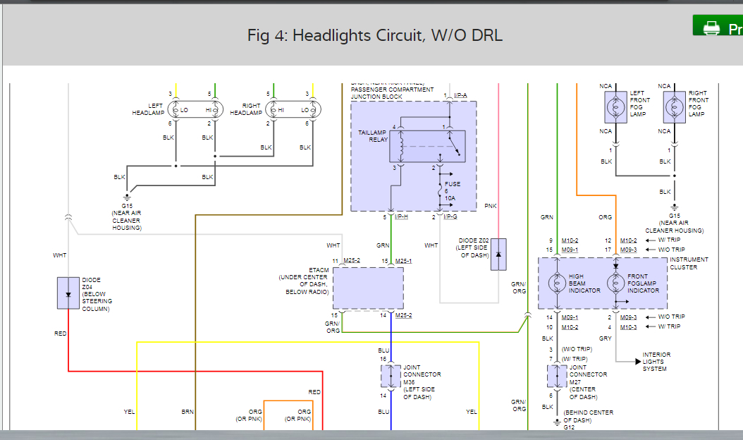

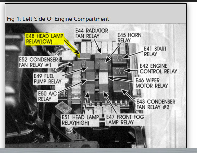

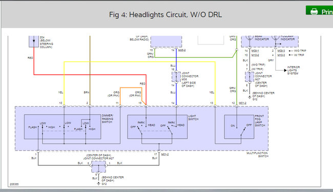

This could be a problem with your headlight relay (low) in the under hood relay box.I have included the headlight wiring diagram and the location of the headlight relay in the diagrams down below. I have also included a link down below for you to go to.
Please go through these guides and get back to us with what you find out.
