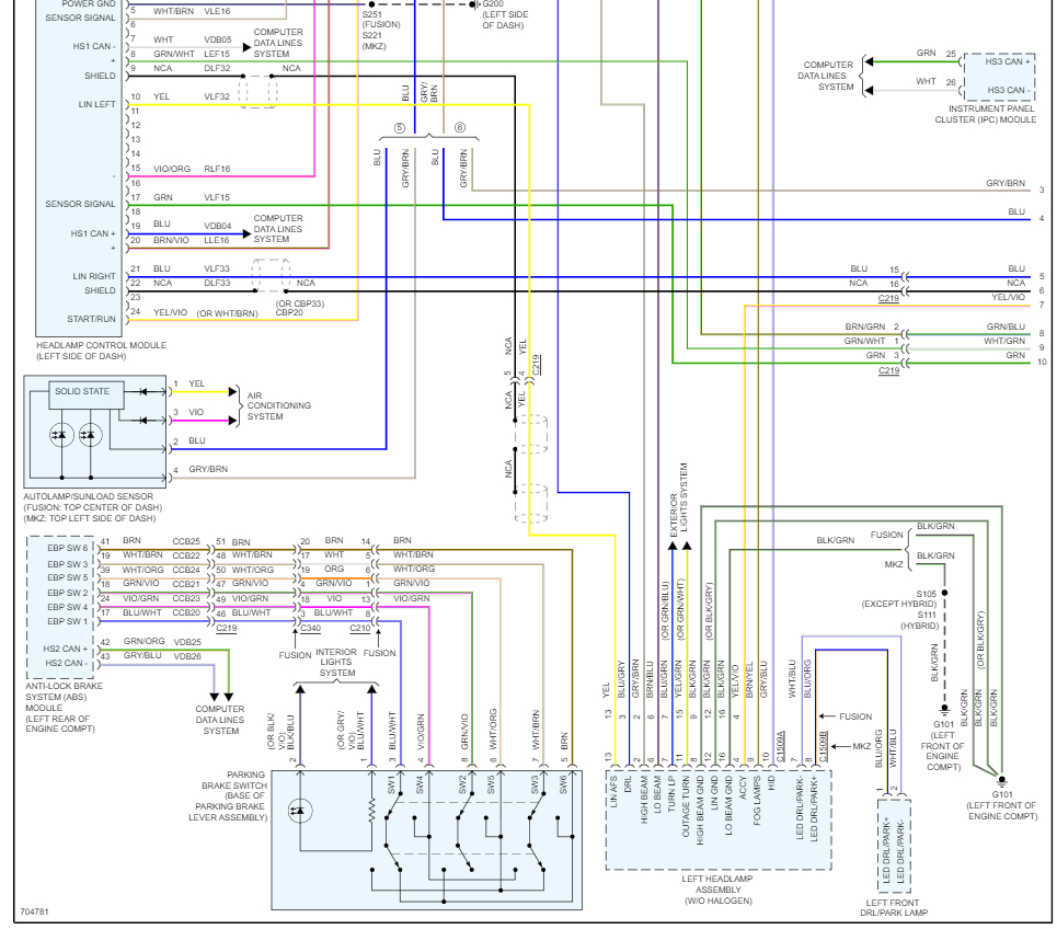

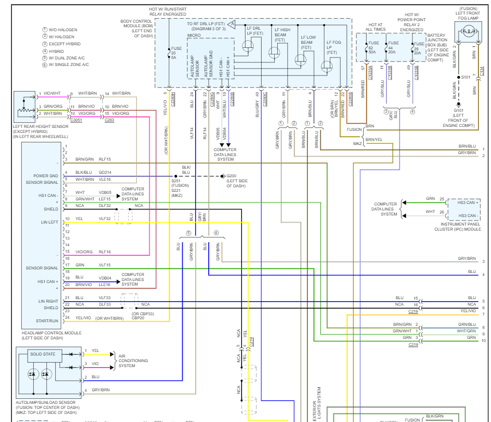

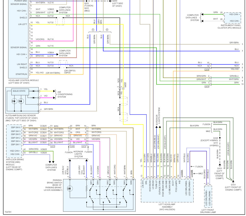

Bought replacement plugs for the low beam headlight and it was with red and black wire. I can't tell what color the old wires are to change it. Is there a wiring diagram for a 2020 headlights diagram?

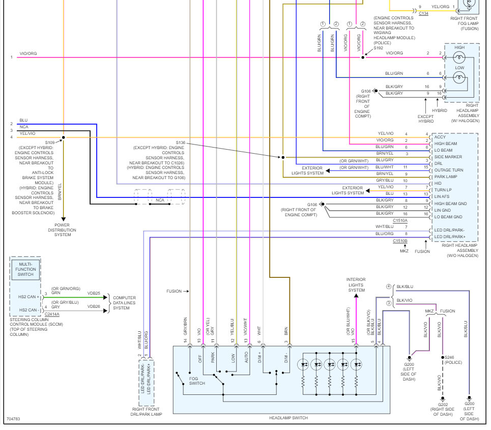

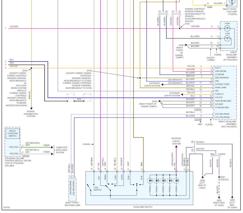

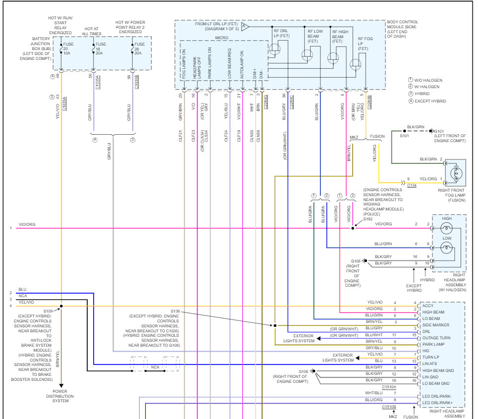

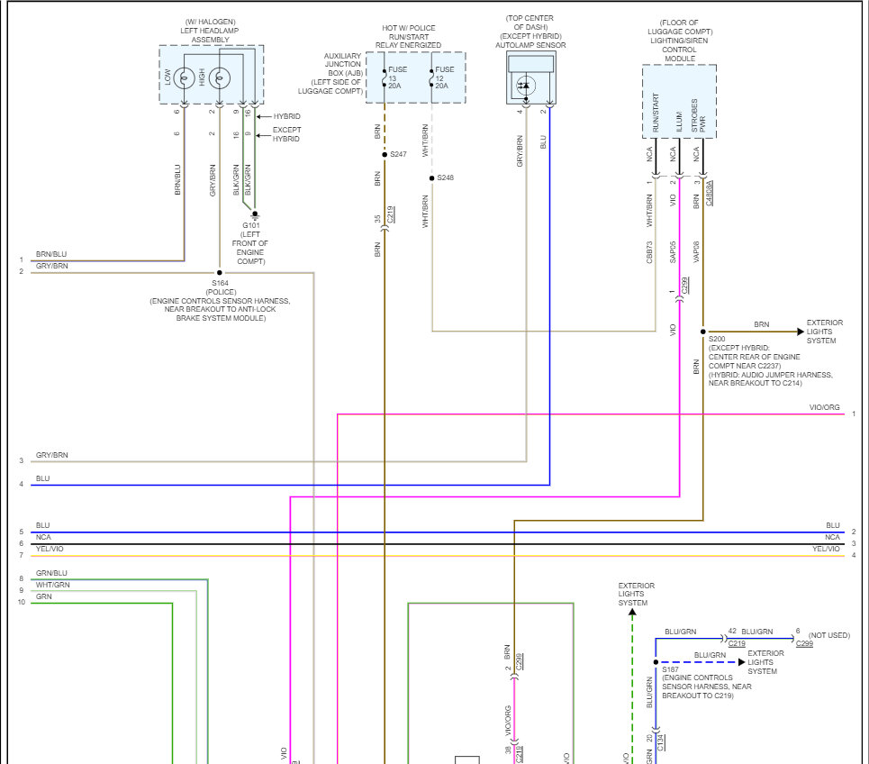

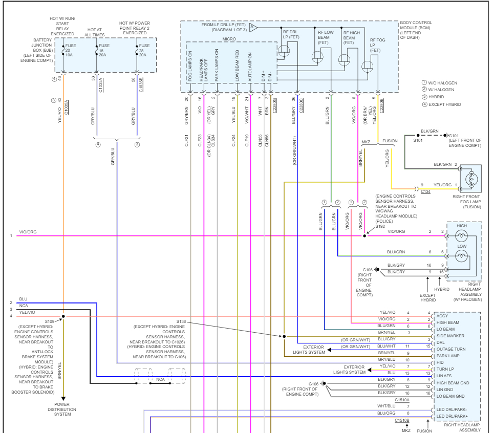

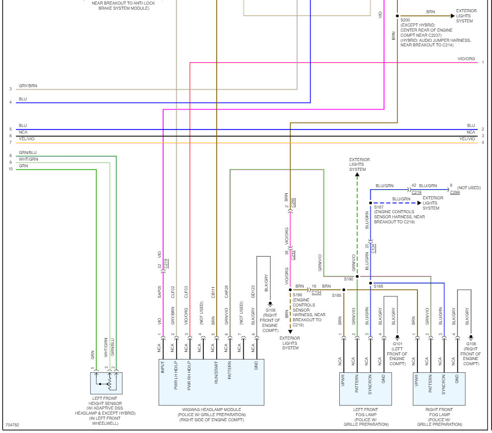

Sure, here are the headlight wiring diagrams so you can see how the system works and I have included a guide to help you test the wiring.
Check out the images (below). Please let us know if you need anything else to get the problem fixed.
