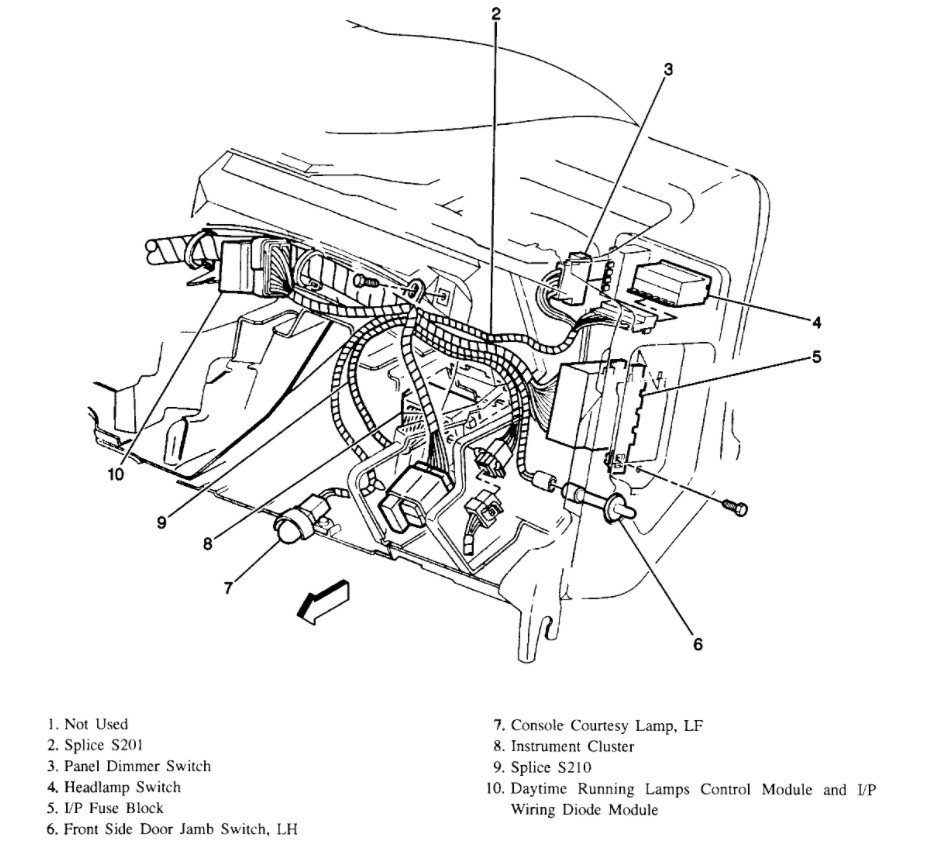

While I’m driving the lights go out and come back on.
May 18, 2021 at 12:43 AM
  • 55,433 POSTS

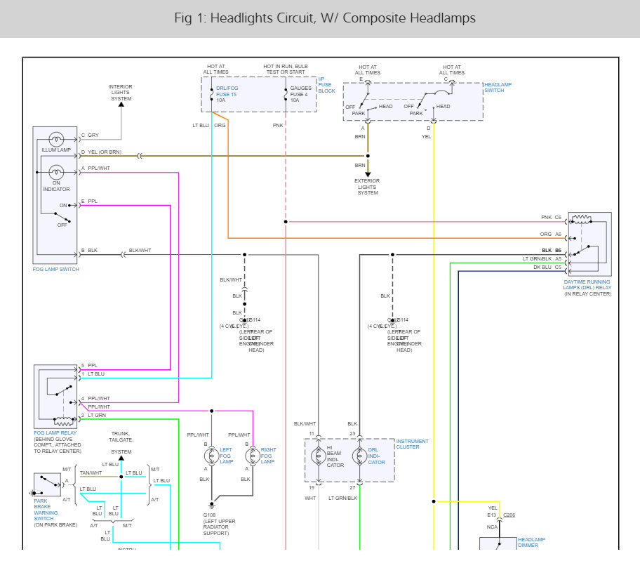

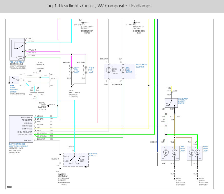

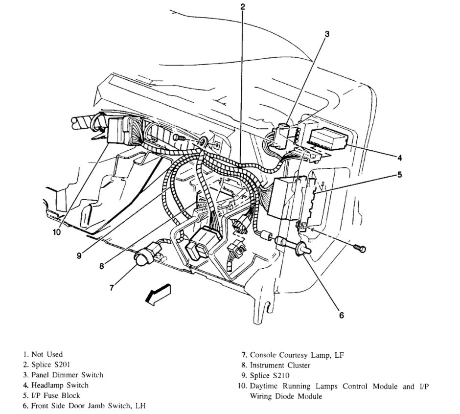

This is common when the DRL module is going out. here is the location so you can change it out with the headlight wiring diagrams so you can see how the system works:
