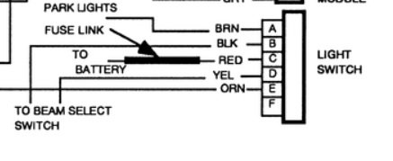

Which wire runs headlights on my switch?

Voltage to head light switch for headlamps should use a fusible link, then from headlamp switch the voltage goes to dimmer switch, hi and lo beam. The head lamp switch may have an internal circuit breaker.
I hope the image is correct as far as wire color.
