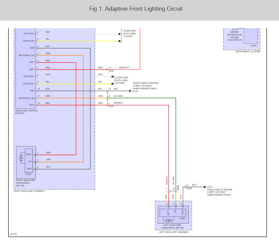

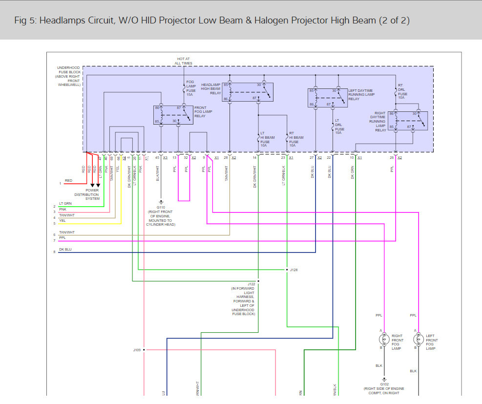

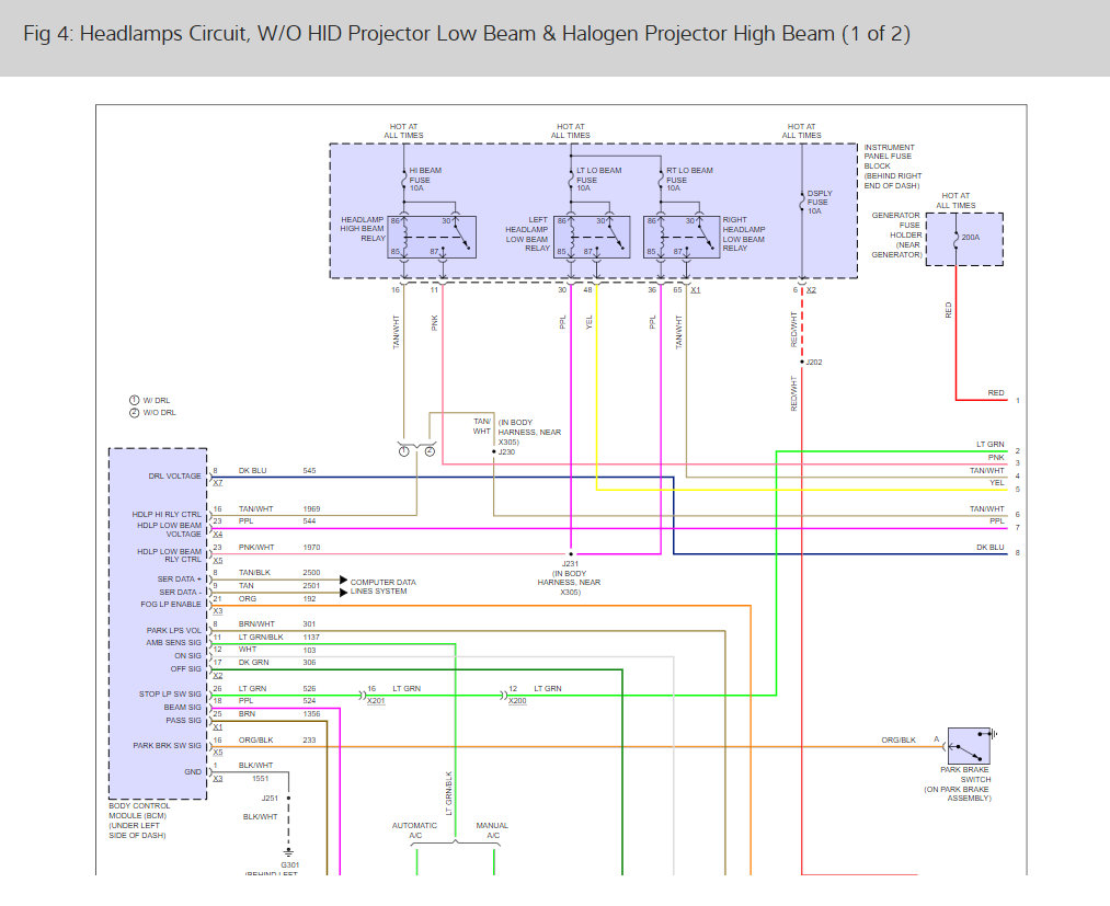

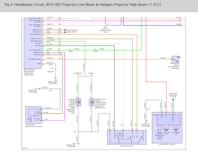

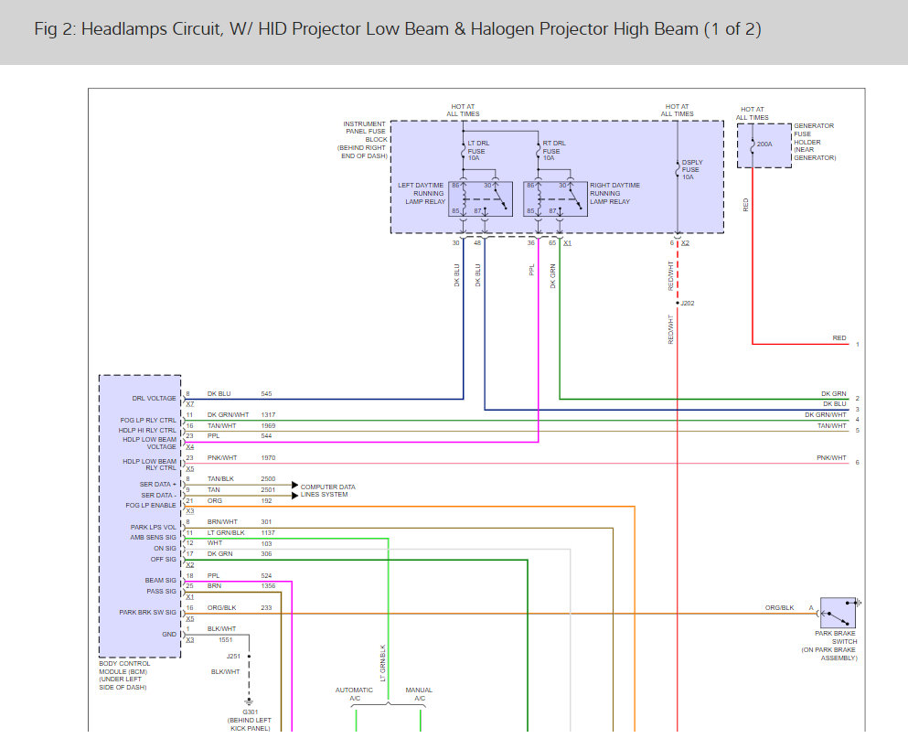

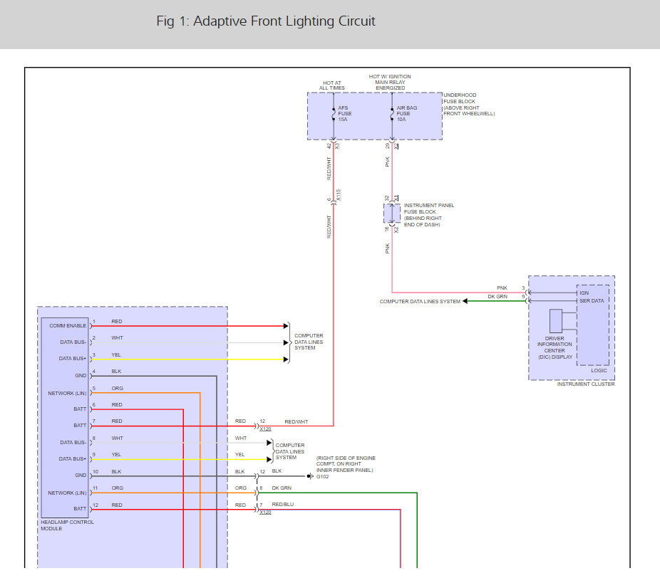

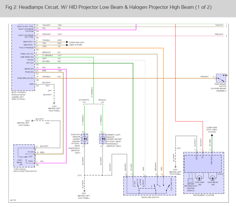

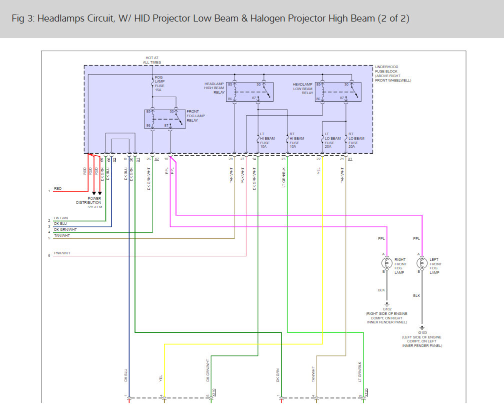

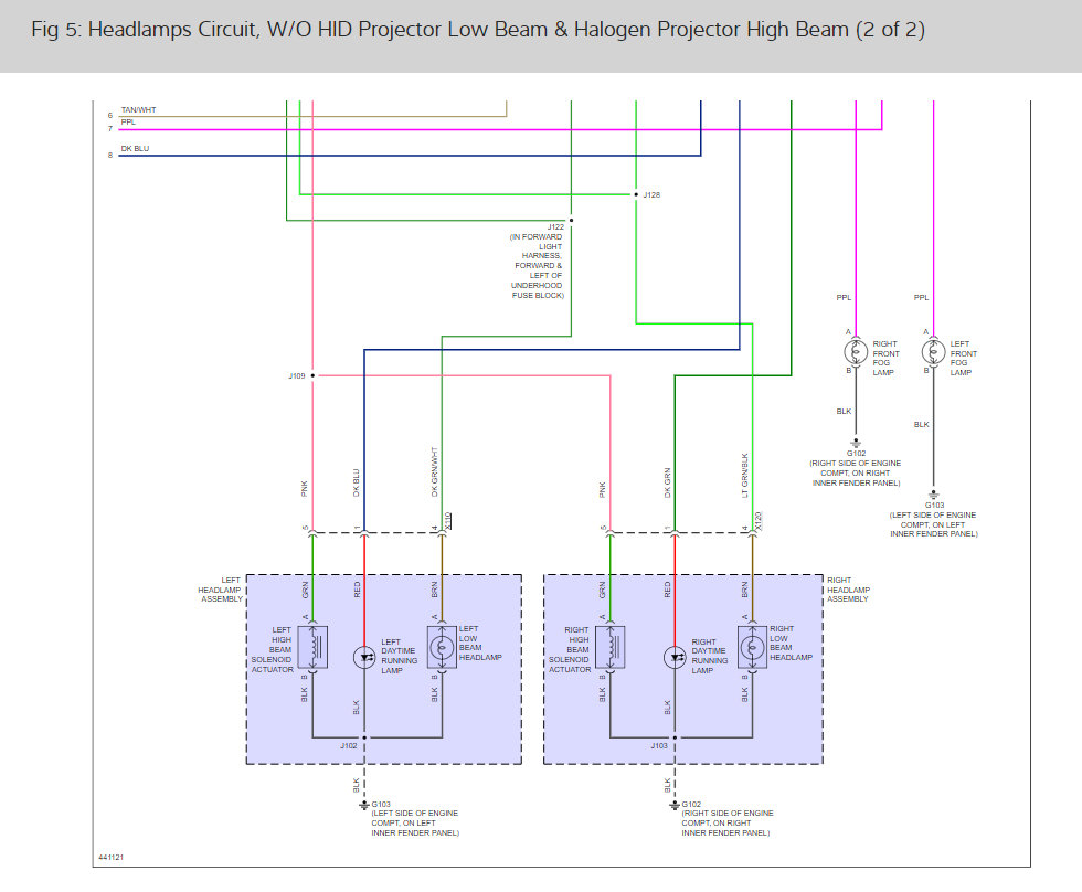

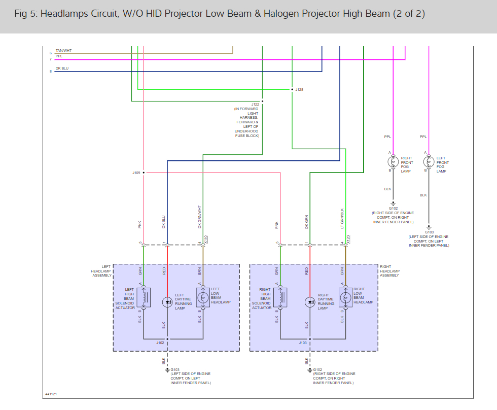

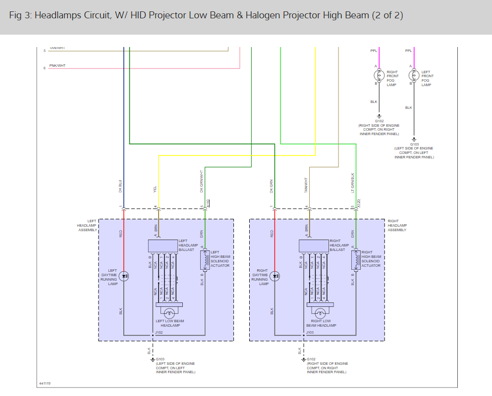

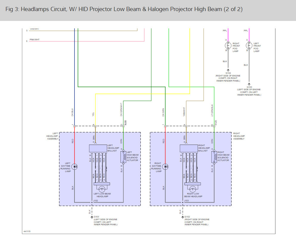

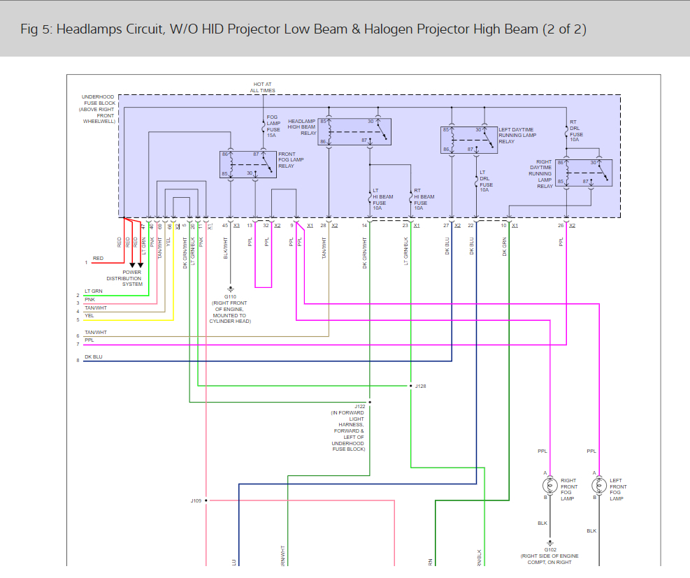

I want to change headlights from HID back to OEM
2015 GMC ACADIA
80,000 MILES • 6 CYL • AUTOMATIC
KEN STANKIEWICZ
I have the vehicle listed above SLT model with 9012 bulbs. I wish to change them back to original HID light bulbs D3 S. how much work would it be to change them? Do I have to change the wiring or use the wiring that's there?
Mar 4, 2019 at 12:42 AM
  • 55,412 POSTS
It looks like it might be a little involved to change it over but not anything we can't handle. Here are the headlight wiring diagrams (below) so you can see how the system works and a guide to help you test the connections.
