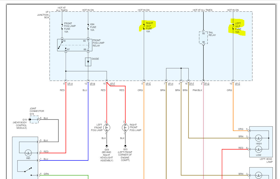

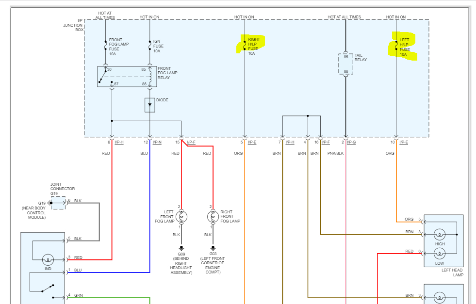

Where is the headlight relay located?
2006 KIA RIO
186,000 MILES • 4 CYL • 2WD • AUTOMATIC
SILENTHILLDALE
  • 17 POSTS
Headlights.
Nov 5, 2022 at 8:25 PM
  • 110,236 POSTS
I checked through wiring schematics for vehicles with and without daytime running lights. Neither one has a headlamp relay.
On the other hand, both have a tail lamp relay and a fog lamp relay. Also, each headlamp has a separate fuse. See pic below.
Let me know what is happening or what I can do to help.
See pic below.
