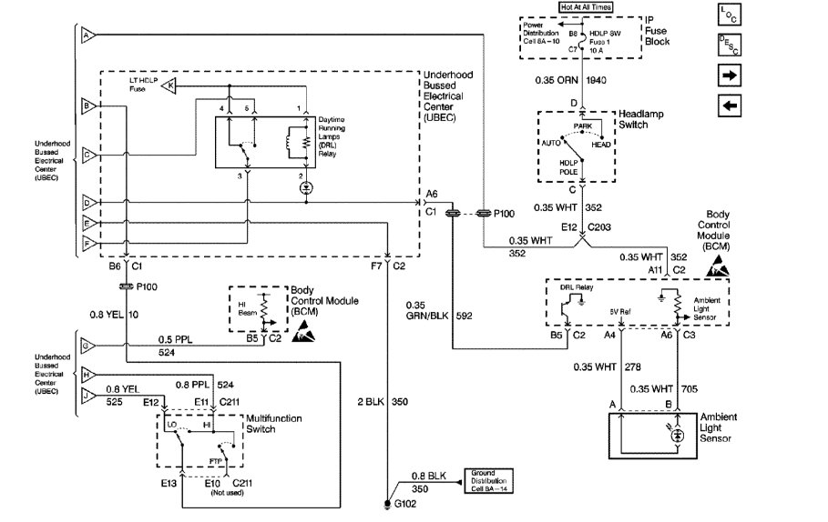

My DRL's work but when i turn headlight switch low beams do not come on switch to high beams one is bright other is dim.

Both bulbs are good and grounds are good the right side is working correctly on high beam but the bulbs disconnected on left side both have power but low voltage.
Mar 17, 2018 at 4:33 AM
Okay, what is the voltage?
Mar 17, 2018 at 4:35 AM
JASON TEEGARDEN
  • 11 POSTS
Eight volts on both.
Mar 17, 2018 at 4:36 AM

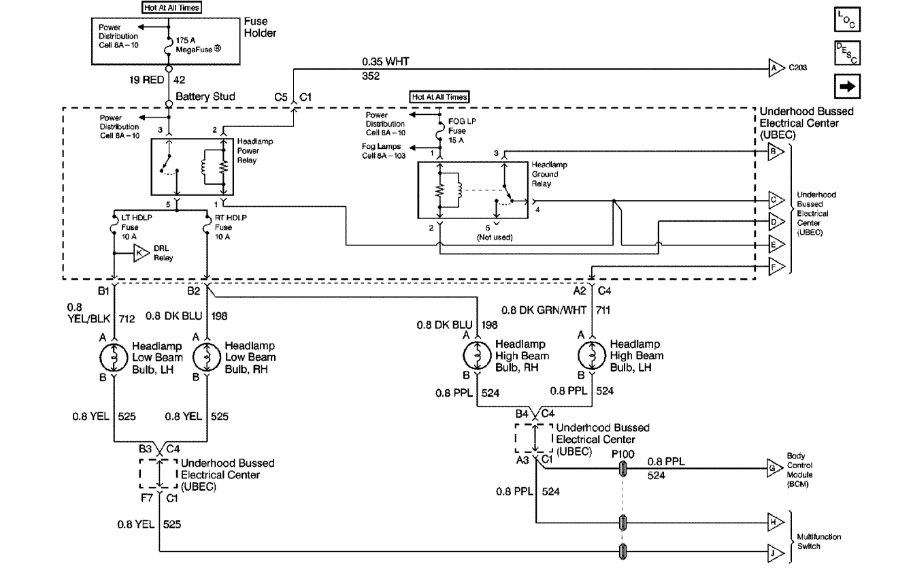

Diagram for lights. There is a power and ground relay. Check them both for clean tight connections.
Mar 17, 2018 at 4:39 AM
Eight volts is a problem.
Make sure you have good battery voltage. if it is okay, look at all your connections.
You need battery voltage at the headlights. Check the power relay in the diagram I sent you.

Okay, you still need to check the power relay to see if the correct voltage is present.

Terminal three is the load side and should have twelve volts all the time. terminal two should have twelve volts with the headlights on. terminal one is the ground for the relay to operate the headlights.

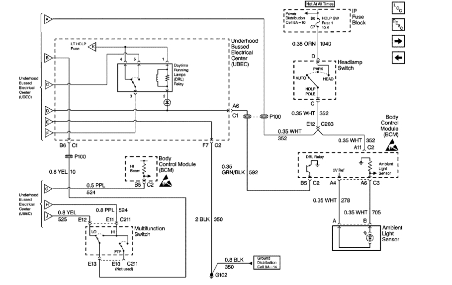

Does the body control module effect this in anyway?
Mar 17, 2018 at 5:05 AM
Yes it does, but not even there yet.

Okay, i covered the DRL sensor on dash and the low beam lights are on all the time and will not go off.
Mar 17, 2018 at 5:20 AM
JASON TEEGARDEN
  • 11 POSTS
Right working correctly l/s both connectors have power.
Mar 17, 2018 at 5:21 AM
That is controlled by the BCM. I attached a diagram.
Do all the lights work normally with the sensor covered?
Mar 17, 2018 at 5:28 AM
JASON TEEGARDEN
  • 11 POSTS
No only the DRL' were working. no low beam and high beam was working only on r/s l/s both were trying to work very dim.

Okay, i have twelve volts on three terminals of headlamp power relay.
Mar 17, 2018 at 6:17 AM
Okay, let me check.
Mar 17, 2018 at 8:47 AM
Okay, the power relay is working the ground is not. the grounds go to the DRL relay and then off to the BCM.
Do you have a scan tool that can access the body control module and turn the lights on and off?
