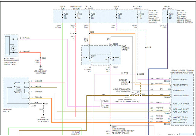

Headlights goes out while driving at night. Found fuse blown. Change fuse it did the same thing while driving.it is # 9 fuse in the fuse box. I change lCM 2 years ago by the dealer.it was recall. By the way headlights goes out night or day while driving. What could be the problem?
Apr 10, 2021 at 5:39 AM
  • 110,240 POSTS
When the lights go out, is the fuse always blown? If it is, how long does it take for that to happen?
If it happens quickly, chances are there is a short near the headlamps. What I would start with would simply be checking the plug where the wiring connects to the headlamps.

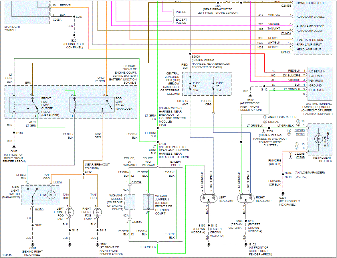

If you look at the two pics below, I included the entire wiring schematic for the headlamp system and DRL. Are you certain that it is fuse 9? I'm seeing a fuse 6 that powers the lighting control module.
If you check the wiring, here is a link you may find helpful:
I have one last question. I just want to confirm this vehicle has daytime running lights. You indicated the problem happens during the day, so I made the assumption. The wiring is for a system with DRL.

When the headlights goes out #9 fuse is always blown.i drive from 1 to 10 miles with lights on then the fuse is blown.wires to headlamps okay.#6 fuse is okay.i do not have DRL.i do not know how to read wiring diagrams. Do you think it could in the light switch?

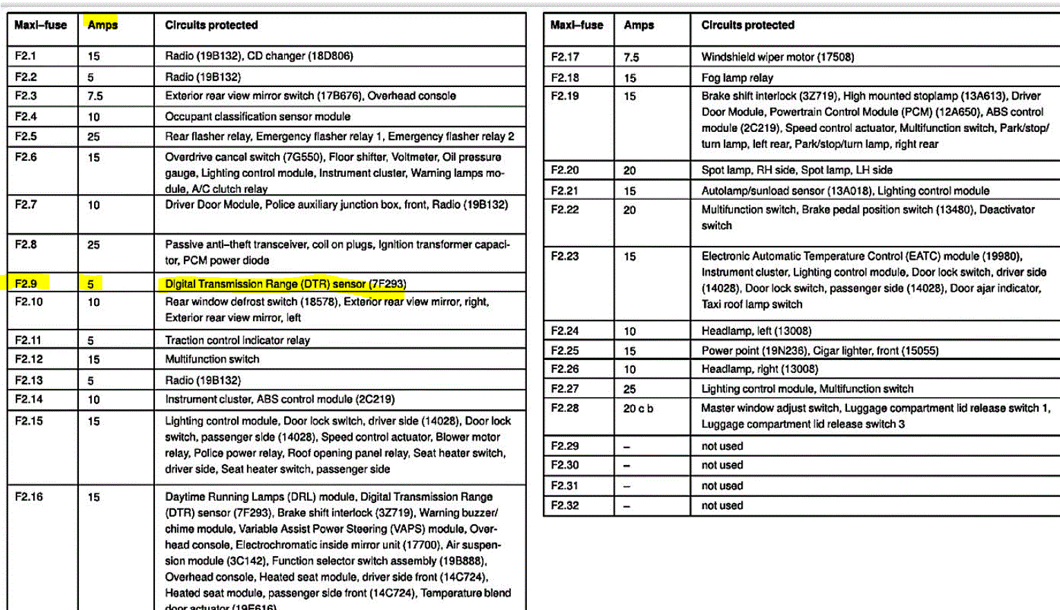

I put headlights on when the change gears that when the fuse is blown. I maybe reading the fuse box diagram wrong for #9 fuse. I know it is 25 amp.
Apr 11, 2021 at 7:06 AM
  • 110,240 POSTS

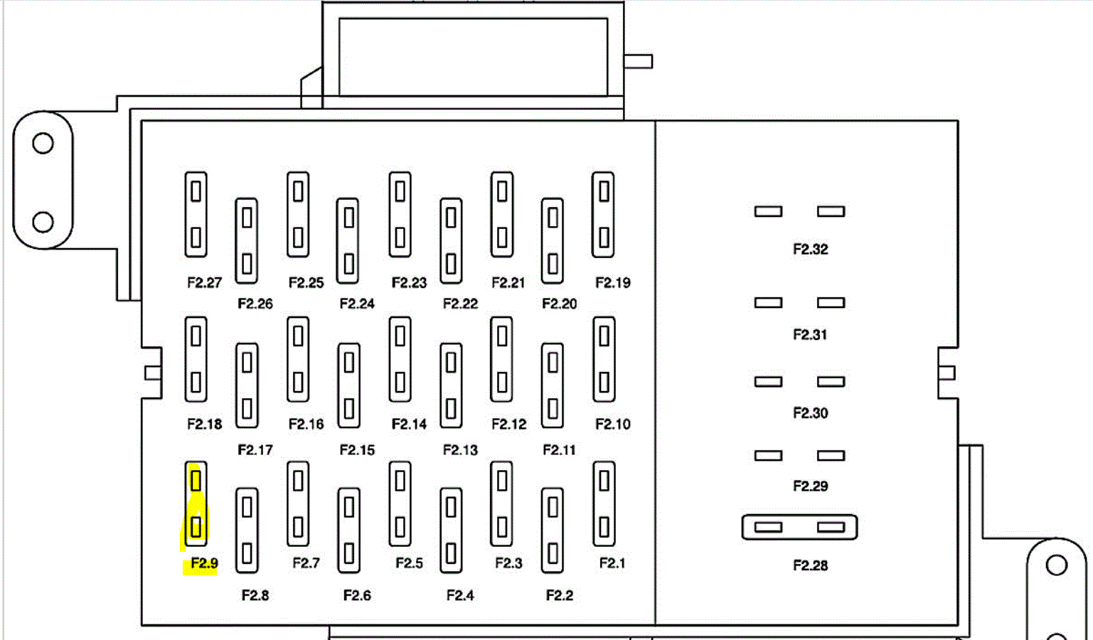

ICM stands for ignition control module, so that isn't related. I have to be honest, fuse 9 is a 5 amp fuse for the transmission range sensor. Again, that isn't related.
Where is the fuse that blows? Is it under the dash on the driver's side?
If you look at the two pics below, that is what I am seeing in the manual. Pic 1 is the fuse box under the dash. I highlighted fuse 9. Pic 2 is the legend that indicates that the fuse is for the transmission range sensor.
If you don't turn the lights on, does fuse 9 still blow?
The idea that it blows when you shift gears leads me to believe it could be related to the backup lights. Do they work after the fuse blows?

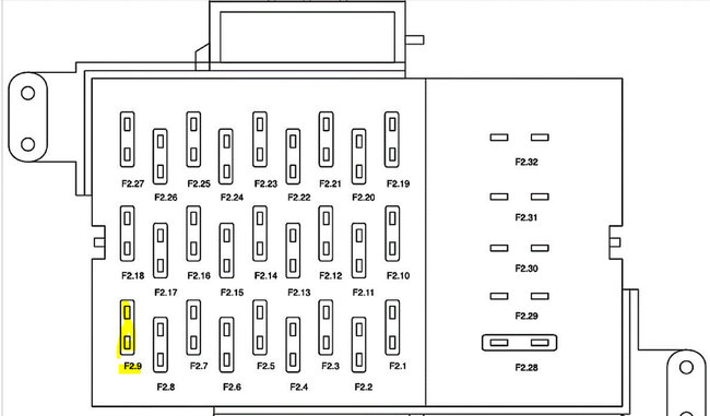

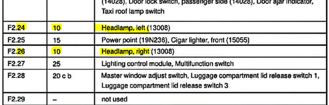

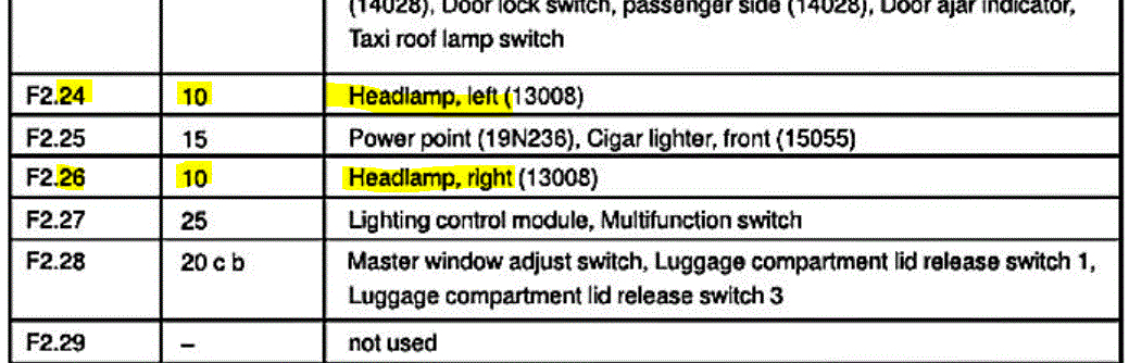

Also, do both headlamps go out at the same time? Each headlamp assembly (left and right) has its own fuse. See pic 3
Double-check the fuse location and number. We are missing something. Also, see if the backup lights work if the fuse blows.

i made mistake looking at the fuse. It is #27 fuse. Top left of the fuse box.the headlights goes out the same time.the backup lights work when the fuse is blown.i put the car in drive when car start to roll that is when the fuse blow.
Apr 12, 2021 at 6:39 AM
  • 110,240 POSTS
That makes more sense. That fuse powers the lighting module (multi-function control module). This makes us have to go in a different direction. Keep in mind, there has to be a short at some point. Since it doesn't blow until you place it in gear, it doesn't sound like it is between the fuse and module, but rather, after. Are you certain this vehicle doesn't have daytime running lights? They would come on automatically day or night. There could be a short at one of the light sockets.

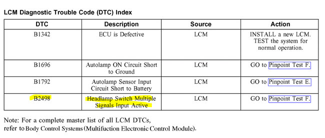

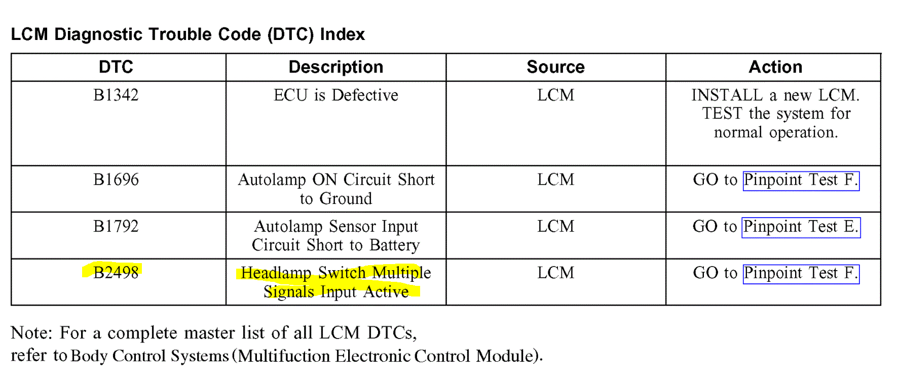

Hello, I scanned the system with the can-bus. I got dtc b2498. Where do i go from here?
Apr 13, 2021 at 8:58 AM
  • 110,240 POSTS

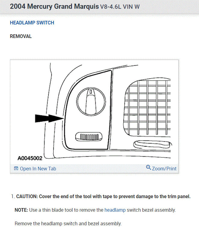

Based on that code, I suspect the switch is bad. See pic 1 below. It indicates there are multiple inputs are active at the same time.
I attached a pic below showing the definition of the code. See pic 1.

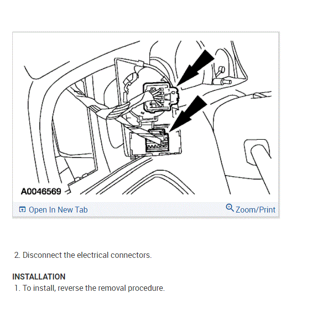

If you decide to replace the switch, pics 2 and 3 provide the directions and pics specific to your vehicle.
If you remove the switch, make sure to inspect the wiring to it as well as the condition of the plugs.

Hello, the headlight switch worked. headlight okay . Thank you for the good information.
