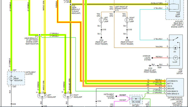

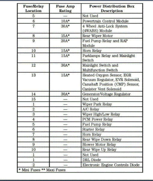

First the low beams went out and the high beams are only work when you hold down the high beam. now they don't work at all, just a side lamp and the blinkers. what can it be?
Aug 13, 2020 at 11:09 AM
Good morning,

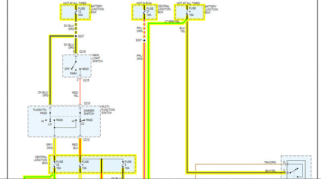

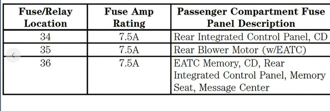

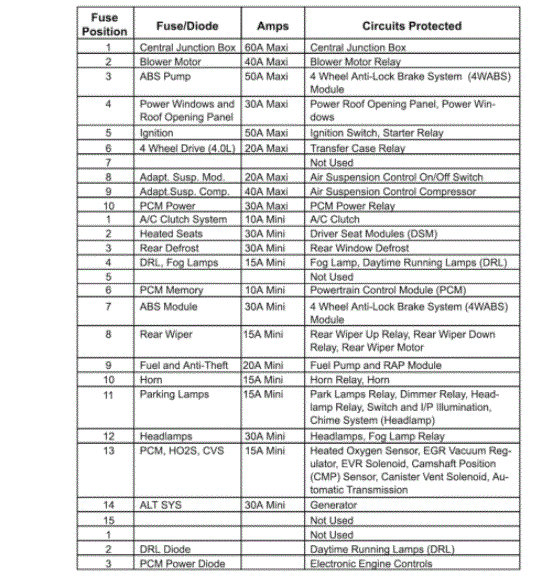

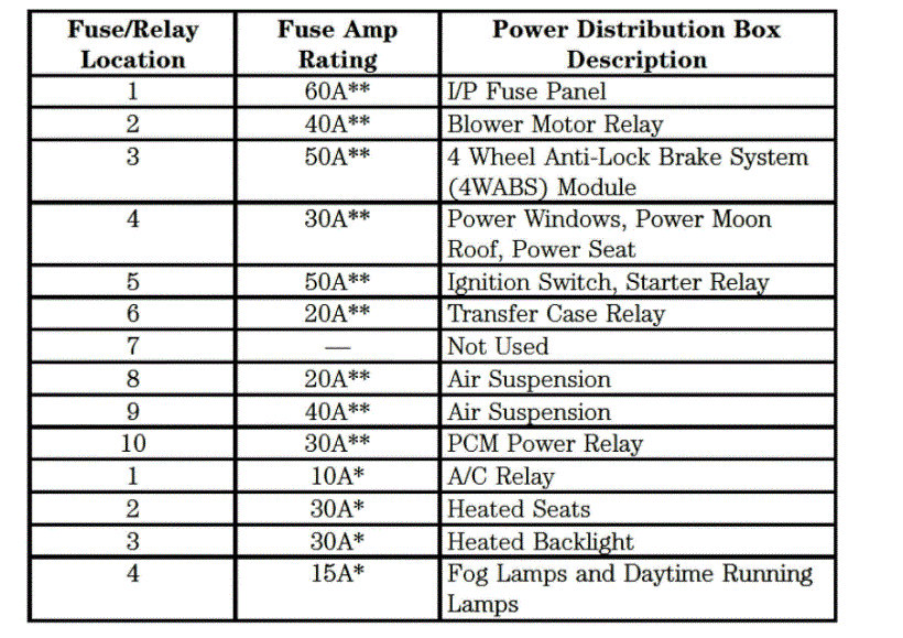

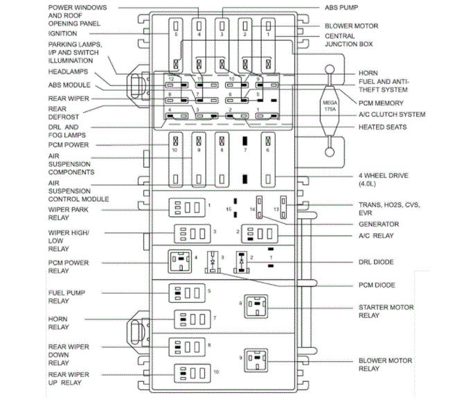

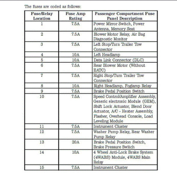

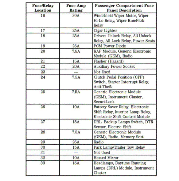

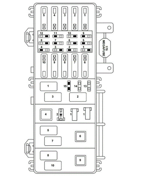

I attached a diagram for you of the system. There are 6 fuses for the circuit that need to be tested. This is not a visual test but a power test for voltage at the fuses.
Please review the diagram and check the listed fuses.

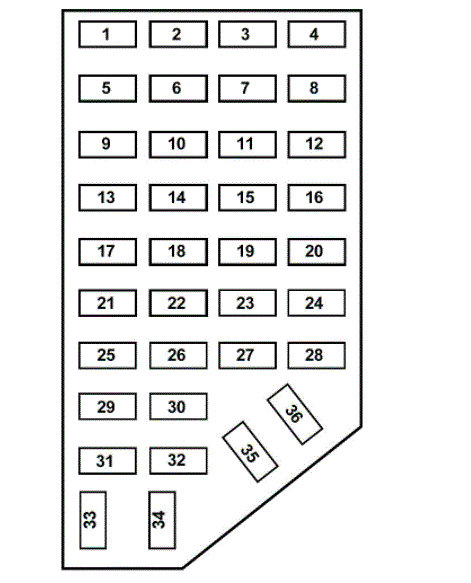

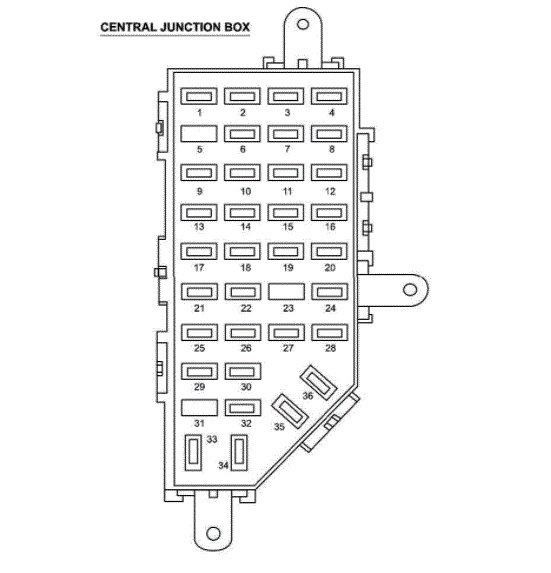

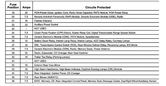

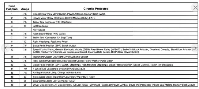

I attached the fuse box and the legends for the fuses so you can see the locations of the fuses needed to be tested.
