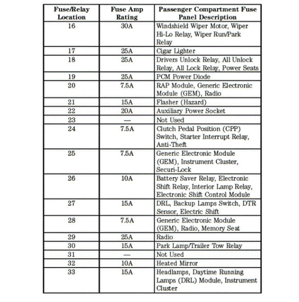

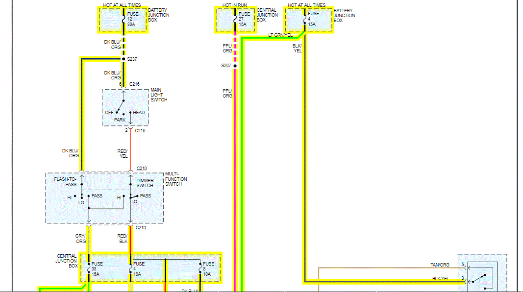

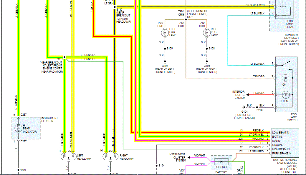

First the low beams went out and the high beams are only work when you hold down the high beam. Now they don't work at all, just a side lamp and the blinkers. What can it be?
Thursday, August 13th, 2020 AT 6:09 PM
  • 52,797 POSTS
Good morning,

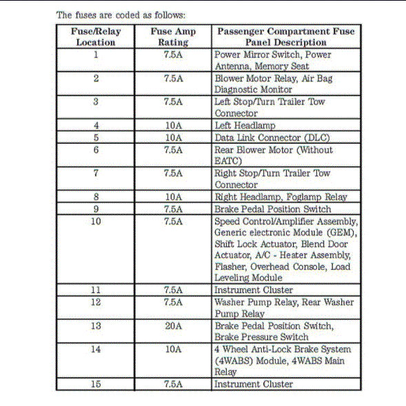

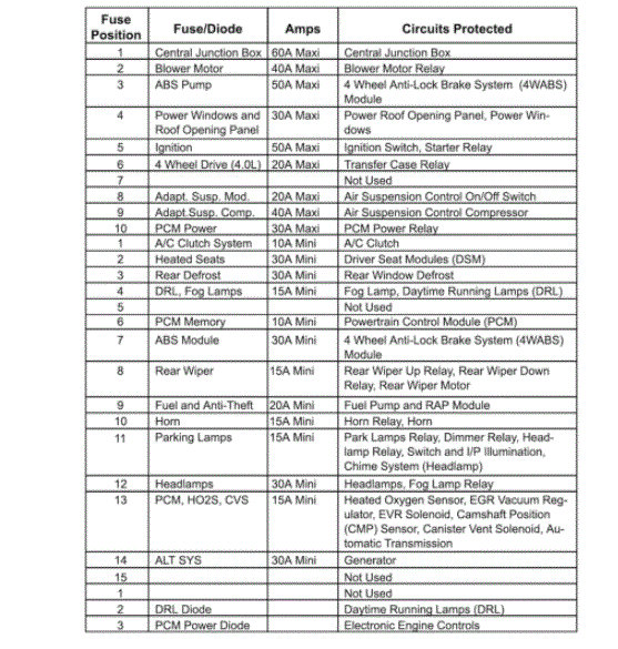

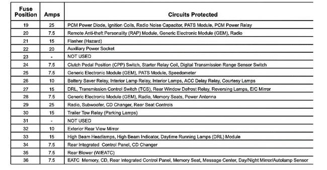

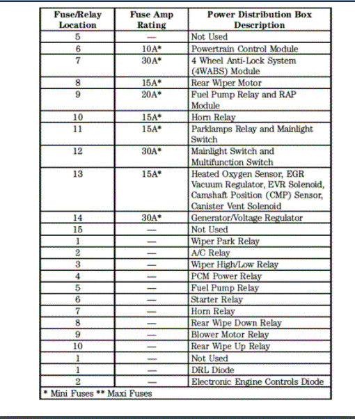

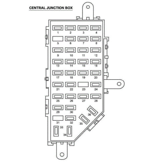

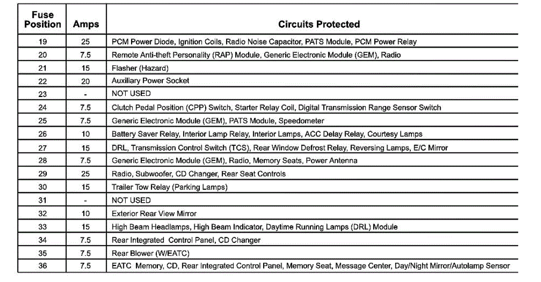

I attached a diagram for you of the system. There are 6 fuses for the circuit that need to be tested. This is not a visual test but a power test for voltage at the fuses.
Please review the diagram and check the listed fuses.

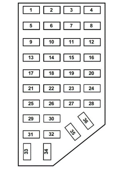

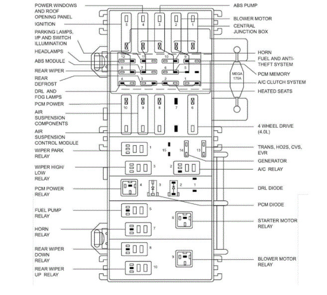

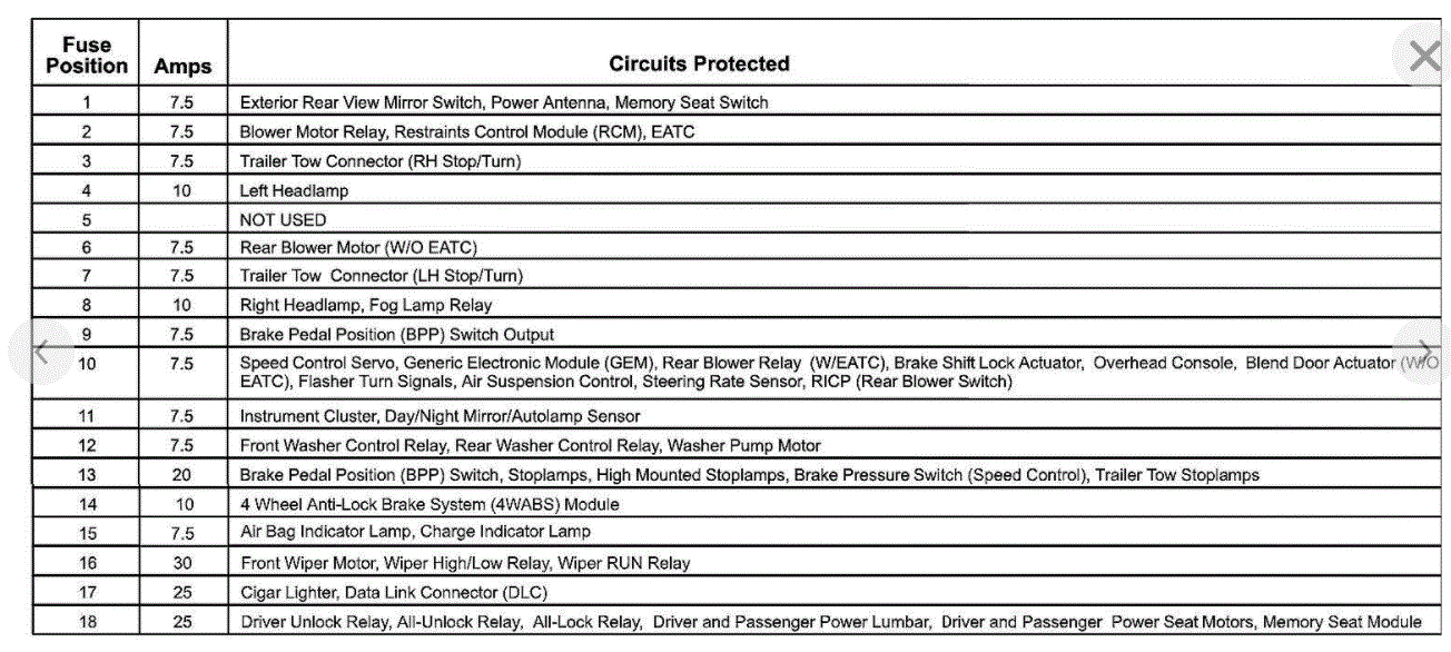

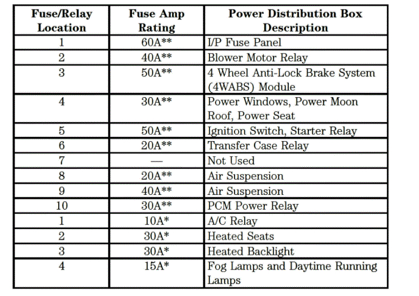

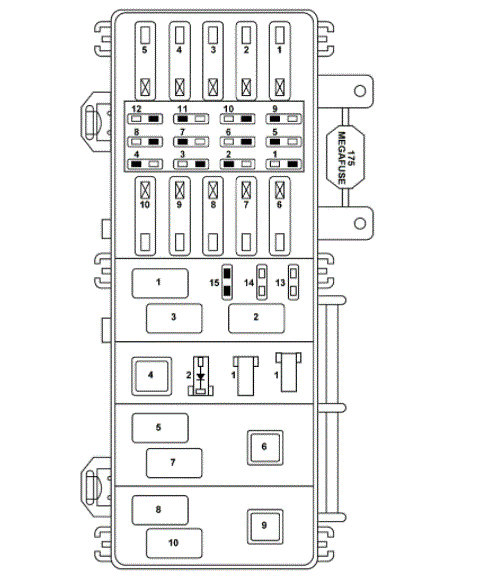

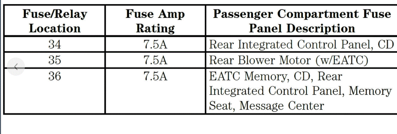

I attached the fuse box and the legends for the fuses so you can see the locations of the fuses needed to be tested.
