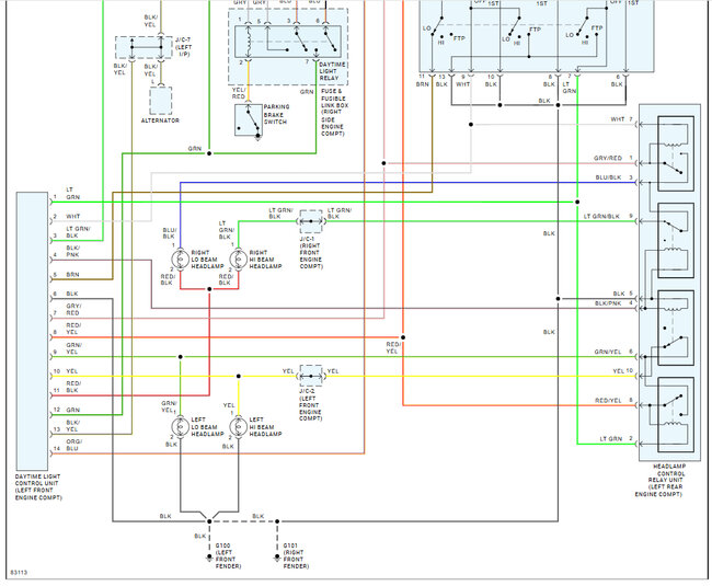

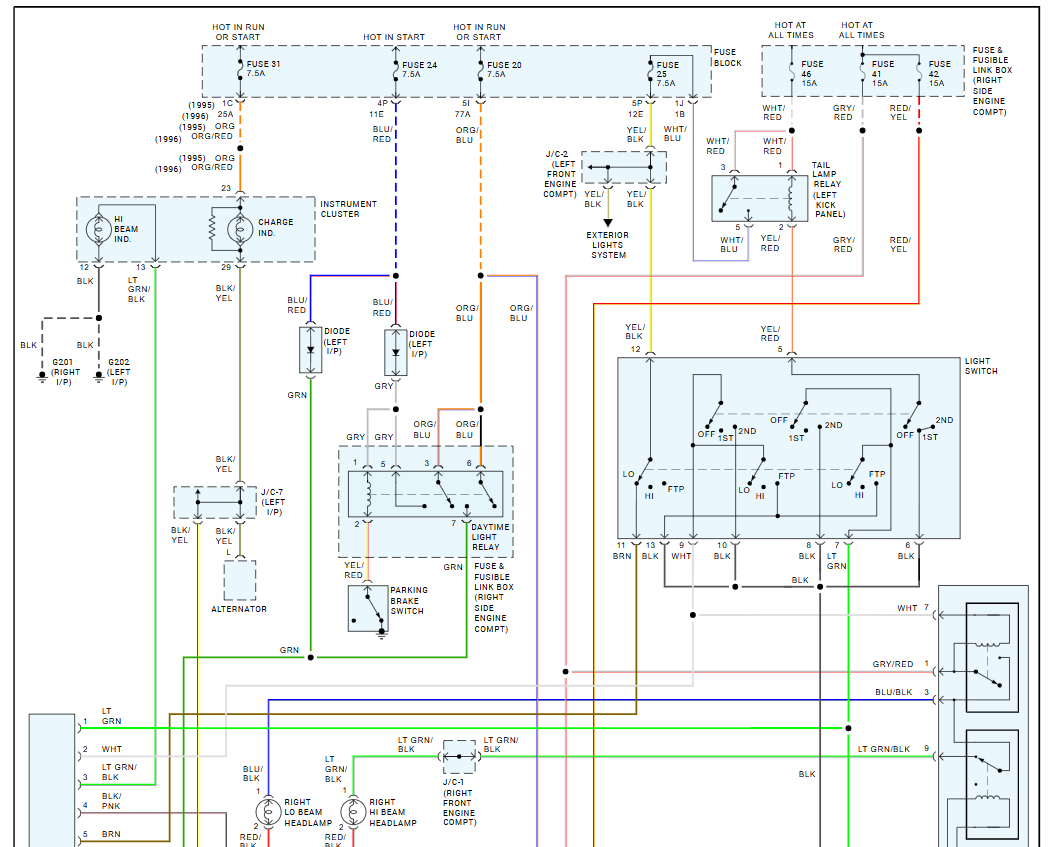

Hello, so we only have high beams and no running lights. Any idea what could cause this?
Mar 3, 2025 at 6:26 AM
  • 55,433 POSTS

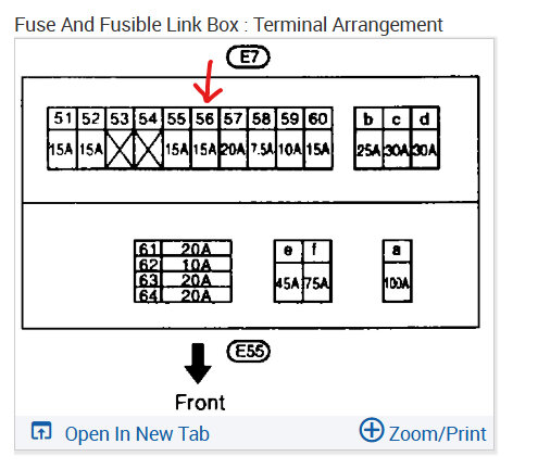

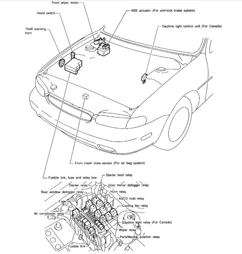

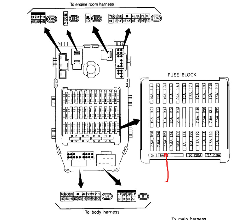

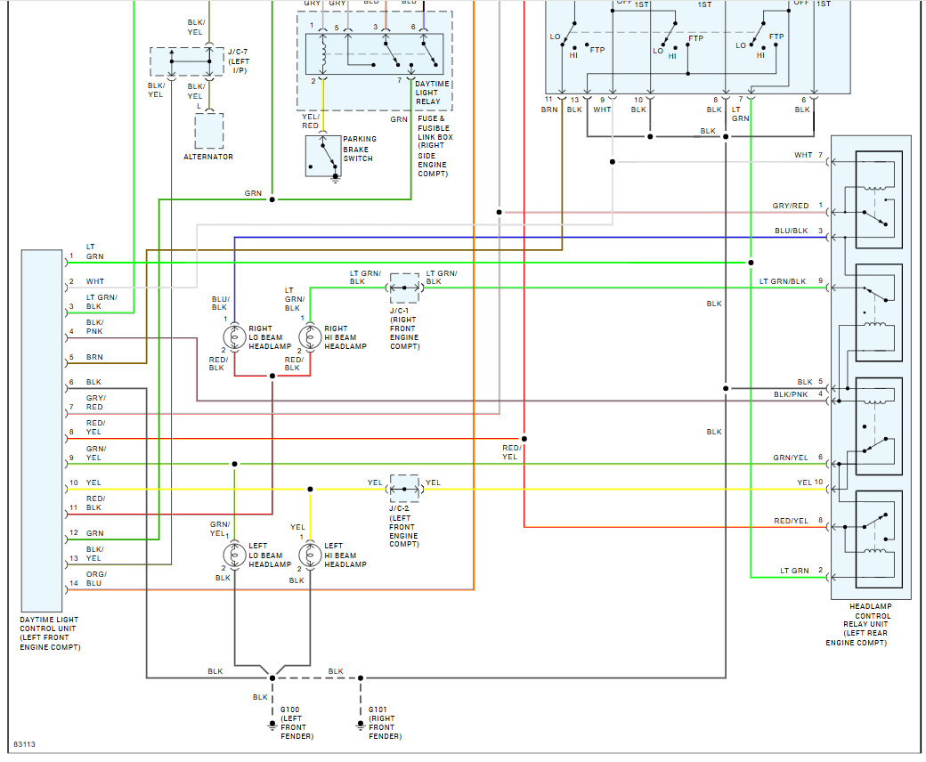

Sure, it can be a couple of different problems but let's start with the easy stuff, please check fuse # 25 7.5 amp and fuse #56. Here is a guide to help and the fuse locations in the image below. If the fuses are okay, I would try swapping out the taillight relay. Here are the wiring diagrams for the switch as well so we can test through it.
