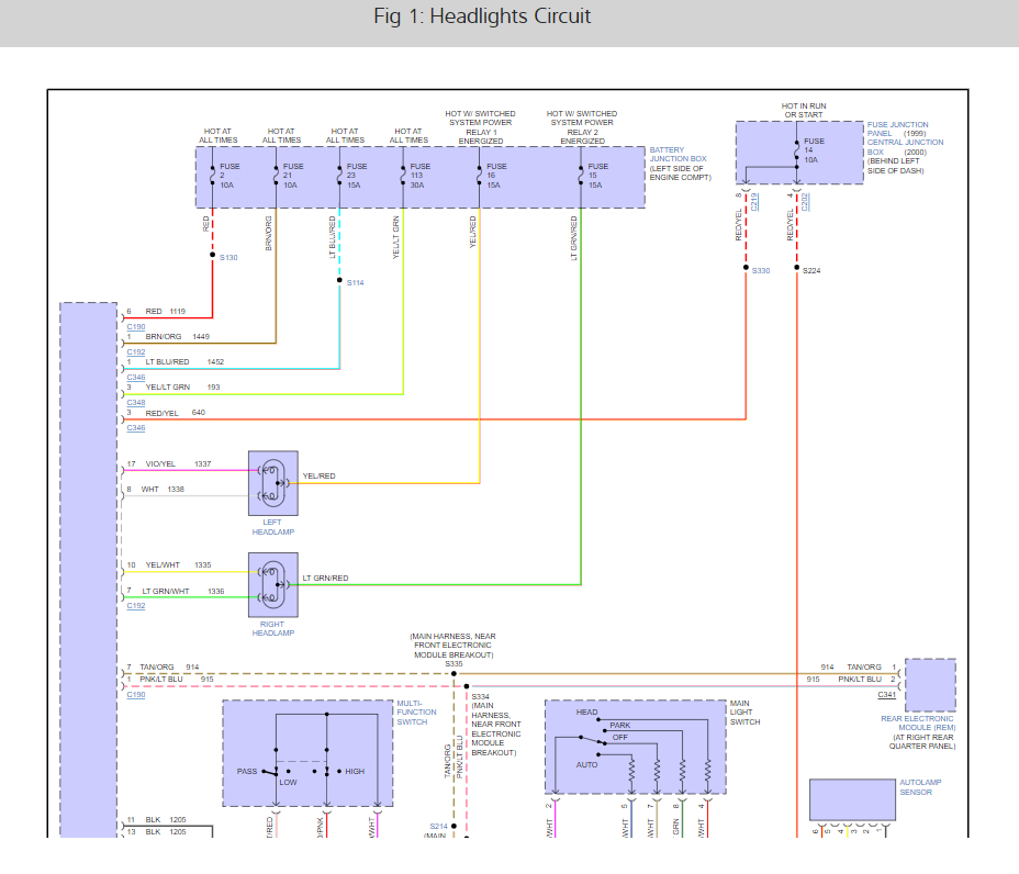

Headlights not working, why?
134,600 MILES • 3.8L • V6 • 2WD
JOHN SHERWOOD

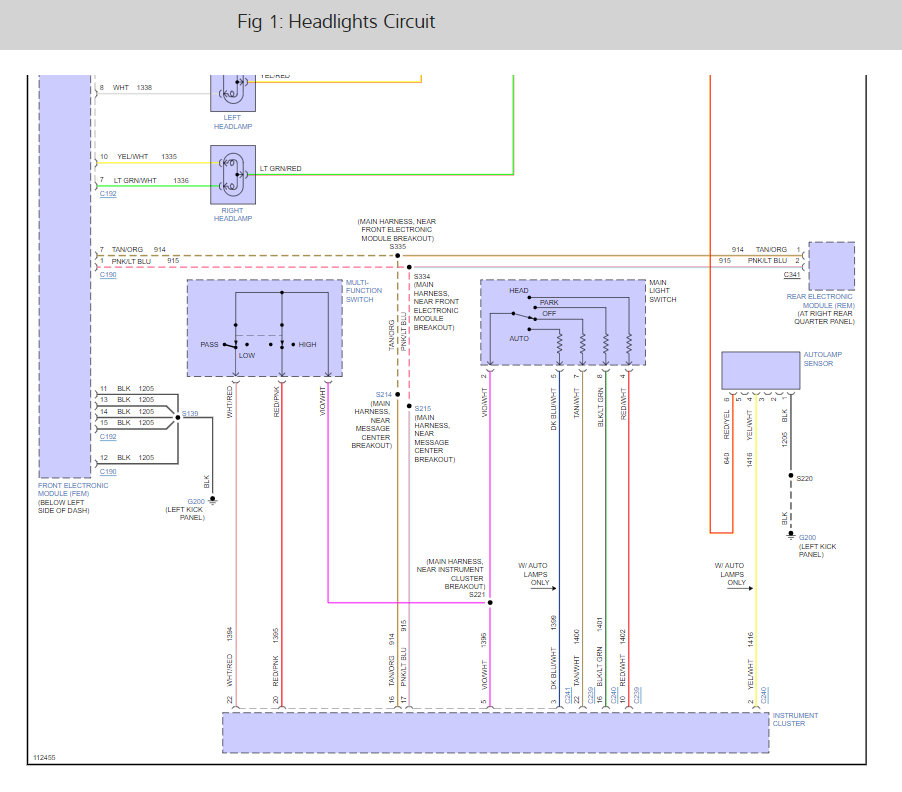

I have all the lights except headlights.
Aug 15, 2022 at 1:08 AM
  • 55,694 POSTS

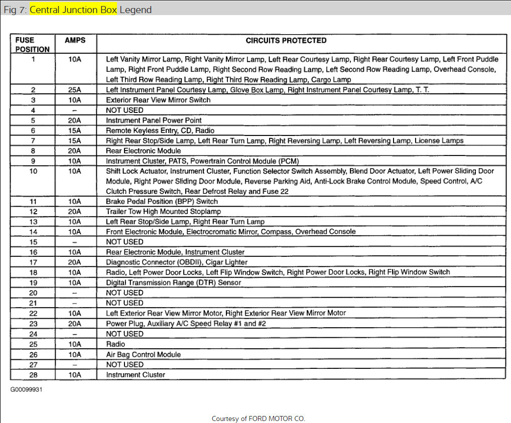

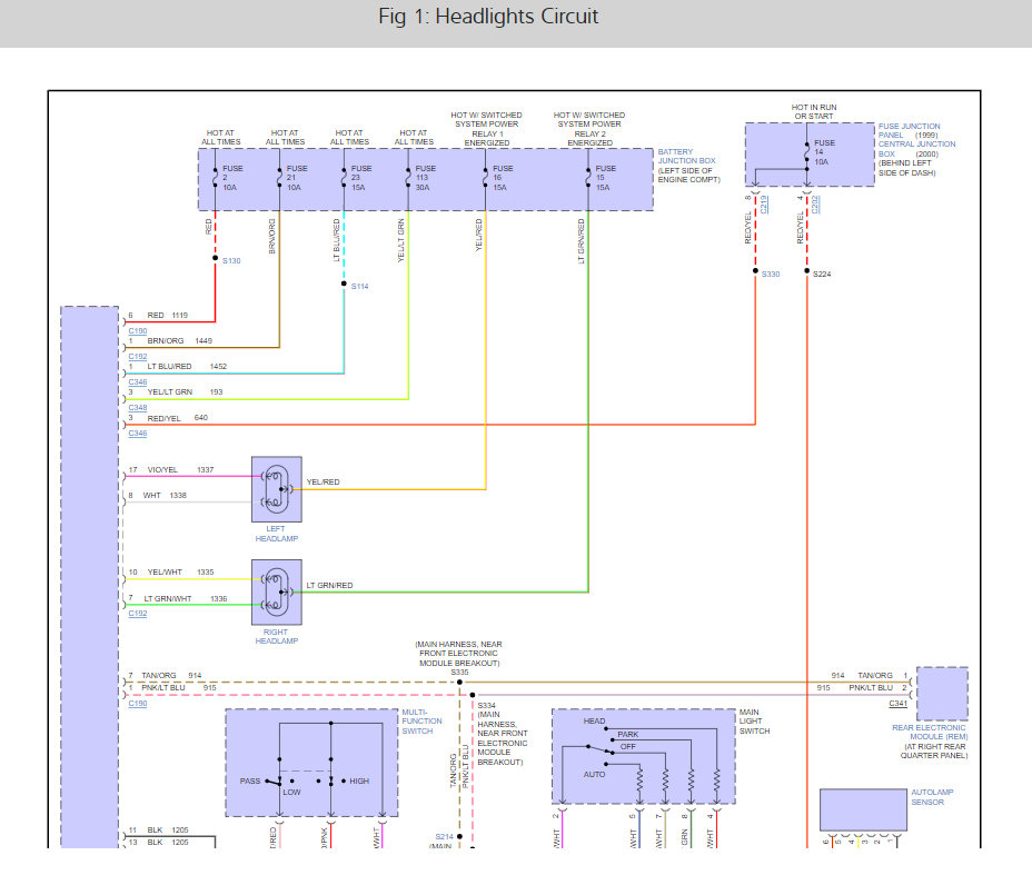

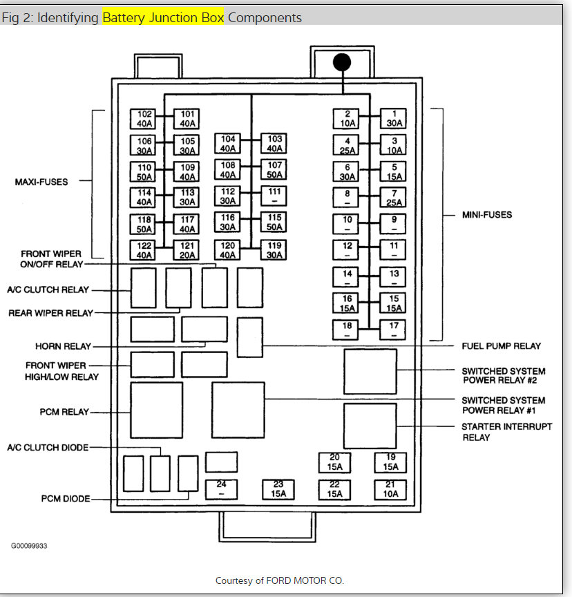

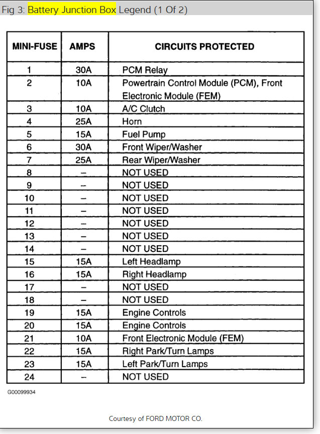

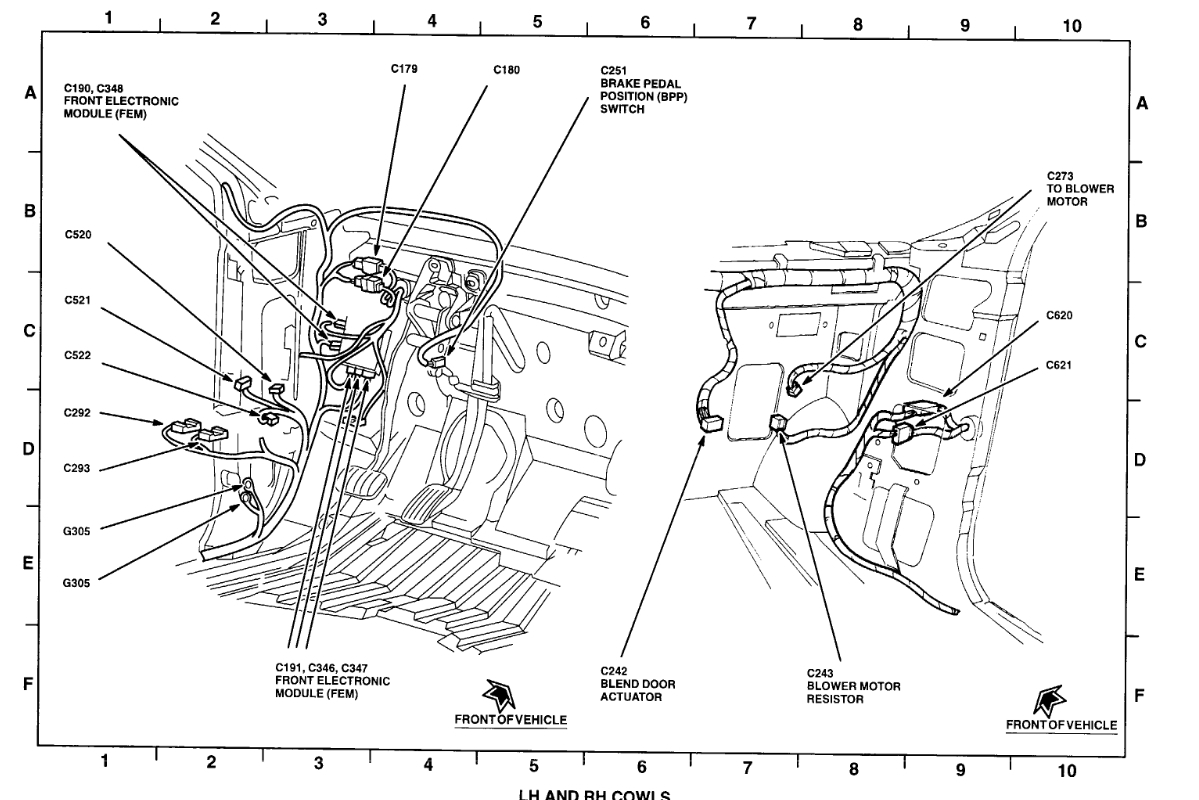

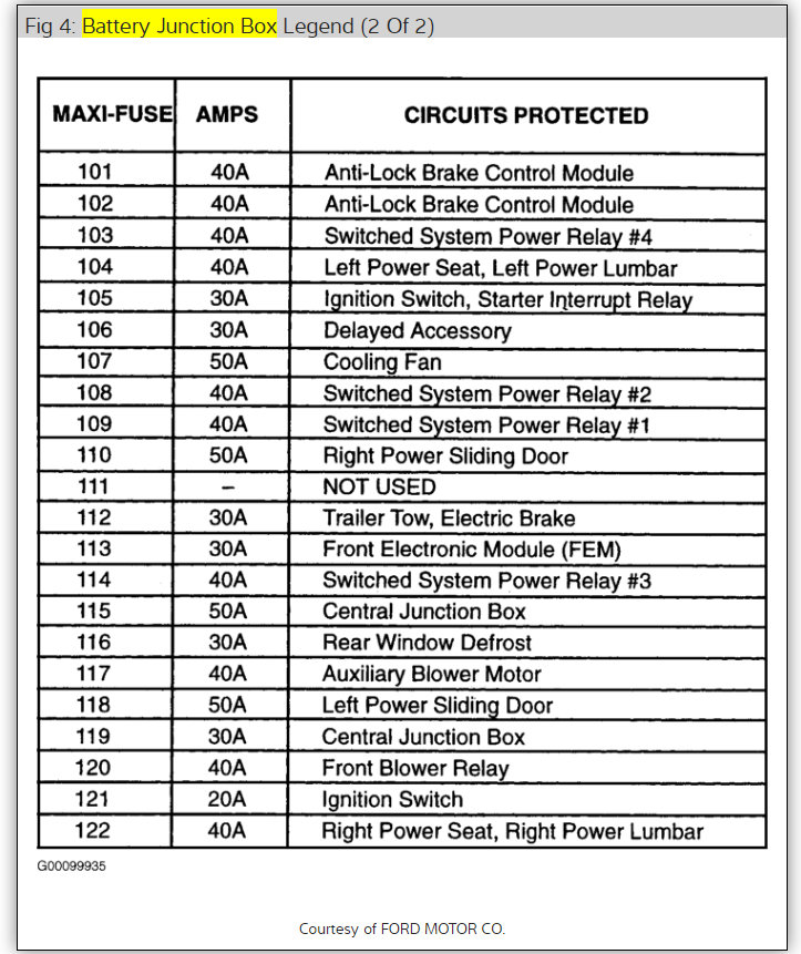

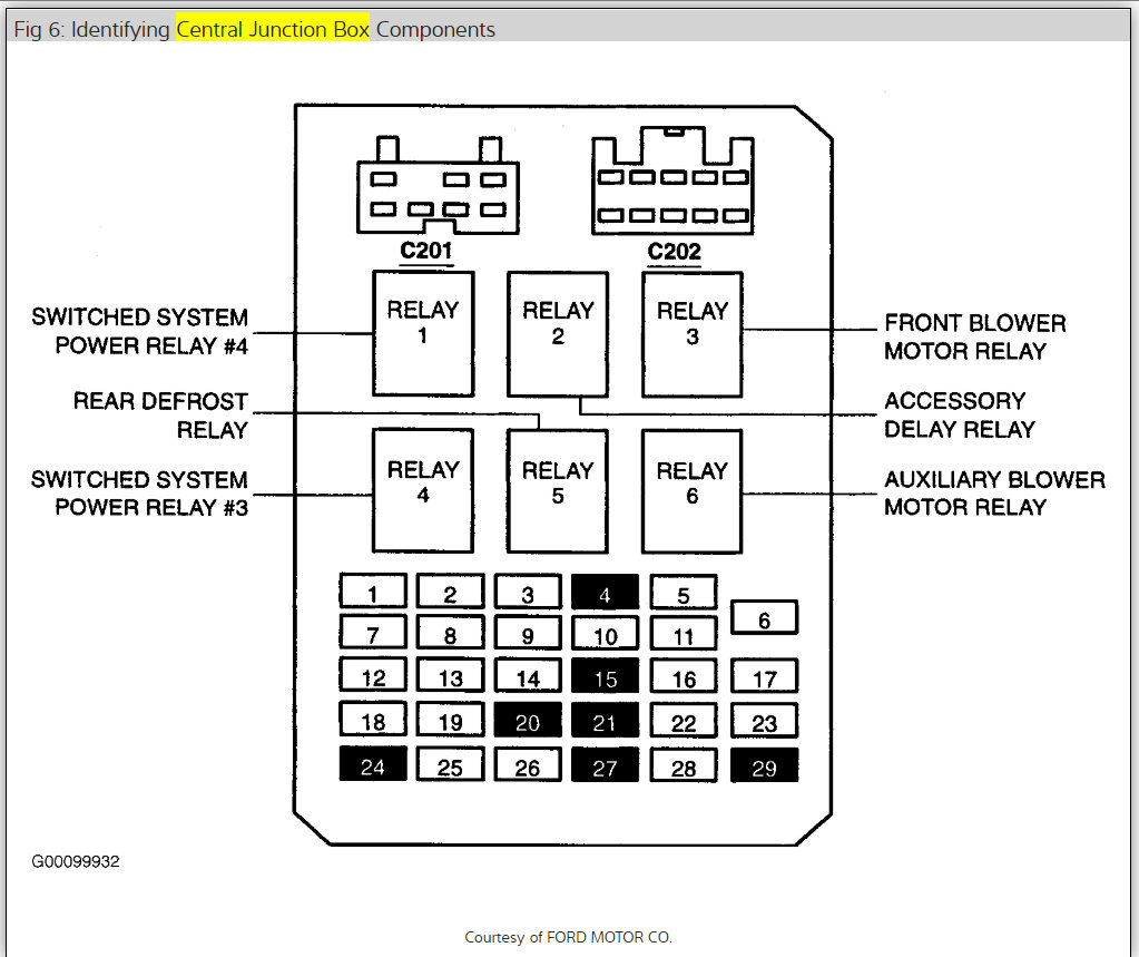

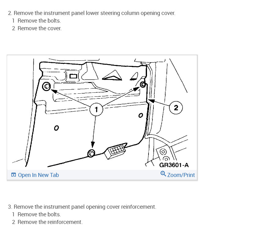

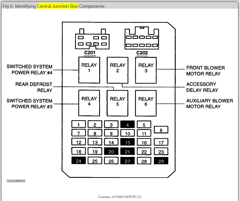

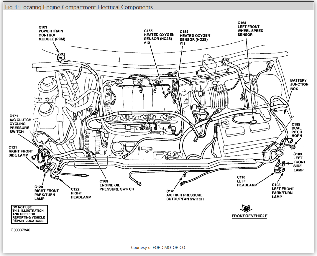

The first thing we must do is check the system fuses #2, 21, 23, 133, 15 and 16 in the under-hood fuse panel and # 14 in the interior fuse panel. here is a headlight wiring diagrams so you can see the fuses that need to be checked. Also, I have included a guide to help with the fuse test.

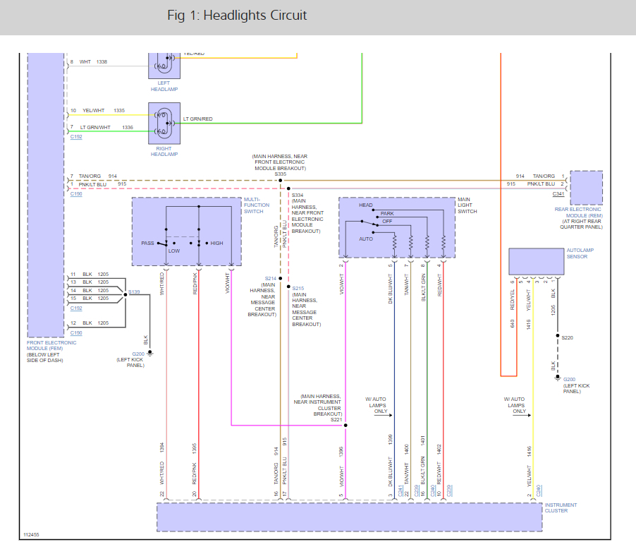

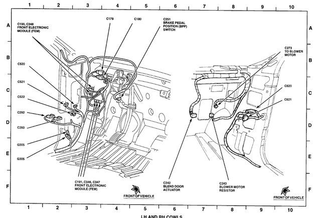

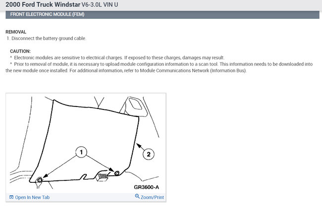

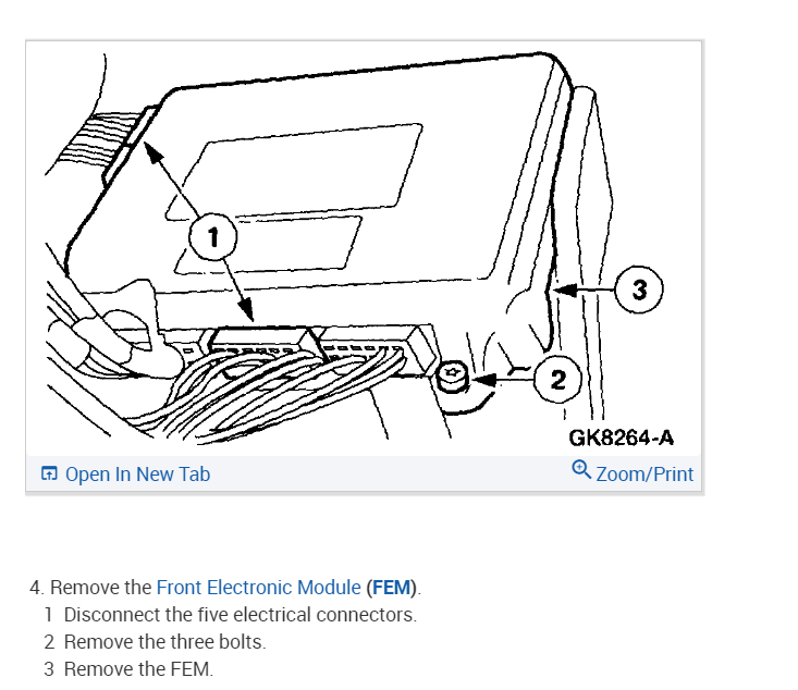

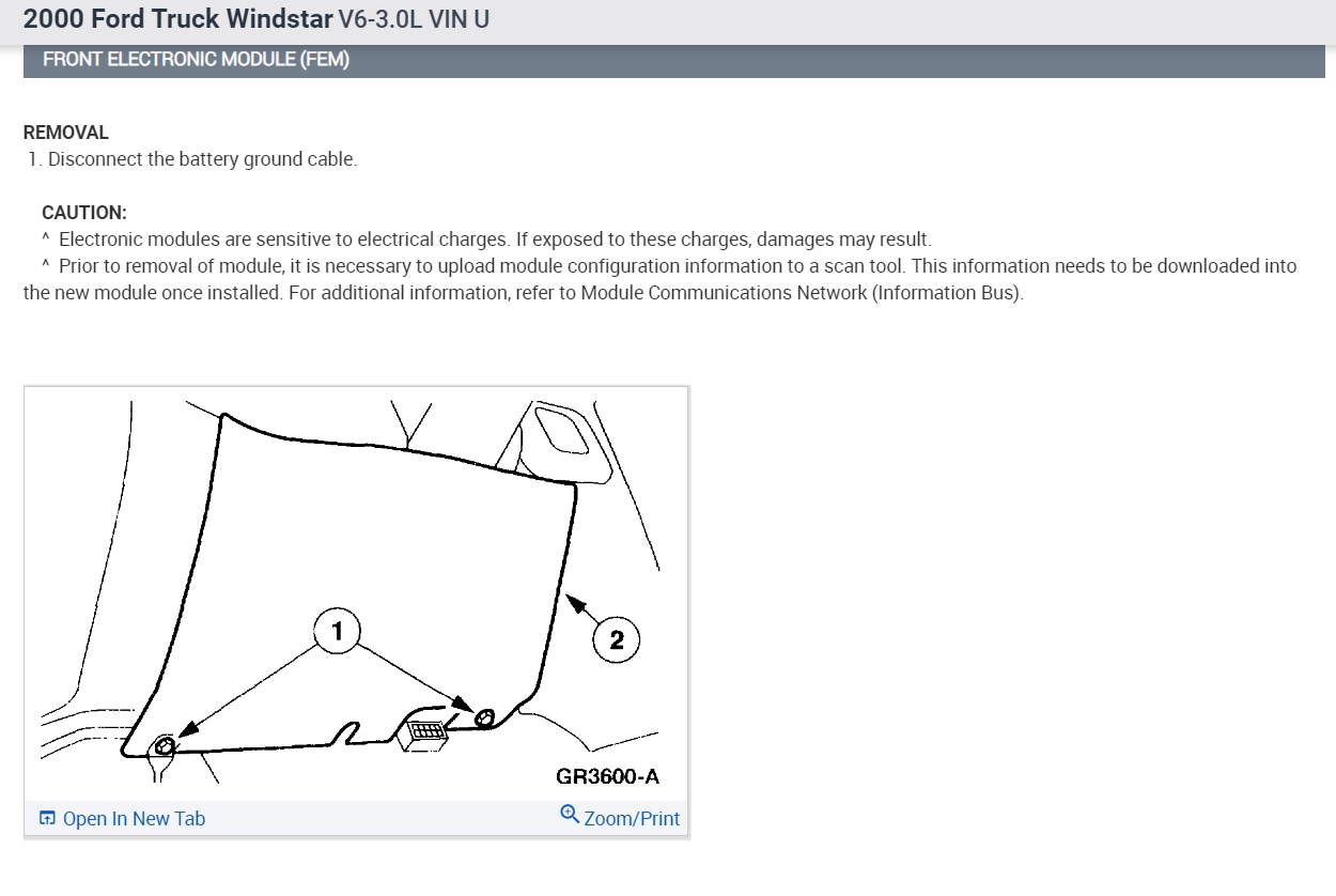

If the fuses check out it sounds like the main light switch, or the front control module is out, you will need to see where it loses power this guide can help:
Check out the diagrams (below). Please let us know what you find.
