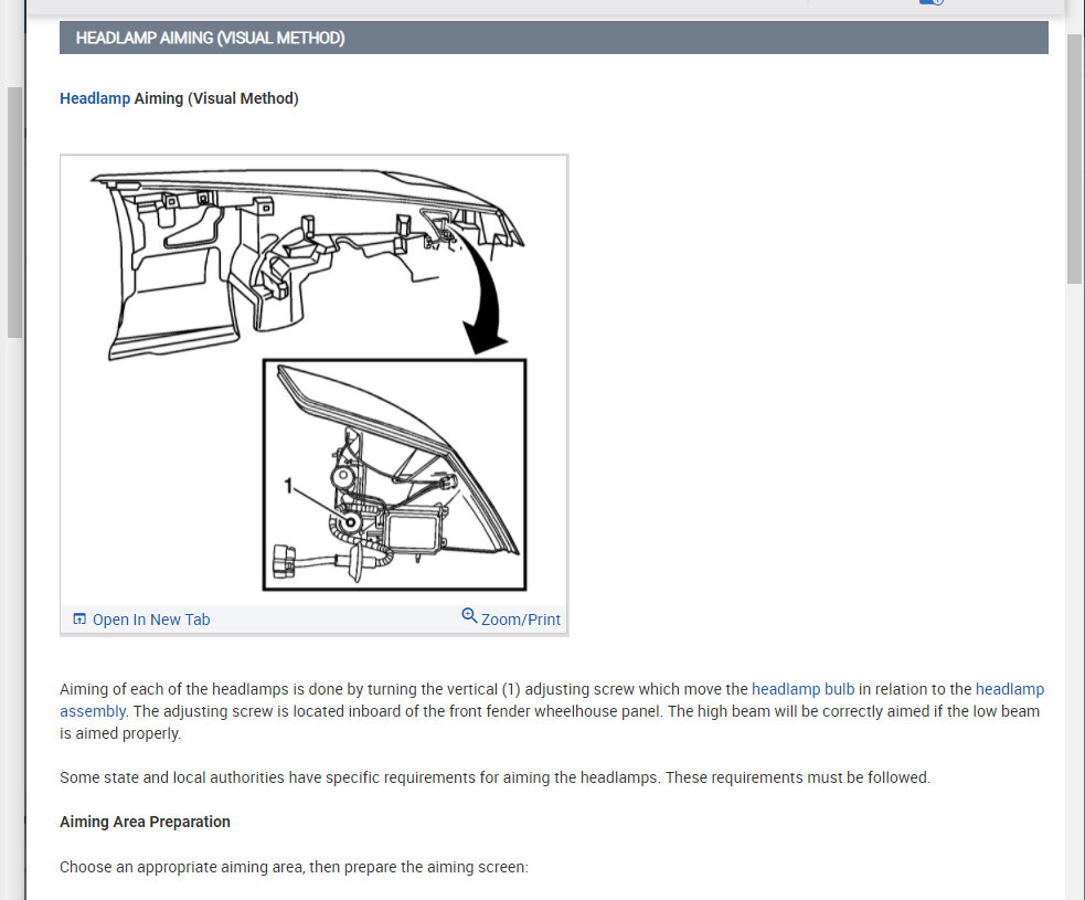

My headlights faces outward and I can't any information on how to adjust them inward.

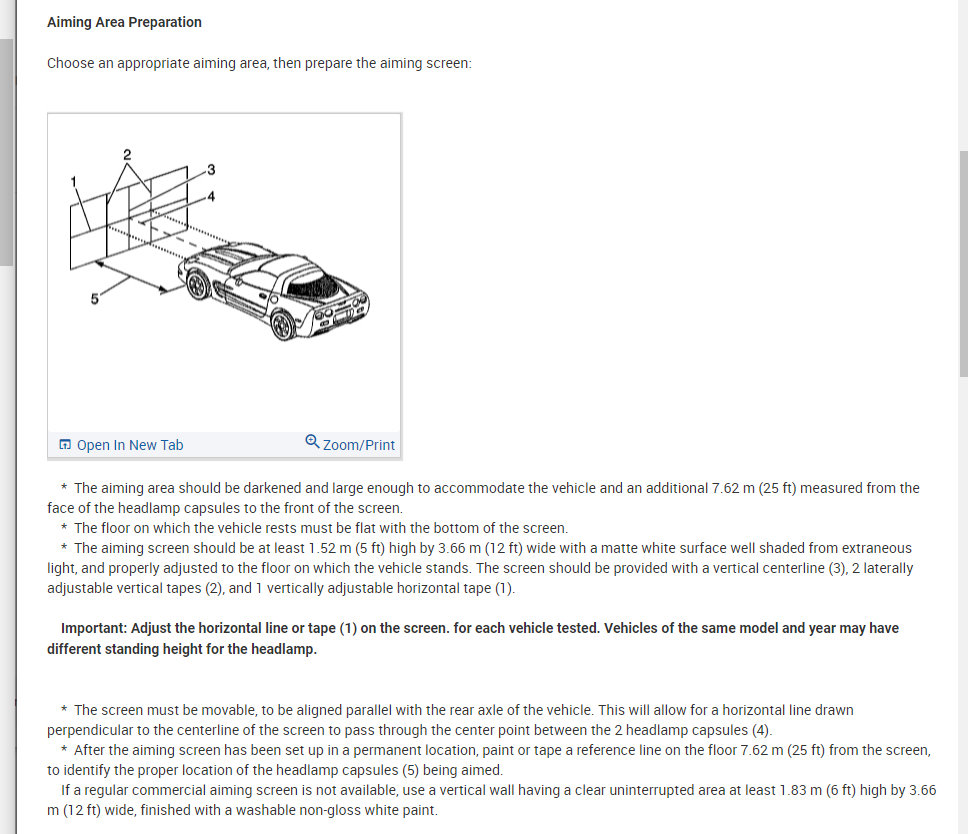

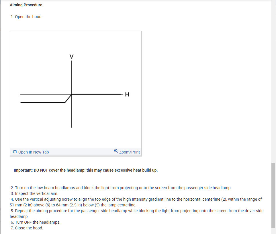

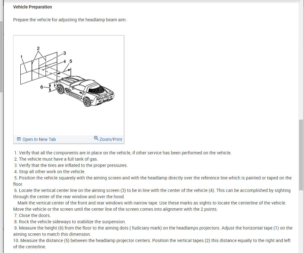

There are 2 adjustment screws that are accessed vertically behind the headlamp assembly lens. In the image below (1) is the horizontal adjustment and (2) is vertical. These can be turned while you have the headlamps on and aimed at a wall. You will see the beam move as you turn the adjusters.
This tutorial covers the basics of the adjustment:
https://www.2carpros.com/articles/headlight-lens-replacement
Below is the entire process from the manual to adjust the head lamps. Let me know if you have other questions on this.
