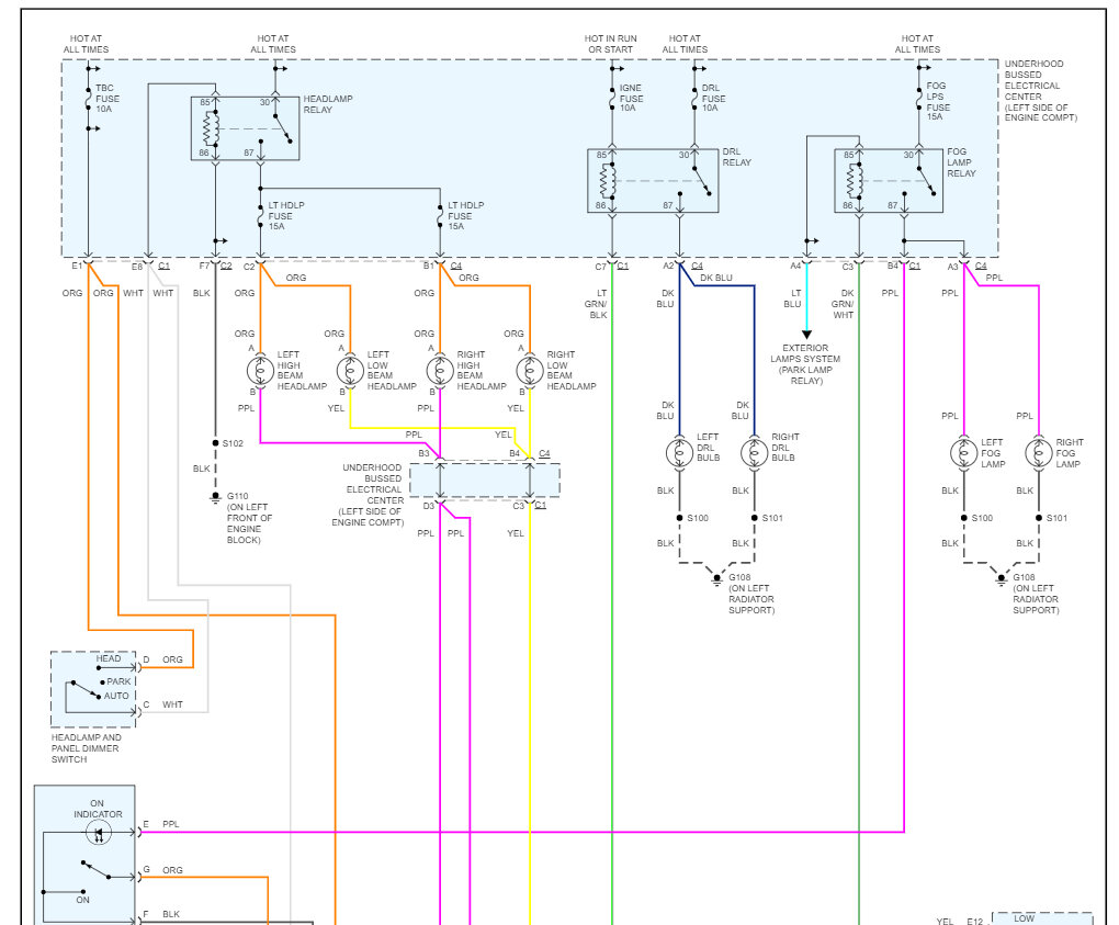

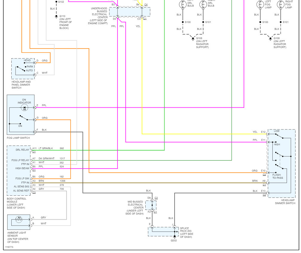

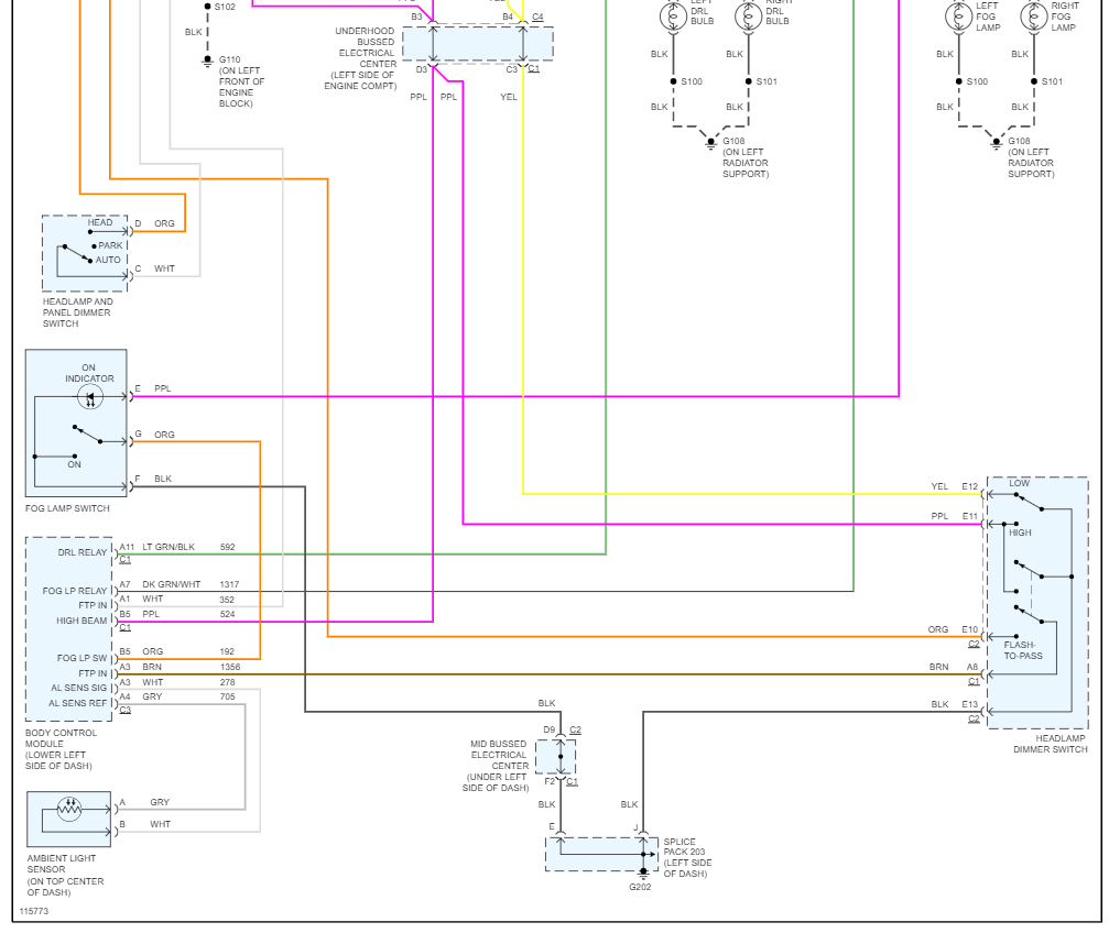

It has no headlights. I've traced the power issue to the dimmer switch in the turn signal multifunction switch. There's a burnt wire at the top right connector and i need wiring diagrams of the circuitry please!
Apr 3, 2023 at 12:18 AM
  • 55,721 POSTS
Yep, here is a guide to help you test the connection and I have provided the head light wiring diagrams is the images below.
Check out the images (below). Please let us know if you need anything else to get the problem fixed.
