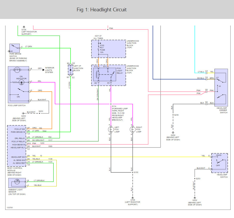

My automatic headlights will not come on. The running lights and turn signals work.
Aug 15, 2018 at 7:55 AM
  • 55,851 POSTS

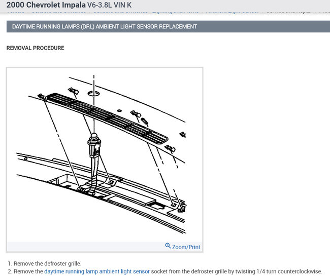

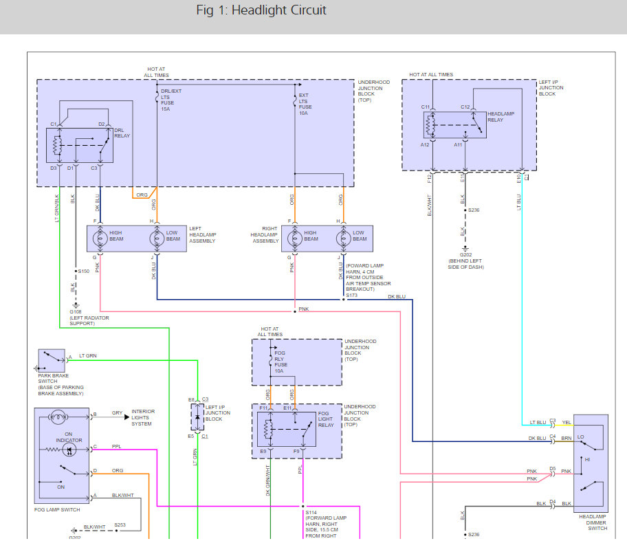

Hello, it sounds like the ambient light sensor has gone out for the headlight system. Here is a wiring diagrams so you can see how the system works and the location of the sensor.
