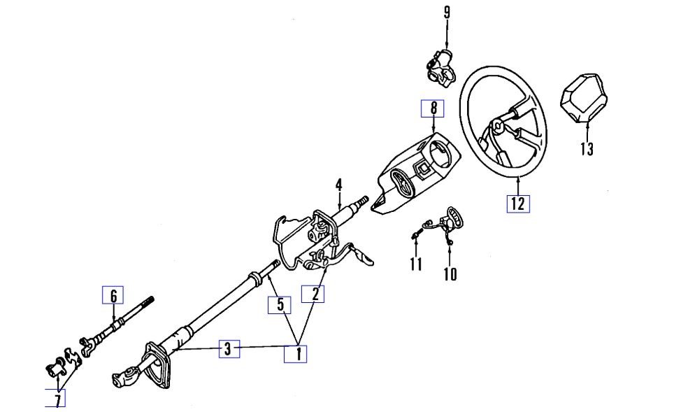

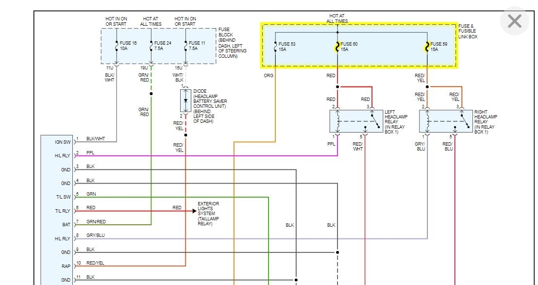

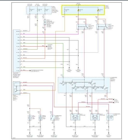

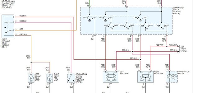

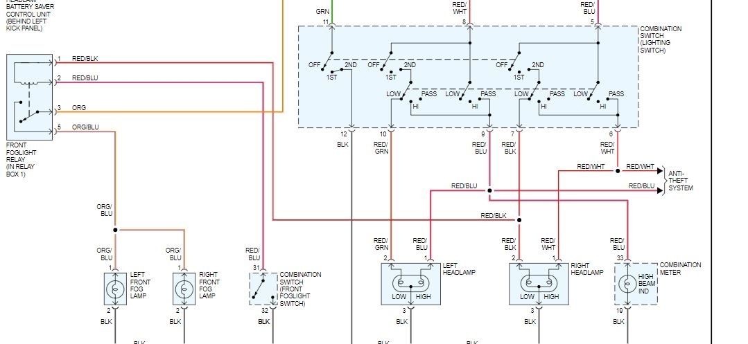

My headlights just stopped working out of nowhere. If i hold it towards me (they work) but that is only if i am holding it.
Jun 12, 2019 at 7:15 PM
Experienced Mechanic
52,796 POSTS
Good morning,
This sounds like the multi-function switch has failed.
https://www.2carpros.com/articles/how-a-headlight-switch-works
I assume by it, you mean the turn signal handle to change high and low beams?
