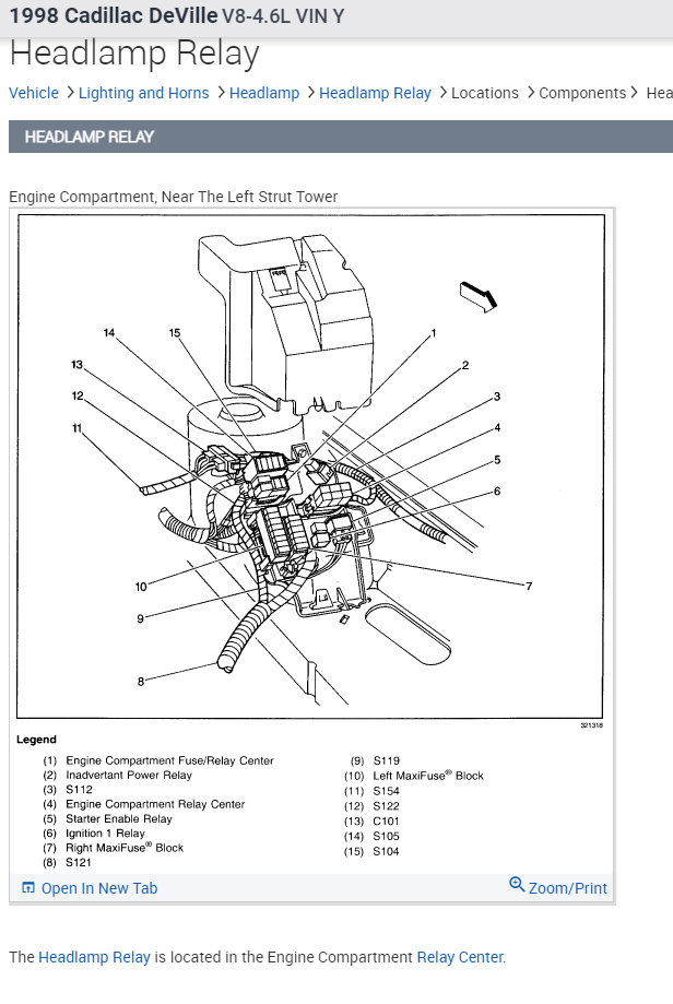

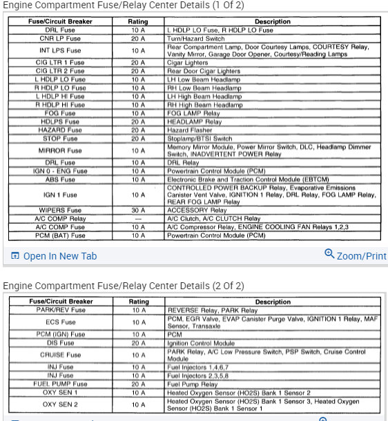

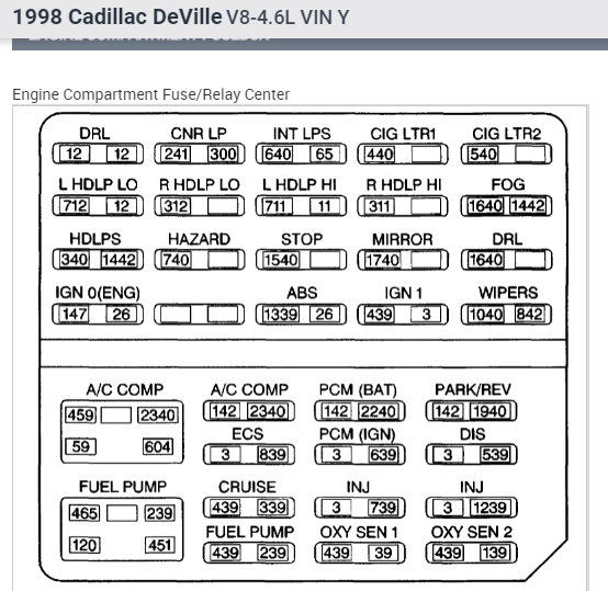

There is a relay for the headlights located in the under-hood fuse box.
Check that relay, maybe you can swap it with a similar one next to it and see if the light comes on.
The relay can also be tested.
I have attached the diagrams below.

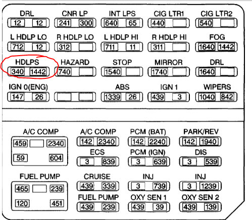

Which one is the Headlight Relay Switch? A video would be nice. Finding it, testing it, how to replace it?
Oct 15, 2021 at 9:17 AM
SQM
  • 6,383 POSTS

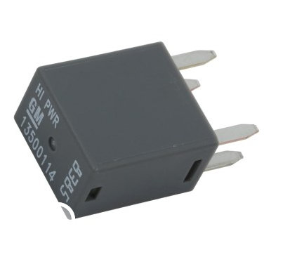

I have circled the relay on the chart below. It shows the orientation of it.
Also attached a picture of what the relay looks like.
This is a guide that shows how to test any relay step by step:
https://youtu.be/Hlna_kUt7As
The relay will simply pull out just like a fuse.
