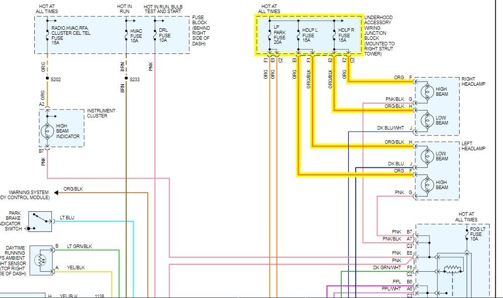

Checked the headlights fuses and they are fine. Checked the headlights themselves and as you can see with the picture below, they are fine. Even tapped them to see if they would go on but to no avail. Don't know what it could be.
Feb 8, 2020 at 3:28 AM
Good evening,
The fuses are good if you have power to the lamps.
Do you have power on the other side as well?

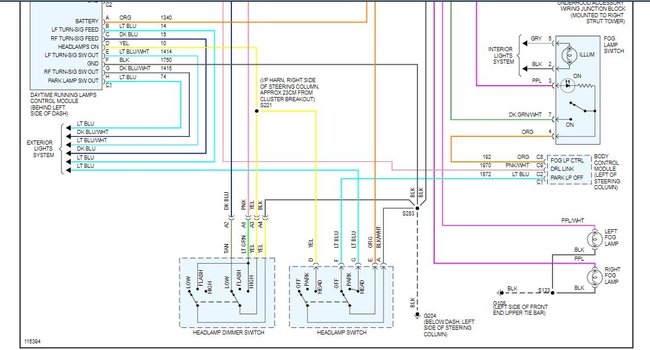

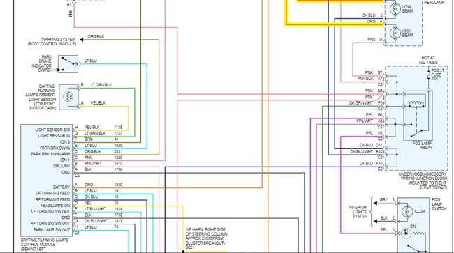

I attached a diagram fr you.
Do you have fog lamps?
Np picture attached.
