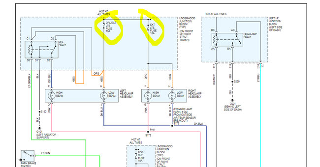

I checked the relay fuses they were not corroded or blown so I don't know if the switch on steering wheel where you turn the brights on is bad, it doesn't click anymore. I have parking lights. If it is that switch in what is an estimated amount for the new one?
Apr 3, 2019 at 5:03 PM
Good morning,

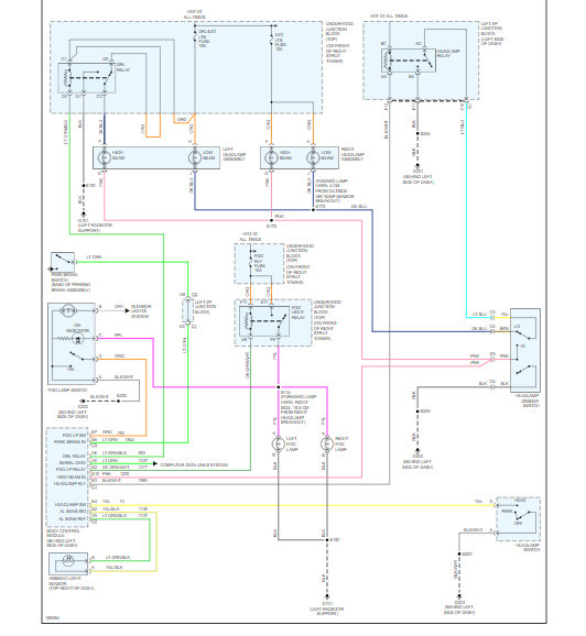

I attached a wire diagram for you to view. Check the fuses I circled for power on both sides.
Beyond that, if it is the switch, you are looking at $250.00 to $300.00 for the repair, if that is the issue.
