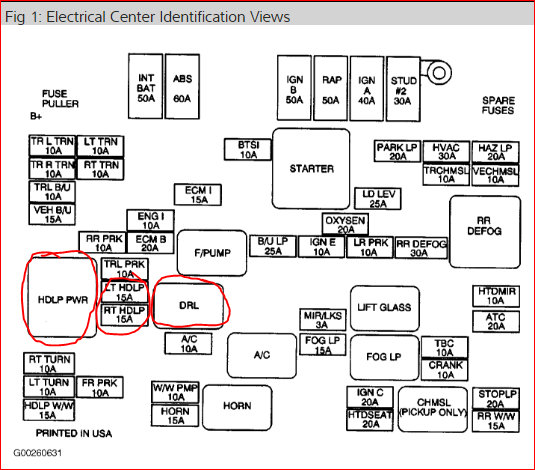

My headlights and all running lights come on automatically and all exterior lights work perfectly during the day. At night my headlights do not come on automatically or work by the light switch, but all running lights, taillights and brake lights work perfect automatically or with the switch. I have cleaned the senor on the dash and checked what fuses I knew of and all seems fine. Please help, I do not like driving my wife's Jeep, lol.
Jul 9, 2018 at 12:28 PM
DANNY L
  • 5,648 POSTS

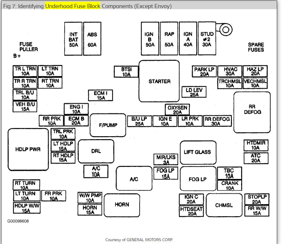

Hello,I am Danny.
I would start by checking the headlight and daytime running lamp relays. I have attached a testing link and a picture of the under hood relay location (circled in red). Be sure to check connections for being burnt/melted. Hope this helps and feel free to ask any further questions. Thanks for using 2CarPros.

Headlights stopped working. Doesn't work auto or manually. A few days ago, they came on while driving but went off again shortly after. Fuses are ok and tried another electronic flasher with no luck. Corner, signal and fog lights work fine. Help??
Mar 13, 2021 at 4:39 AM (Merged)

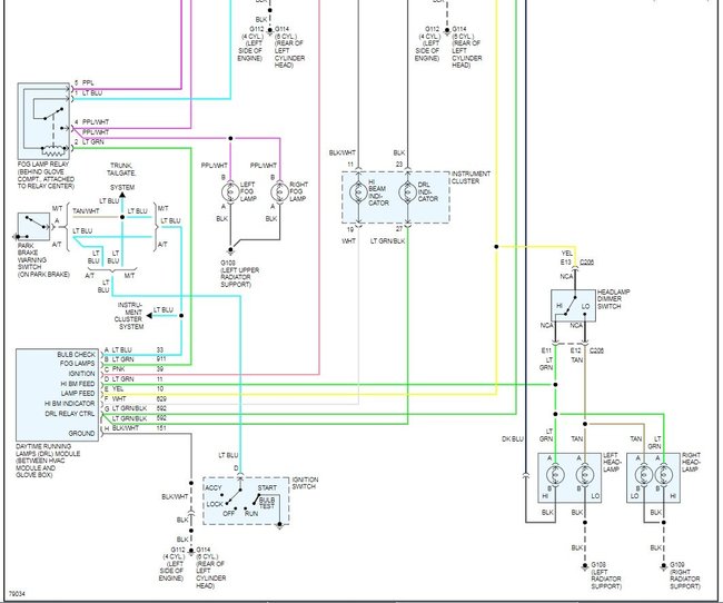

JDL
  • 16,098 POSTS

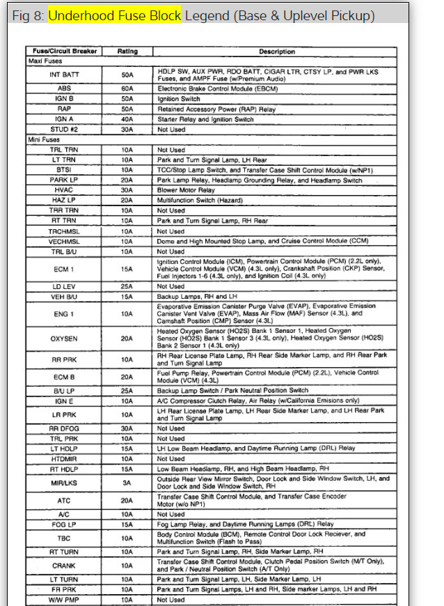

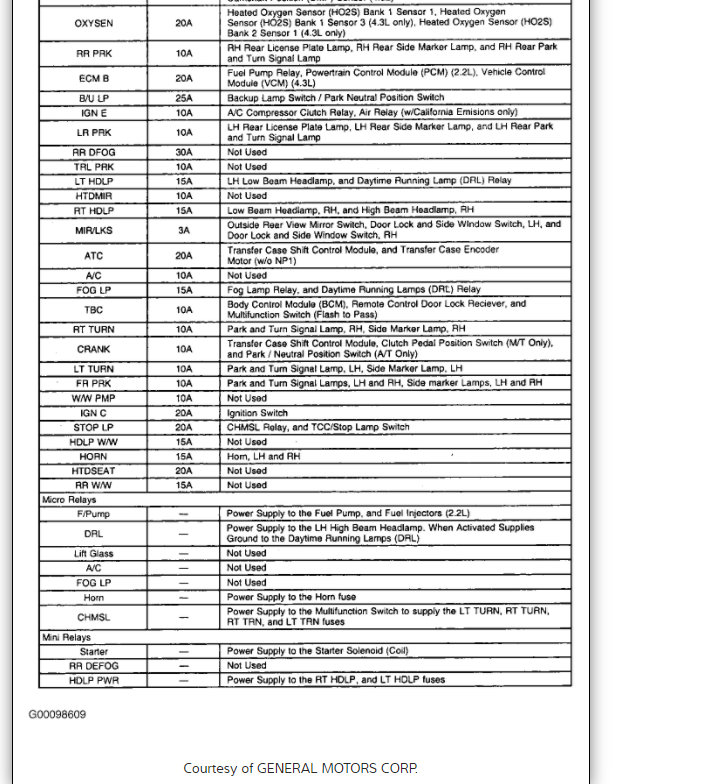

There is a headlight power relay that needs to be checked here is a guide to help walk you through the steps with the relay location below and the headlight wiring diagrams so you can see how the system works.

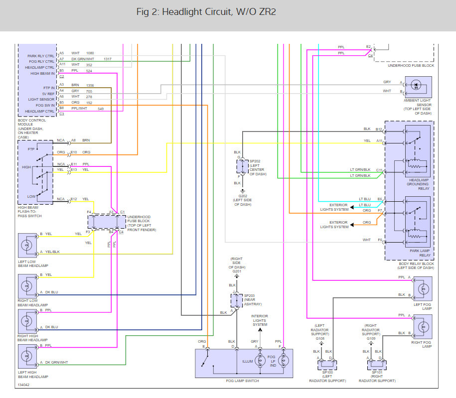

So I have no headlights to my truck, but I do have power going to them. Also, my daytime lights work.

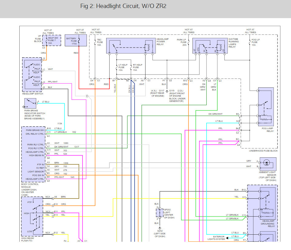

  • 110,248 POSTS

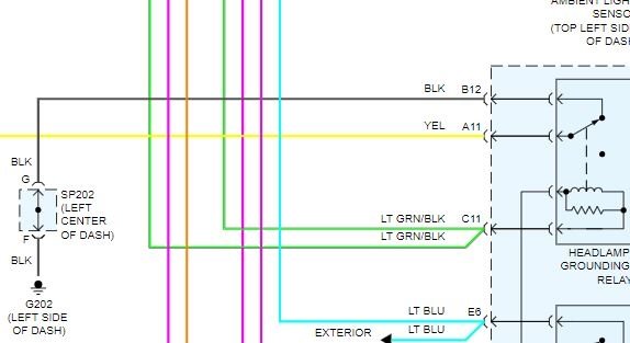

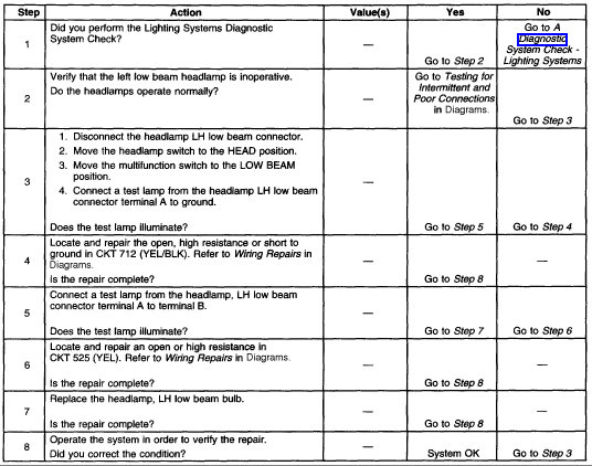

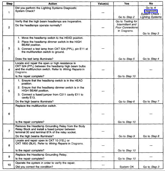

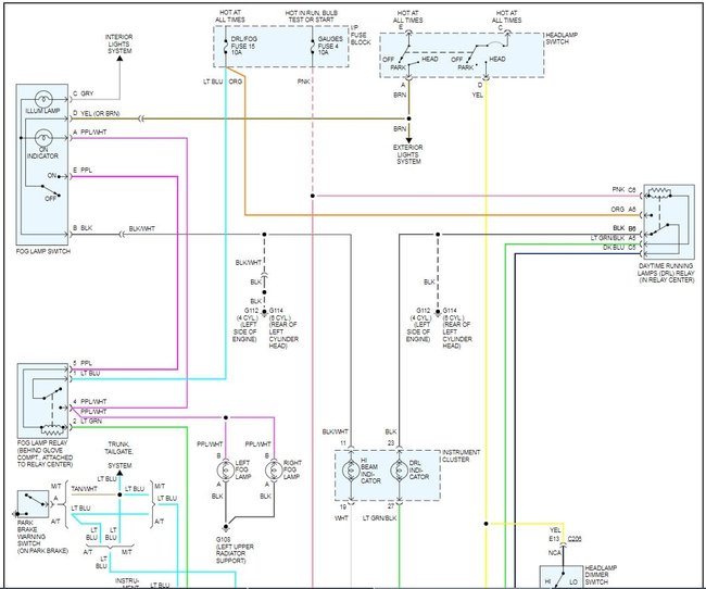

Hi and thanks for using 2CarPros.com. If you have power to the lights and the do not work, chances are it is a ground issue. When you test for power using a multi meter or test light, you create your own ground. If the connection is clean, tight and not damaged, I recommend the following.
The first things I would recommend checking is the grounding system. I have attached a wiring schematic of the headlamp grounds. Take a look at that first.
If you determine that the grounds are in good condition and functional, then move review the diagnostic flow charts I attached. There are two different ones. One is for low beam and the other high. The charts are from alldata and are used by technicians to determine where the problem is coming from.
Here are directions for checking wiring just in case you run into trouble:
Here is a video related to using a test light for multiple functions:
https://youtu.be/Hlna_kUt7As
I hope they help. If you find you are still having trouble or new questions, please feel free to ask. I am online most every night.

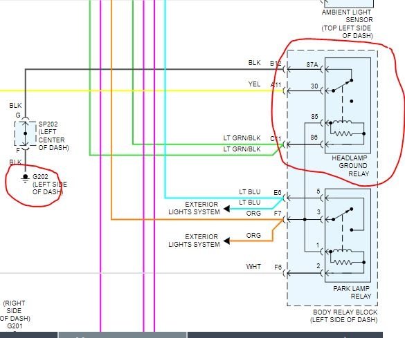

BRADLEY BARNETT

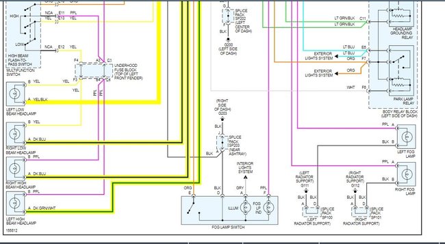

I have no headlight on my truck listed above base model with 4.3 v6. i have replaced both relays and fuses are good. Front corner lights work fine as do rest of the lights. I can ground the headlight directly and they come on. i have checked the grounds and clean them up. any ideas? i also have replaced the headlight switch.
Mar 13, 2021 at 4:40 AM (Merged)

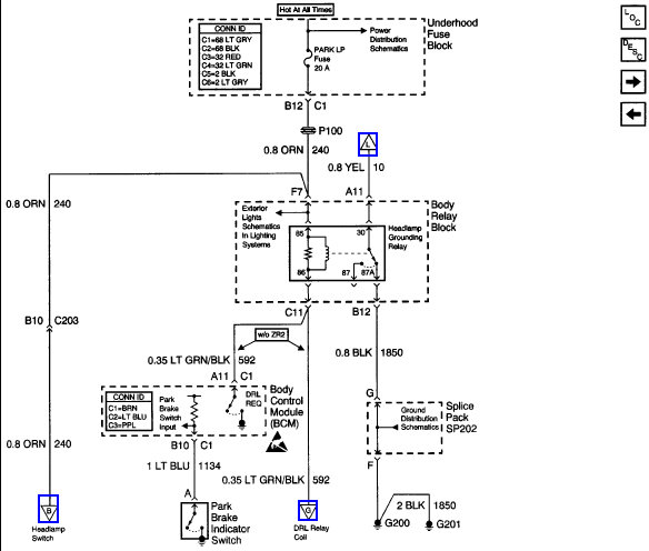

  • 110,248 POSTS
Welcome to 2CarPros.
If you cleaned the grounds and have continuity to ground, my first suspect is the headlight grounding relay is bad. The relay is located in the body relay block on the left side of the dash. I have attached two pictures to help you locate it.
Here is a link that explains how to test a relay:
Here are other links you may find helpful:
Check that and let me know what you find or if you have other questions.

PEGGY STEWART DARLEY

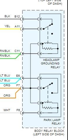

We replaced bulbs, relays (under hood and under driver-side dash), had all tested and is getting fire to headlights. Checked grounds, no problem we could see. Please help!
  • 110,248 POSTS
If there is power at the light sockets, then either you have a bad ground or the light sockets are bad. How did you check ground? Did you check the headlamp ground relay?
I attached a pic below showing ground and the relay. Check both. There is a splice in the ground wire, so confirm there is continuity at the sockets.
Here are a few links you may find helpful:
Let me know what you find.

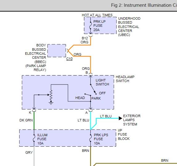

SONOMACOBWEB
My headlights don't work with the switch in day time... they do work automatic.. and if I pull it in my garage the headlights will work with switch but nothing else .. not parking lights no dash no rears .. only headlights.. but they all work automatic when it gets dark !! Help please it's so annoying
Mar 13, 2021 at 4:41 AM (Merged)
JDL
  • 16,098 POSTS
you have an illumination fuse, should be interior fuse box. Turn on headlamp switch, check fuse, also check fuse circuit for voltage, use a test lite.
The diagram is for instrument illumination.
SONOMACOBWEB
I dnt have a test light... and where would I check it ??
JDL
  • 16,098 POSTS
Check for voltage at the fuse in the diagram, go from there.
A test light is a basic automotive diagnostic tool, doesn't cost much. If your going to work on your own vehicle, you need some of the basic tools.
I can only recommend what to check, you have to do the testing.

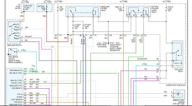

KAWASAKI_DUDE
My head lights stopped working. the lights used to work but they would cut out and i would hear a clicking noise coming from the glove box area. i checked out the contents of the glove box area and found a relay access panel. i replaced the relay but my lights have not turned back on. my regular running/parking lights still work but they are not bright. does any one have any ideas??
HMAC300
  • 48,601 POSTS
Could be a bad switch or relay.
Read the guides below on testing electrical they will help
The wiring diagrams for your headlights are attached below
