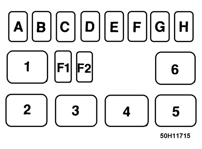

My headlights will not turn on. How do I find out what I need to replace?

First check Fuse "G" under the hood. That is a large 50-amp maxi-fuse.
