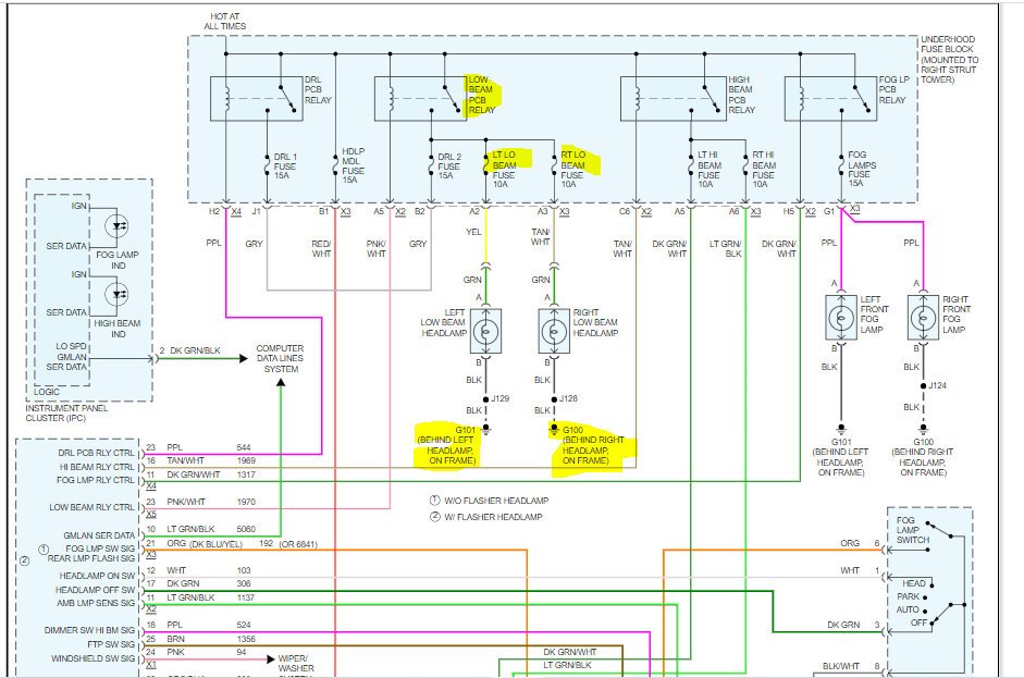

Bulbs are good. Fuses are good. Daytime running lights and fog lights work. Removed headlight assembly to test power and ground. I have power on both pins on both sides. Could this possibly be a grounding issue? If so, where do I find the ground for headlights?

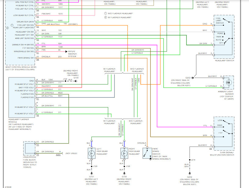

I attached the wiring schematic below. If the high beam works, the ground is good. That leaves a power supply which you indicated is present.
So, check the light socket and make sure it isn't corroded or damaged. Also, are you certain the bulbs are good?

Thanks for wiring schematic. High beams do not work. No corrosion or damage in either socket. The only lights that work are the DRL and the fog lights. No low or high beam. Bulbs are good. Fuses are good. Although I was reading something about a non serviceable relay on underside of fuse block. Some kind of circuit board. If that's the case will the entire fuse block need to be replaced?

That is correct. There is a high and a low beam relay that is part of a printed circuit board and non-serviceable.
If you look at the schematic I sent, it indicates PCB, which is a printed circuit board. I have no idea why they do these things.
