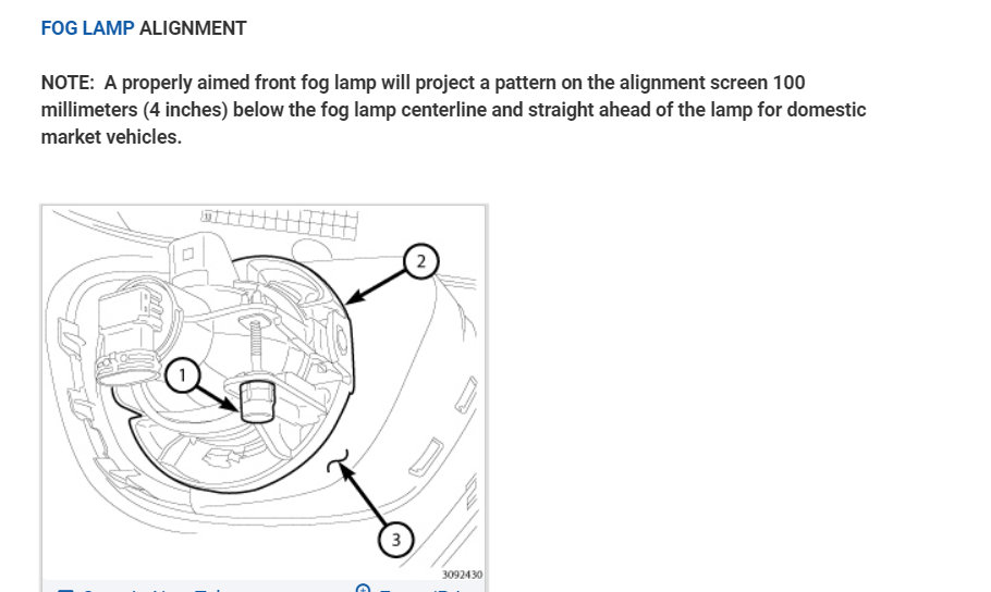

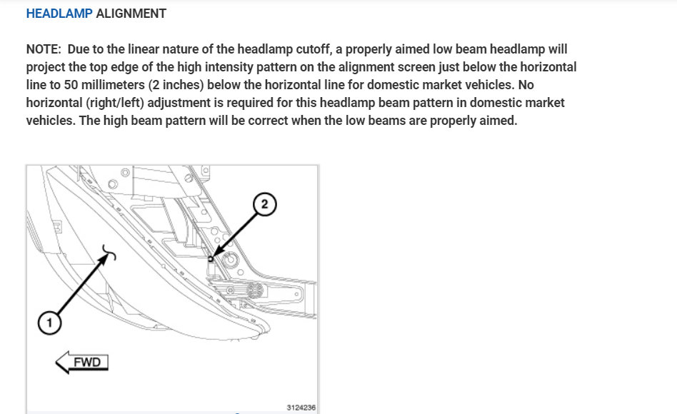

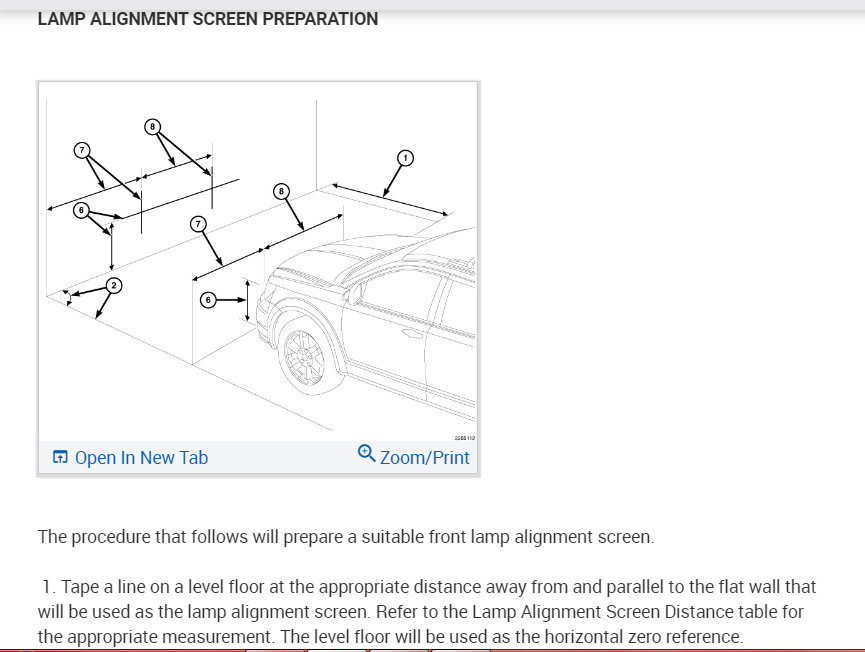

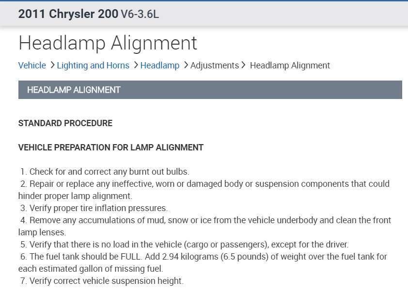

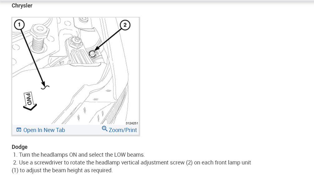

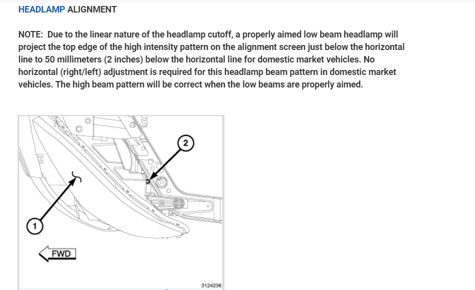

how to adjust the beam if they are too low?
Nov 20, 2019 at 5:58 PM
SCGRANTURISMO
  • 4,897 POSTS
I have included the requested information plus a guide on how to adjust your vehicle's fog lamps [if equipped] too in the diagrams down below. Please go through these guides, adjust your vehicle's headlamps, and get back to us with how everything turns out,.
