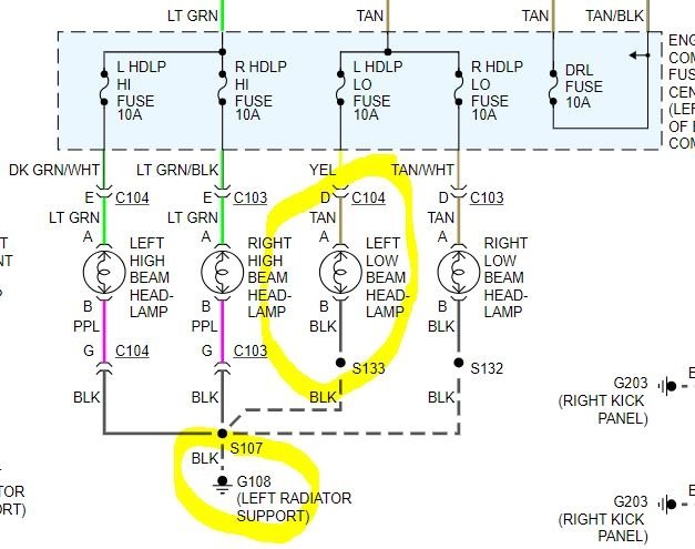

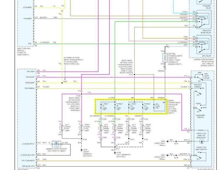

The drivers side head light is very dim.
Mar 10, 2019 at 9:34 PM
Experienced Mechanic
52,796 POSTS
Good morning,
The most common issue is either a bad ground or the connector on the headlight is corroded.
The ground is on the left radiator support. It is the ground for all the headlights.
I would think it is the connector.
