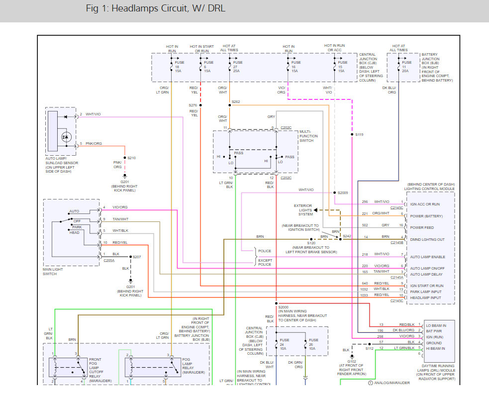

when driving at night. Headlights go out . Dash lights blink off and on.Then headlights come back on . It has automatic lights switch.

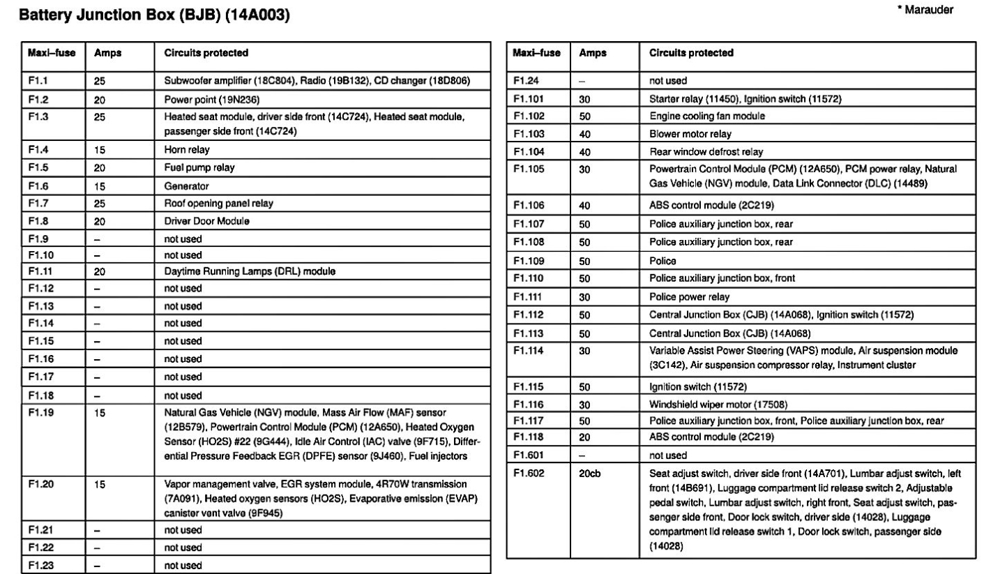

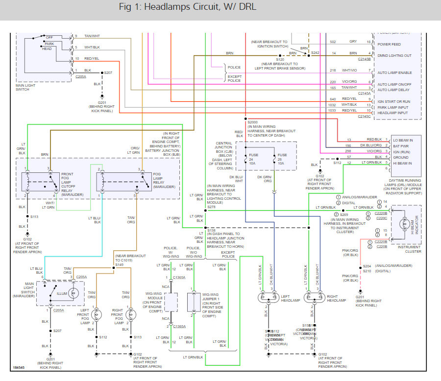

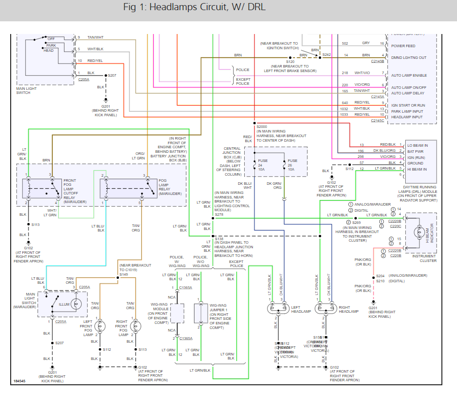

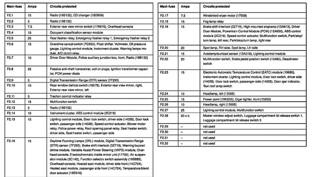

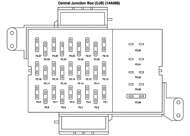

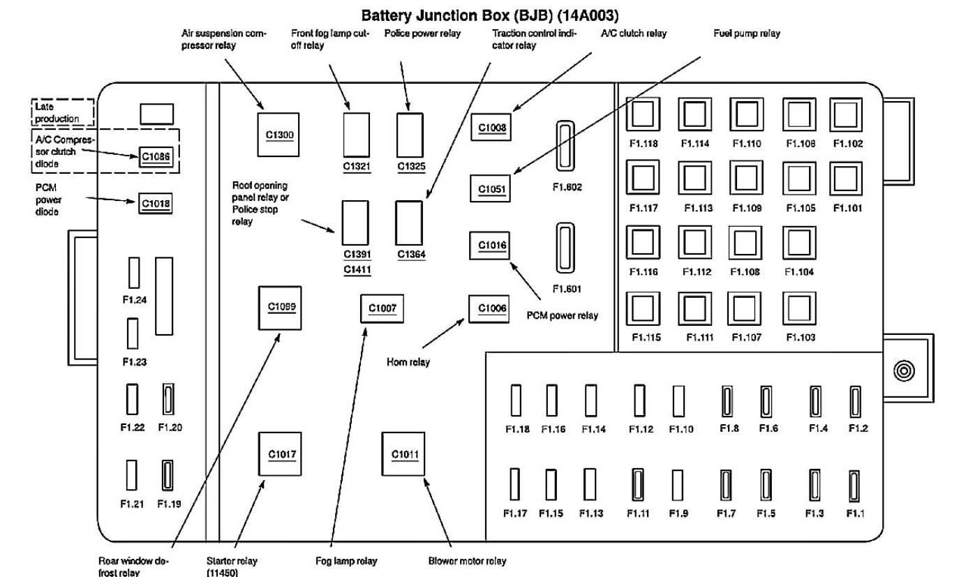

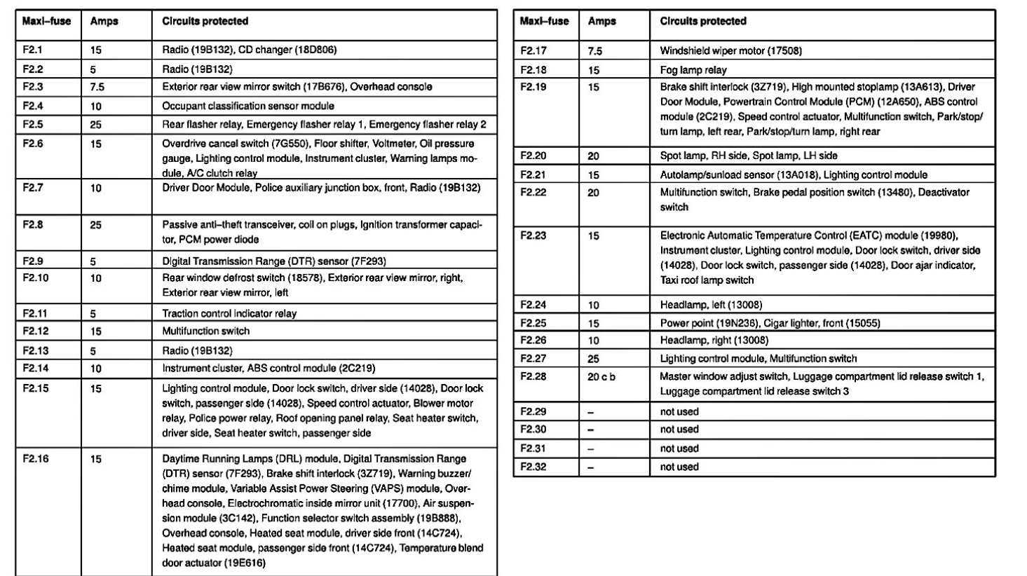

I have seen the headlight switch go out in these. To be sure here is a guide to check for power loss with the headlight wiring diagrams so you can see how the system works and which wires to test. Also there are 6 fuses that run the system which need to checked as well.
Here are the fuse locations as well. Check out the diagrams (below). Please let us know what you find. We are interested to see what it is.
