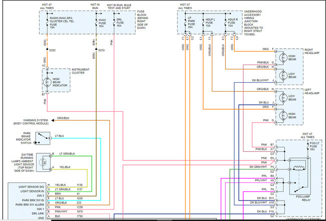

Marker and tail lights okay. From research I'm thinking it's the multifunction turn switch; I'd rather bypass the dimmer switch, but the i/p harness to steering column harness connector has different wire colors for the pins from the diagram I found. Do you have the correct one and/or any ideas?

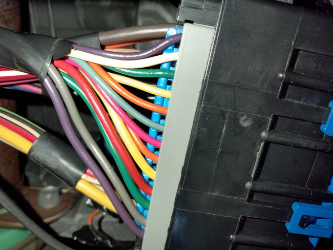

Thanks Joe, it's a 1999 Regal (yeah she's an oldie). I believe it's the E block connector. I am an electronic tech professional (amateur mechanic).
Photo is underside of connector.

The connector in the pic, what is that plugged into?

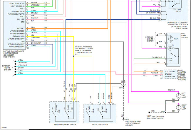

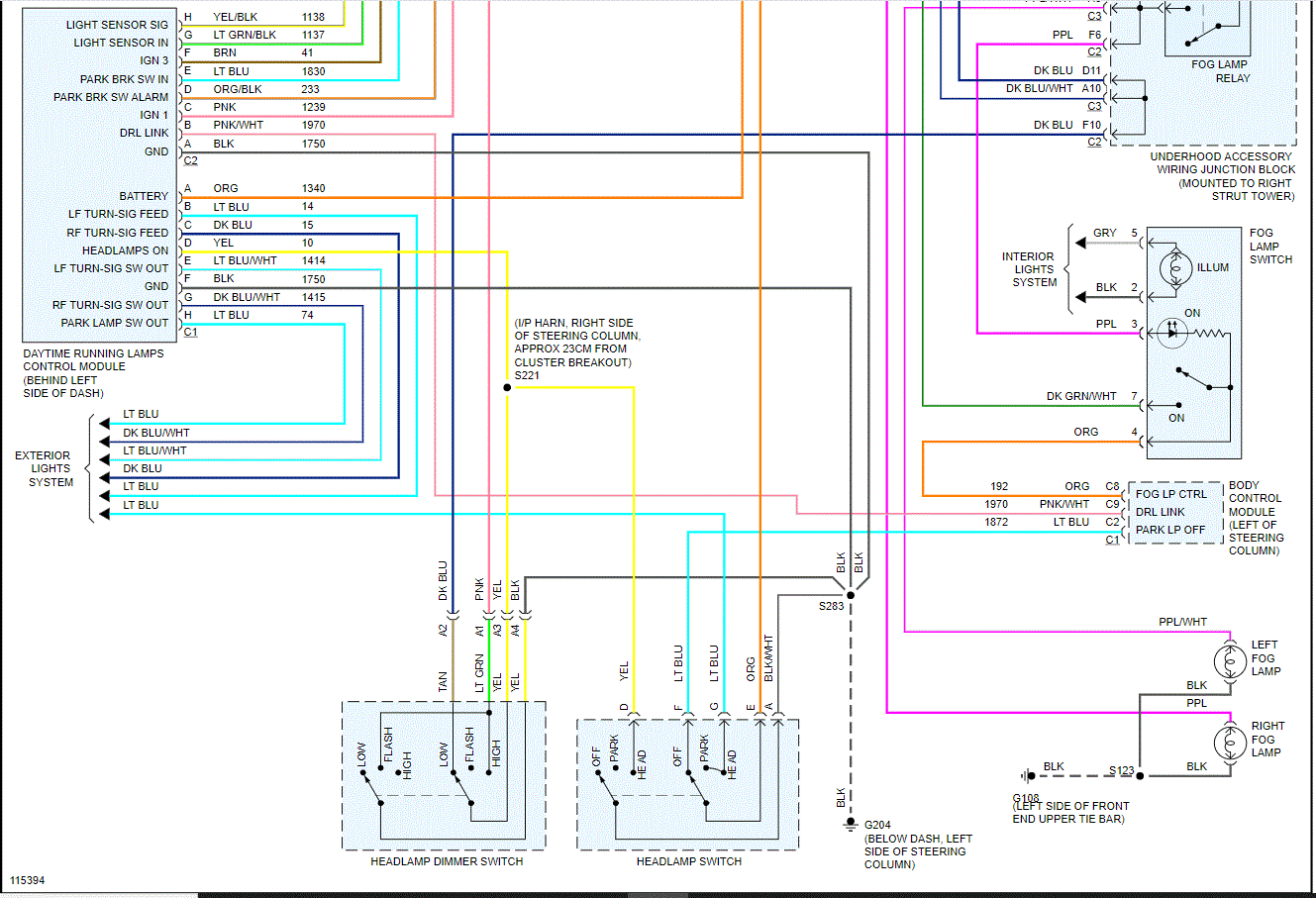

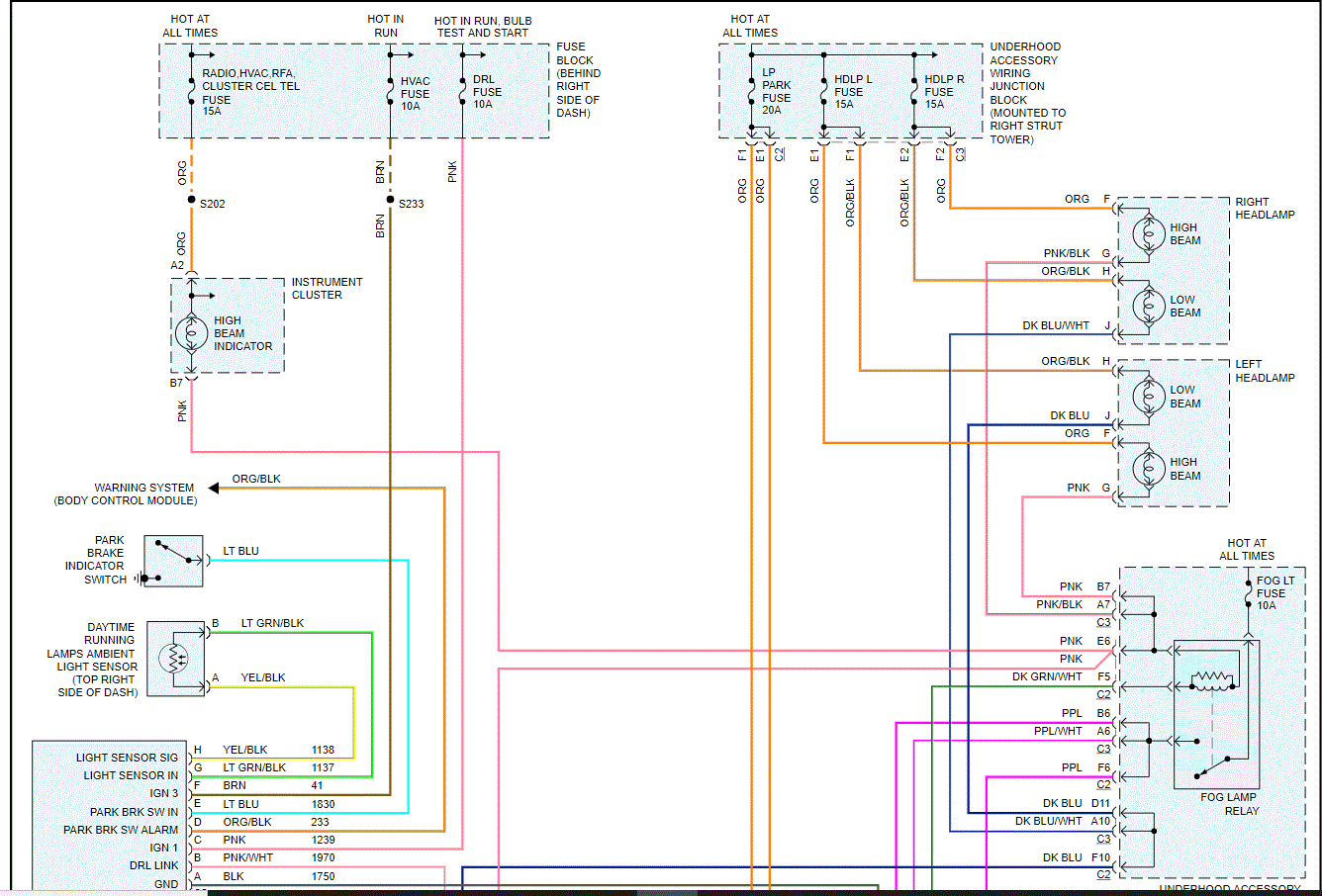

As far as the wiring schematic for the headlamps, I attached them below. It doesn't have a pinout for the connector you are showing me. Let me know where that is located.
The wiring schematic was a page long. I had to cut it in half to make it readable for you. I did overlap them so you can follow from one to the next.
Let me know if this helps.

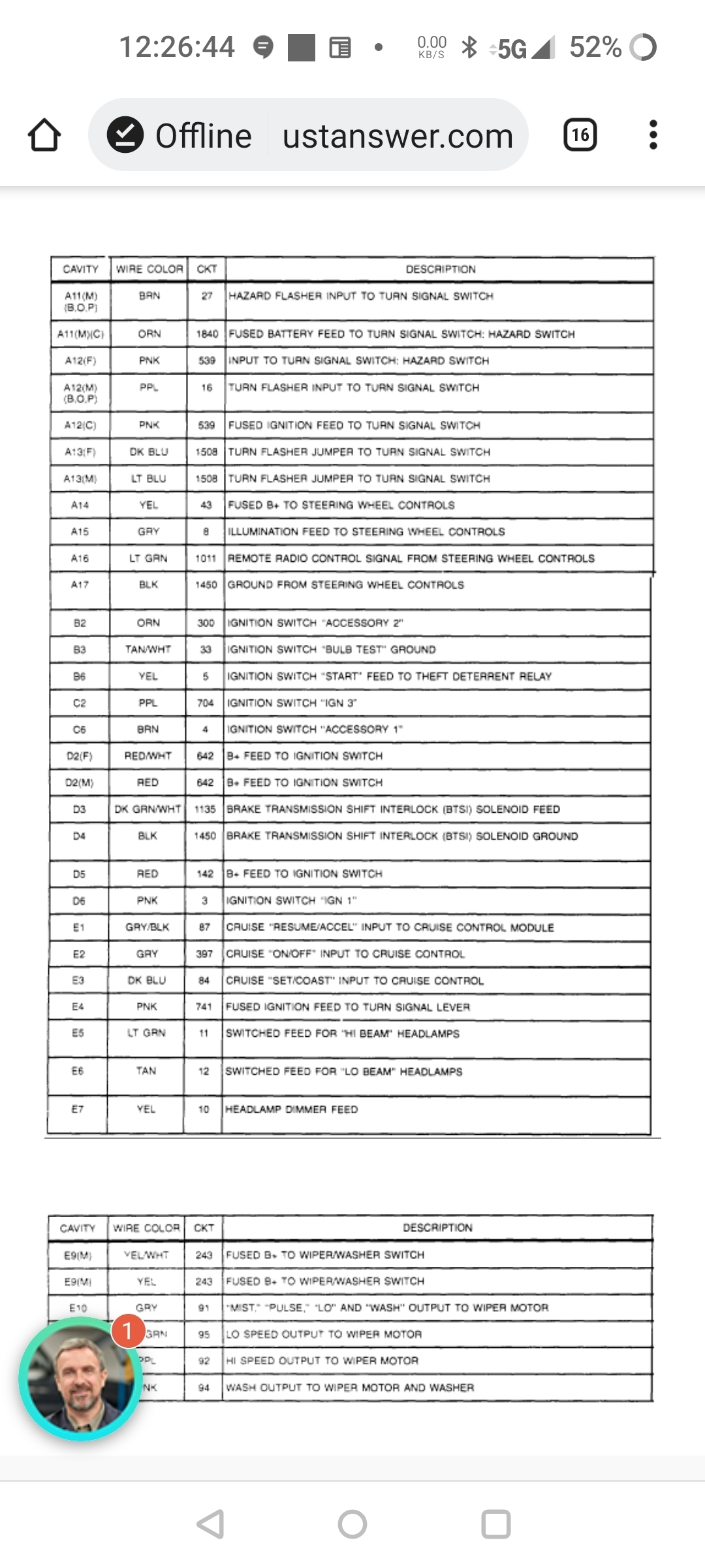

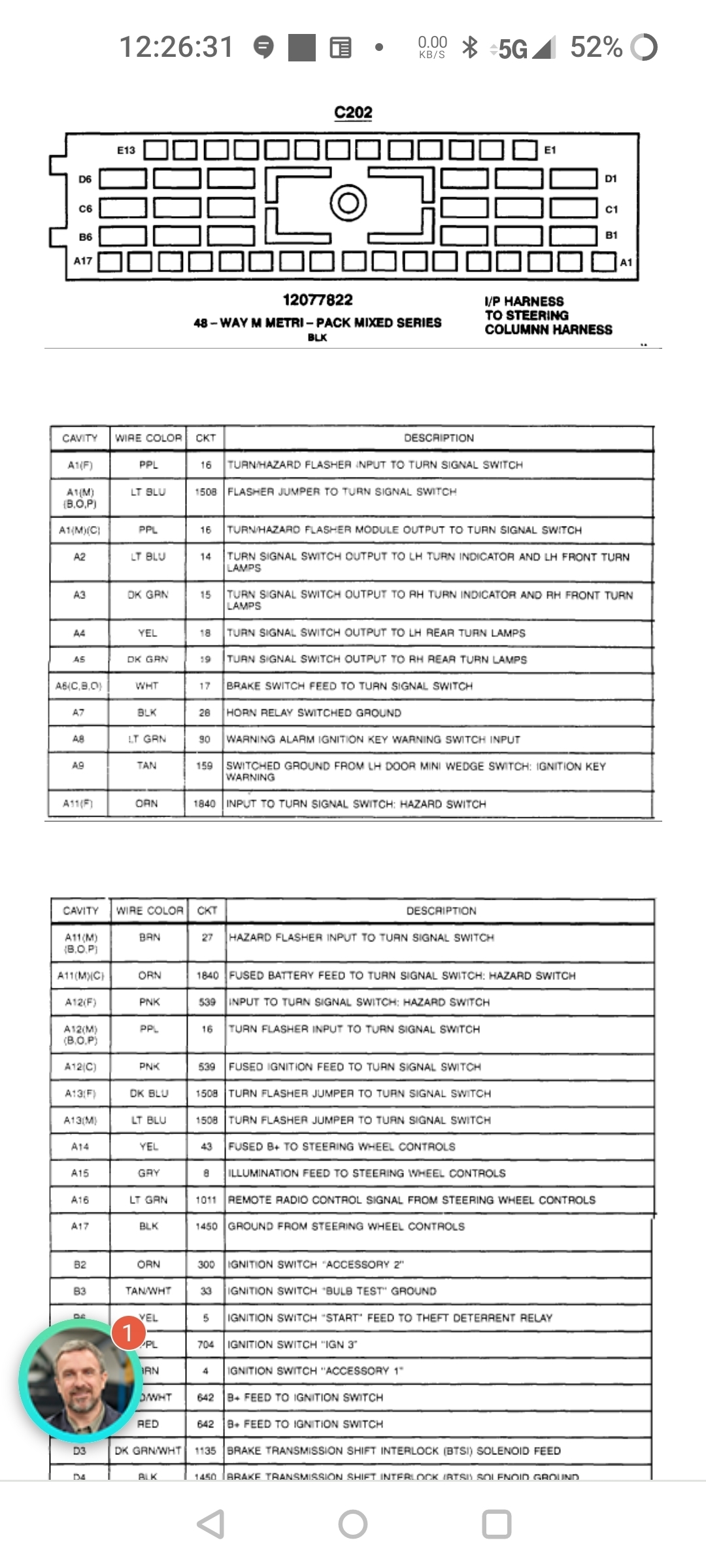

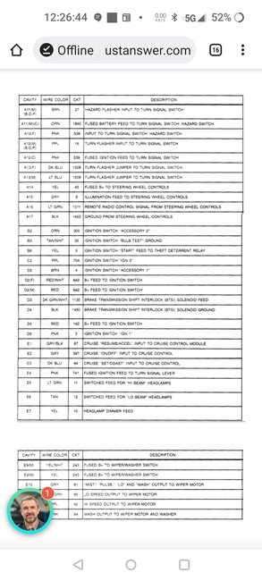

The schematic you sent should help; the connector plug I referred to is the instrument panel harness to steering column harness which is to the right of the steering column, next to the diagnostic test plug. Since I believe the problem is with the hi/lo beam switch in the multifunction turn signal, I was planning to bypass it there. If you can't find the schematic, that's okay, I can figure it out with what you've supplied. I've attached the diagram I found, which is the correct plug, but wire colors are different.

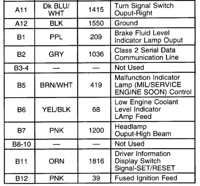

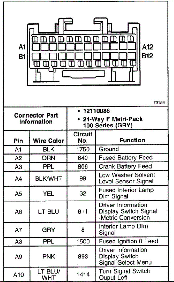

Henry,
I have the pinout for the instrument cluster. I attached it below. I cut the legend in half so you can read them easier.
I was unable to read what you attached because they are blurry, so I couldn't compare what I have to it. Regardless, take a look through it and let me know if they help.
