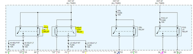

The headlights on my truck listed above 2500hd won't come on all. of the
fuses are okay and when I pop off the relay and put it back in I can hear it
clicking, but I have no power from the headlight up past the main plug. any
ideas on where the problem may be?

Have you checked the relay? I realize you hear it making noise, but it could still be bad. Take a look through this link. It explains how to test one.
If there is a relay with the same part number, try that.

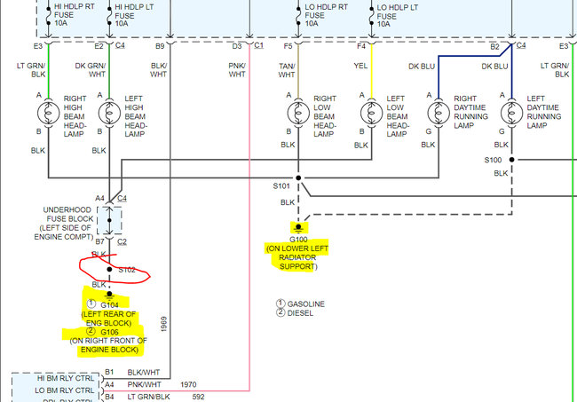

Next, if you are certain the fuses are good and both relays check good, then we need to check for a ground. If you look at the two pics below, the first indicates the relays and the second shows the two grounds needed (highlighted) and I circled a splice in the wiring. If you find there is no continuity to the G104 and G106, follow the wiring back from the ground location and locate and check the splice.
