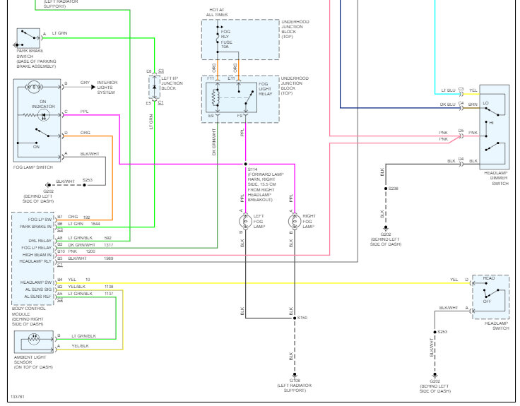

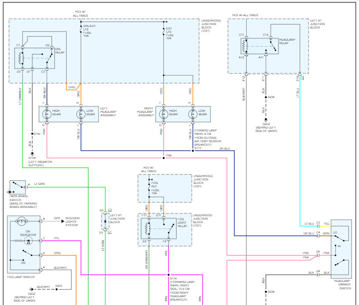

i have a set of sonar SK3302 headlights that the previous owner installed. However, the wiring was spliced and was wrong. i am having to do it all over and i can't find any sort of information about wire color codes for this set of headlights. i have a chevy impala 01 but the front end (bumper and grille) has been replaced from parts off of a Chrysler and the set of headlights that fit that front end does not match the harness on the vehicle. it has been incorrectly spliced.
"Can anyone help me?"
All i really need to know is the wiring color codes and which does what, as far as daytime running, high beam, low beam, etc.

As far as aftermarket items are concerned, I won't have schematics. However, I do have the headlamp wiring schematic showing wiring colors and purpose.
Take a look at the schematic below. Note that I had to cut it in half to make it readable for you. I did overlap the two so you can follow from one to the next.
