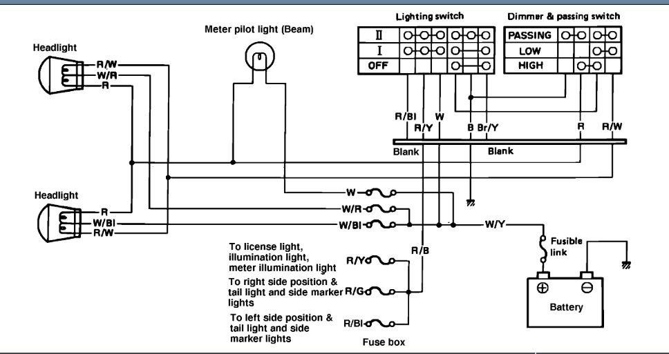

Hello there! I'm trying to put all the wiring back at my vehicle but I forgot where they belong. A wiring diagram showing where each cables goes would be perfect. I need to connect almost all the lights on the samurai and need to find the correct wires for each connection. I don't want to make any bad connections.

I attached one of the original wiring schematics for exterior lighting. I hope it helps.

Thank you so much! I'm trying to understand it. Doing my best. Thank you so much for your help. Take care.
