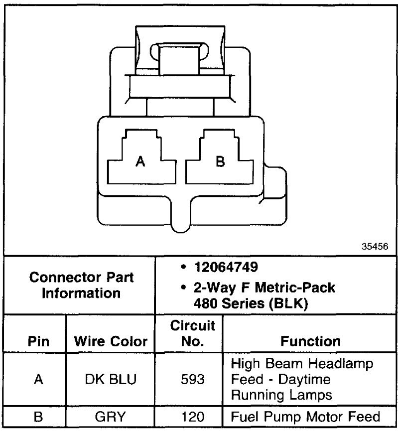

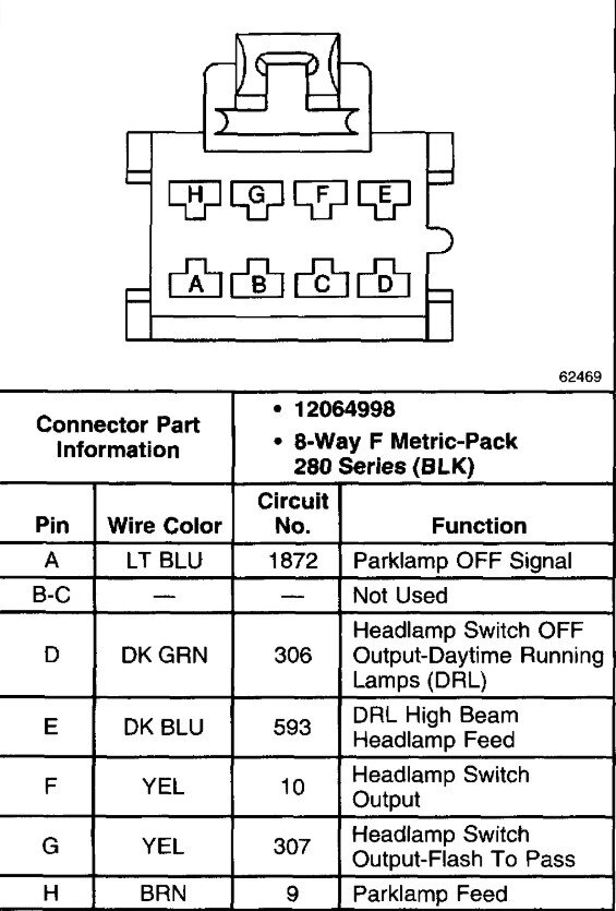

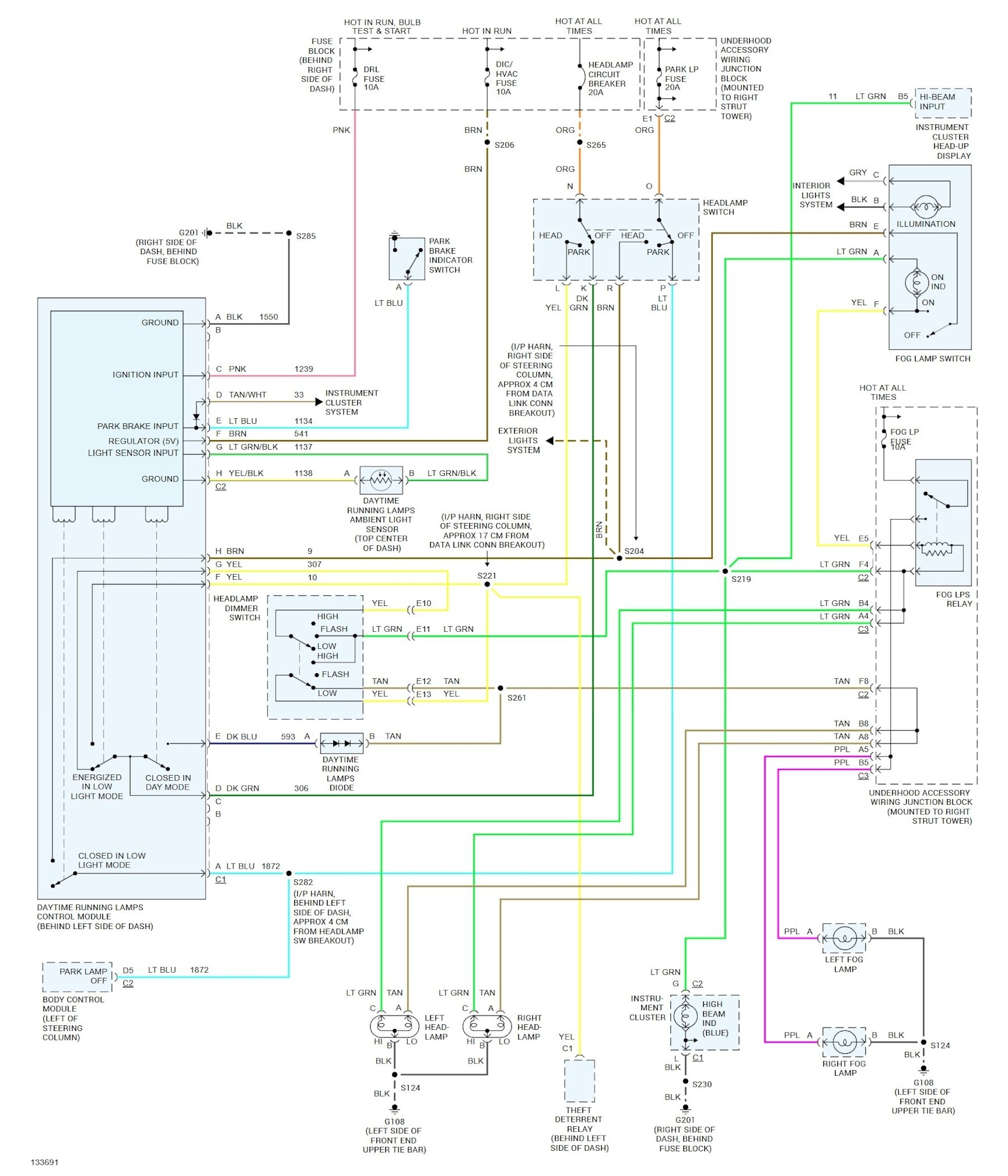

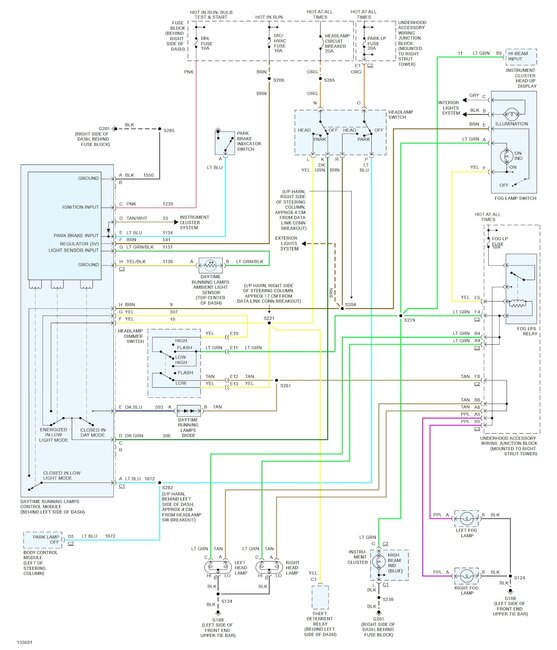

I have just recently purchased this vehicle as a project to learn. The automatic headlamps and DRLs won't come on due to someone putting a d blue wire into random port at connector to use the high beams with lamps pointed downward. The port is already occupied so it sparks/sizzles when d blue tries to invade the area. There's also a black wire that is hanging out unattached. So far, I don't see an empty spot in any of the connectors at the column. Idk where to begin with relay testing but fuses/mini-fuses look to b fine. Can anyone help me find a diagram (or some knowledge!) as the net refuses to cooperate with specifics.

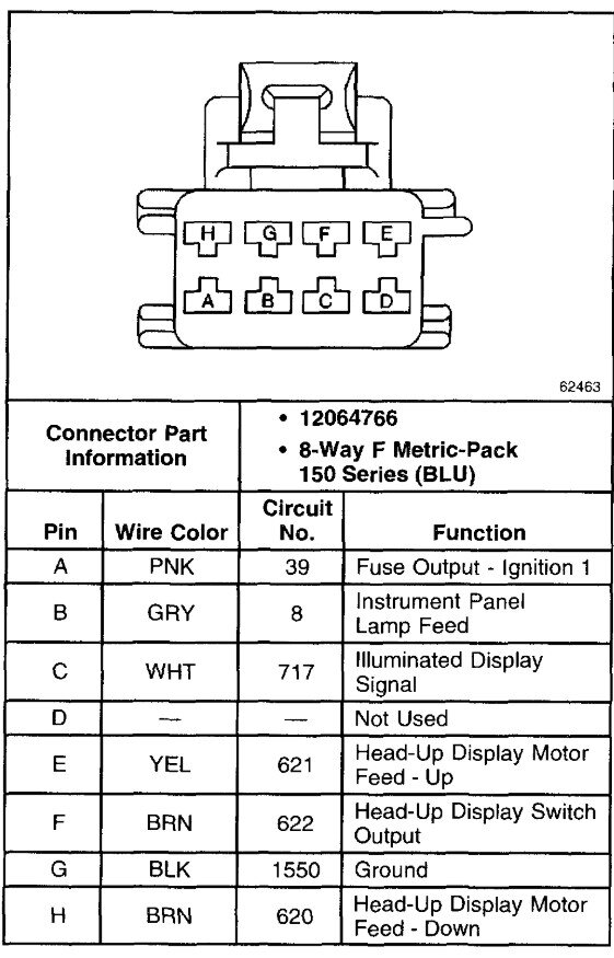

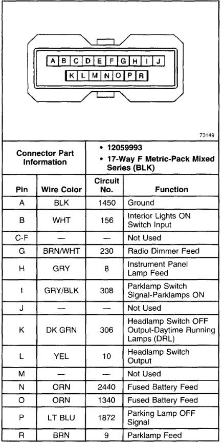

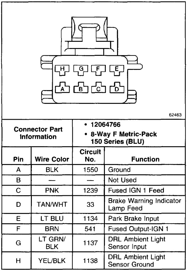

This is the color version of the wiring for that system along with the primary connectors. I would start by looking at the connectors and determining if the wires are in the correct positions. It sounds like the PO may have been trying to bypass the DRLs or make it so the lights were not automatic. Hard to say, but tracing the wiring first might point to a solution.
