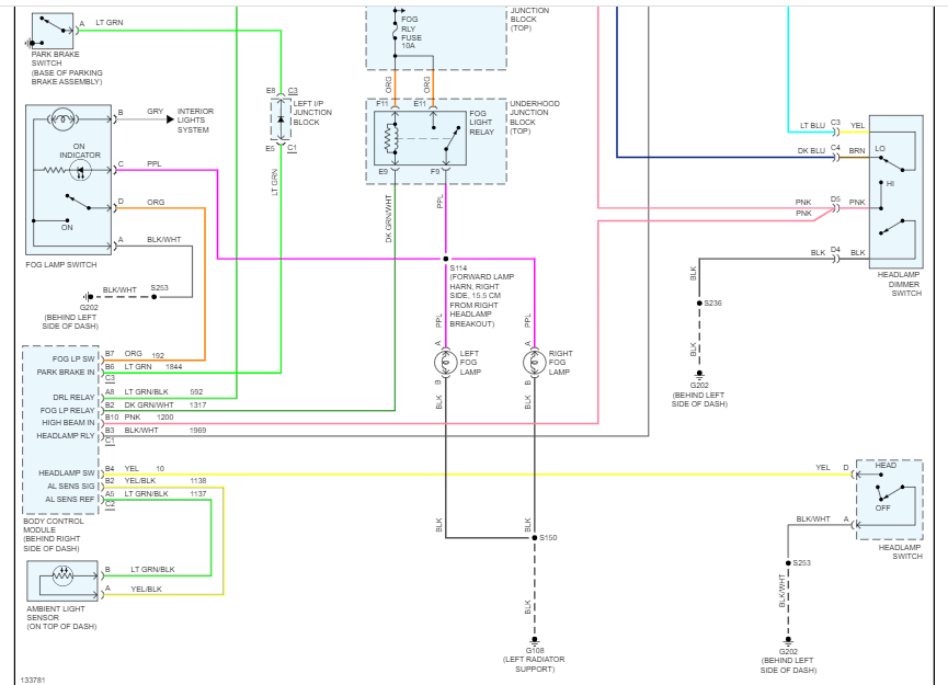

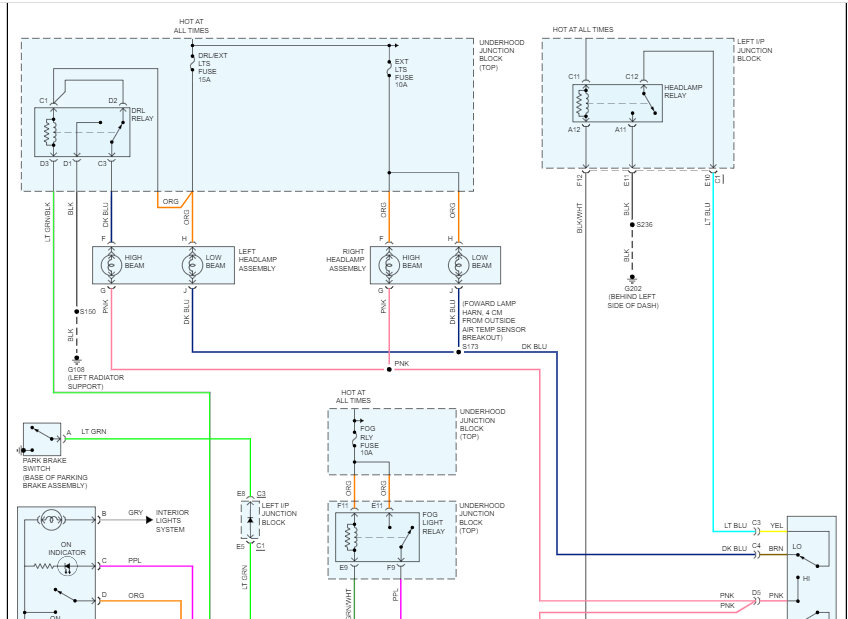

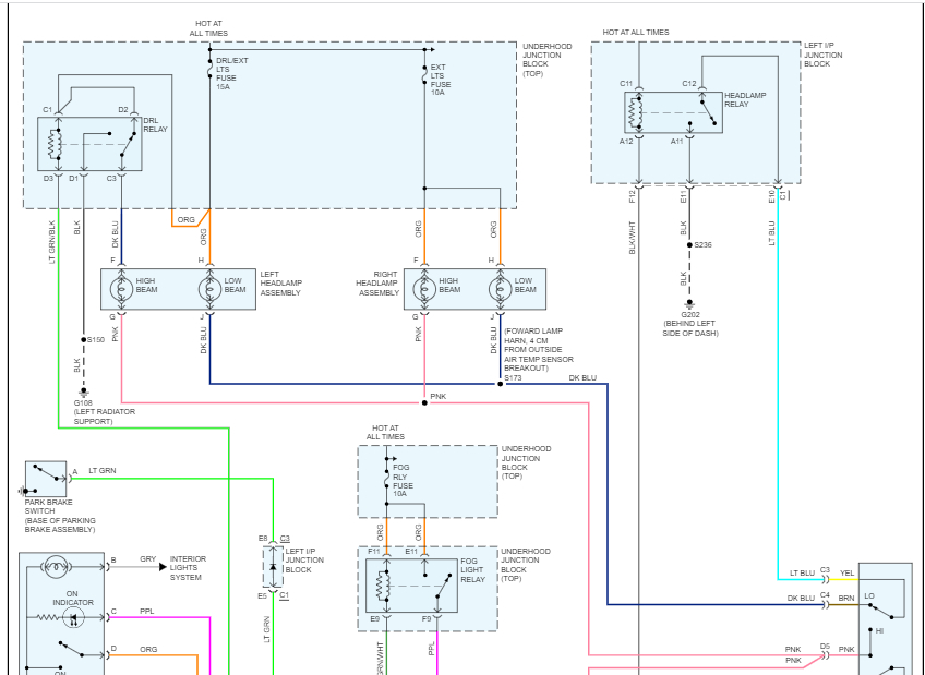

I need to know the wire color codes for headlights on the car listed above. Factory harnesses have been cut off. Need to know which wire is what so I can splice in new headlights?
Jul 29, 2023 at 7:22 PM
  • 110,251 POSTS
If you look below, I attached the wiring schematic for the headlamp circuit. Take a look through it and let me know if it helps or if you have other questions.
Note: The schematic was a page long, but I had to cut it in half to make it readable for you. I did overlap the two so you can follow from one to the next.
Let me know if this helps.
