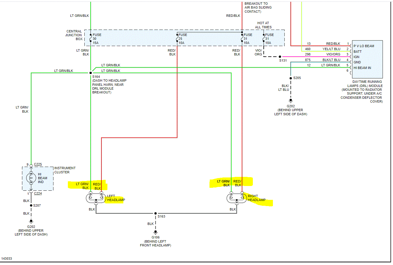

I need to now the wire color components from my 2001 e350 to hardwire a upgrade kit from a 2014 e450 that has different wire colors then my 2001' which I'm using.
Jul 1, 2021 at 6:00 PM
  • 110,236 POSTS

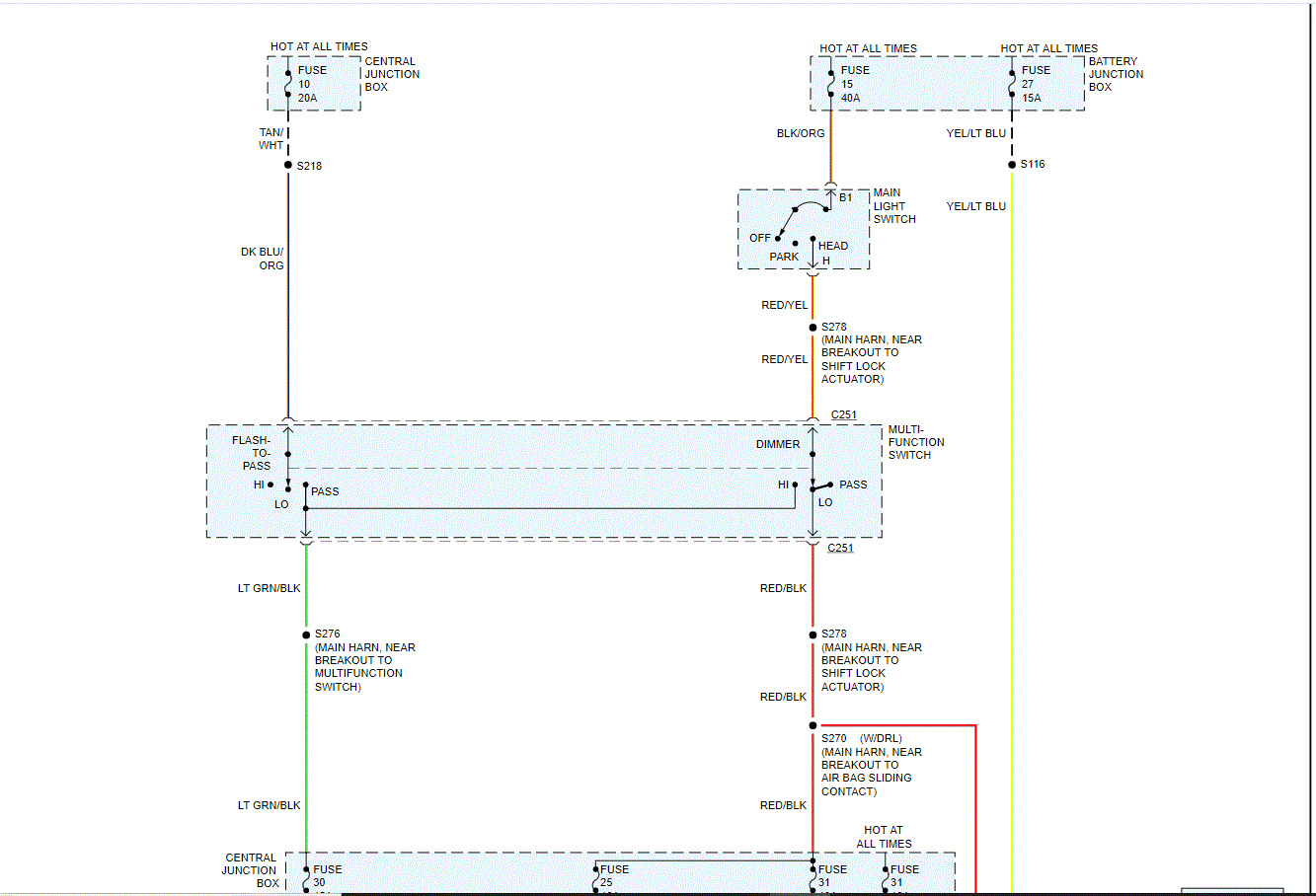

If you look at the pics below, I attached the wiring schematic for the headlamp system. One of the wires will be light green with a black tracer, and the other will be red with a black tracer. I highlighted the wires where they meet the headlamps. (pic 2)
Here is a link you may find helpful when working with the wiring:
