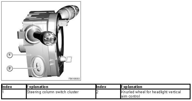

Good evening.
I was wondering if you had a DIY video on replacing the level sensor and its location on the vehicle? Thank you.
Jan 24, 2019 at 8:01 PM
  • 110,190 POSTS
Hi and thanks for using 2carpros,com
Are you referring to the footwell Module? The knurled wheel for manual headlight vertical aim control (3 positions) is on the left-hand side trim panel of the steering column. Take a look at the attached picture.
The signal from the knurled wheel is routed through the steering column switching center. The footwell module (FRM) activates the headlight vertical aim control.
