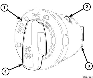

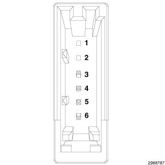

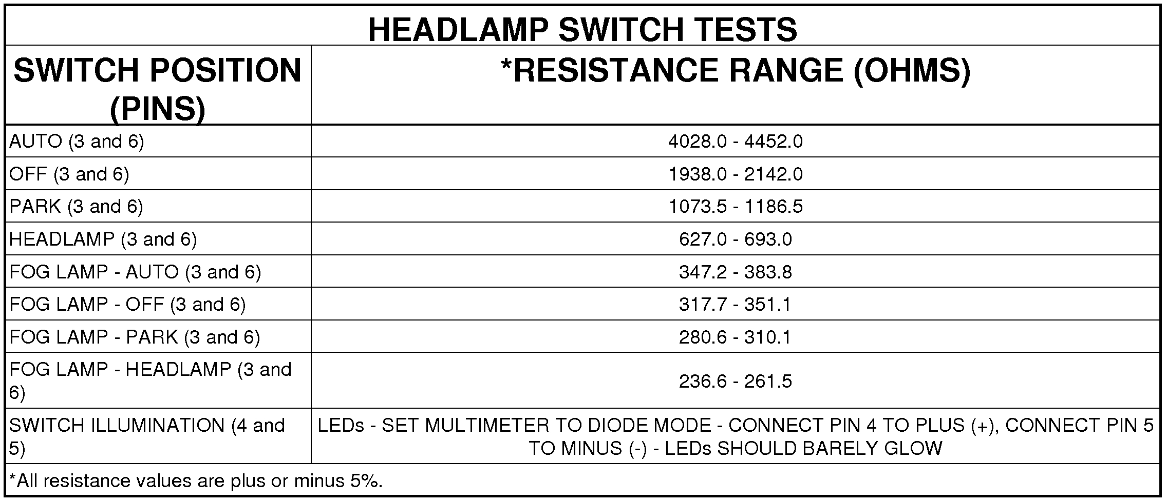

I have to be honest, it sounds like the headlamp switch needs replaced. Something internally is most likely shorting. The only way to be sure is to first check to see if there is a diagnostic trouble code related to the switch or follow a test procedure to check the switch. If you feel comfortable following a flow chart to check the switch operation, here are the directions. The attached 2 pics correlate with the directions.

pic 1
1. Remove the headlamp switch from the instrument panel. See: Headlamp Switch > Removal and Replacement > Headlamp Switch - Removal.
2. Disconnect the instrument panel wire harness connector from the back of the headlamp switch.
3. Using an ohmmeter, test the resistance between the terminals of the switch as shown in the Headlamp Switch Tests table.
pic 2
4. If the switch fails any of the tests, replace the ineffective headlamp switch as required.

Here are the directions for removal of the switch which is required to check it. The remaining pictures correlate with these directions.
2012 Dodge Charger RWD V8-5.7L
Vehicle Sensors and Switches Sensors and Switches - Lighting and Horns Headlamp Switch Service and Repair Removal and Replacement Headlamp Switch - Removal
HEADLAMP SWITCH - REMOVAL
REMOVAL
WARNING: To avoid serious or fatal injury on vehicles equipped with airbags, disable the Supplemental Restraint System (SRS) before attempting any steering wheel, steering column, airbag, seat belt tensioner, impact sensor or instrument panel component diagnosis or service. Disconnect and isolate the battery negative (ground) cable, then wait two minutes for the system capacitor to discharge before performing further diagnosis or service. This is the only sure way to disable the SRS. Failure to take the proper precautions could result in accidental airbag deployment.
pic 1
1. Disconnect and isolate the battery negative cable.
2. Place the headlamp switch (1) rotary knob (4) in the OFF (O) position.
3. Push in on the rotary knob to engage the switch retainer (2) retractor mechanism.
4. Still holding the switch rotary knob depressed, rotate the knob clockwise toward the park lamps ON position to retract the two switch retainers. The retainers will be fully retracted before the rotary knob actually reaches the park lamps ON position.
5. With the switch rotary knob still in the retainer retractor position, pull the switch out of the cylinder-like mounting hole far enough to access and disconnect the instrument panel wire harness connector from the connector receptacle (3) on the back of the switch housing.
6. Remove the headlamp switch from the instrument panel steering column opening cover.
