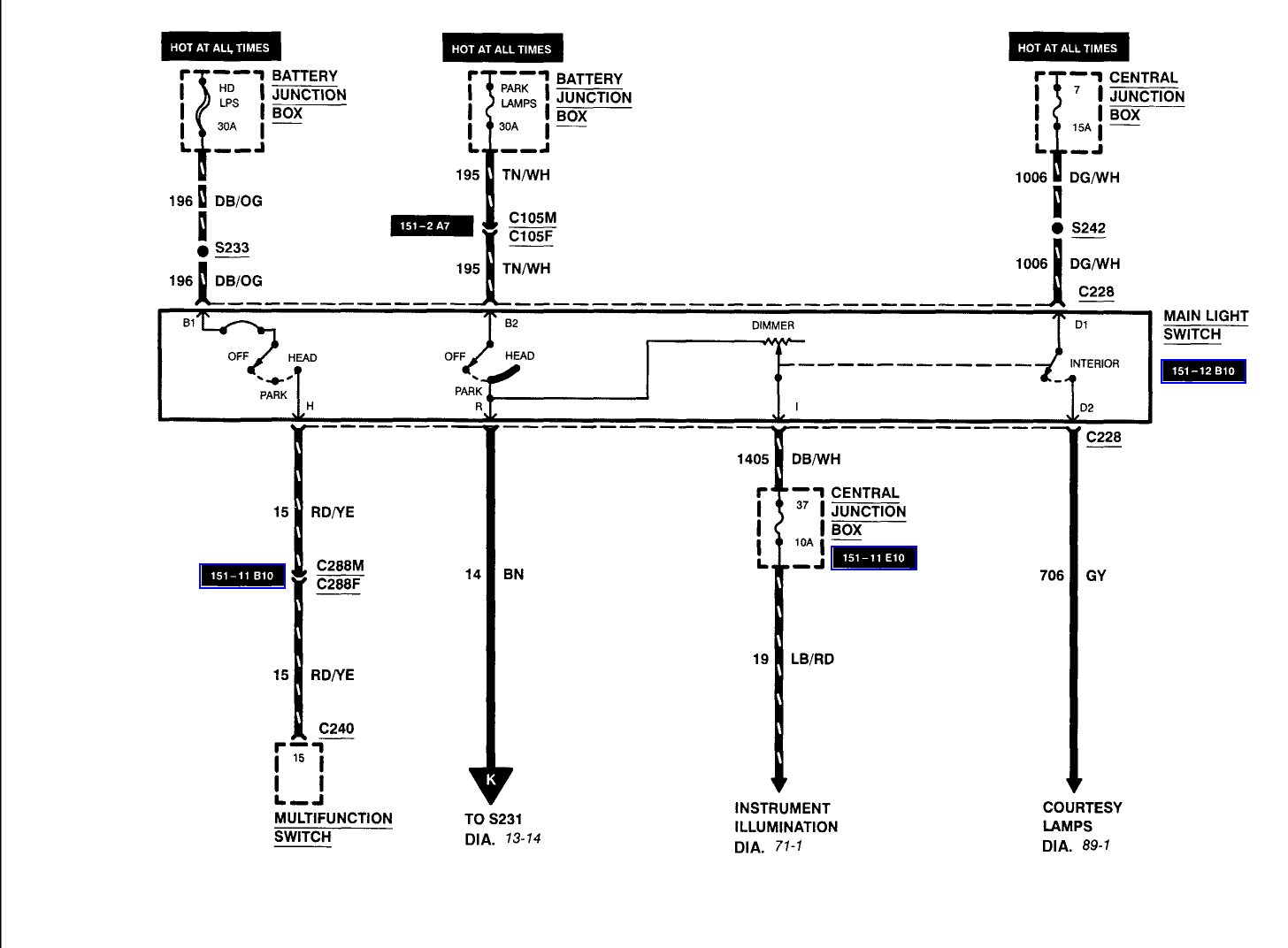

Headlight switch/wires
1999 FORD MUSTANG
200,000 MILES • 4.6L • V8 • 2WD • AUTOMATIC
WES DAVIS
I need a wire diagram telling me which wires go where on the headlight switch pull switch. I was not the person who disconnected the wires. now I need to connect them. the car is the Gt model.
Dec 26, 2017 at 12:31 AM
STEVE W.
  • 15,348 POSTS
This is the diagram showing the switch. Is the plastic connector still there or ? Check out the diagrams (Below). Please let us know if you need anything else to get the problem fixed.
