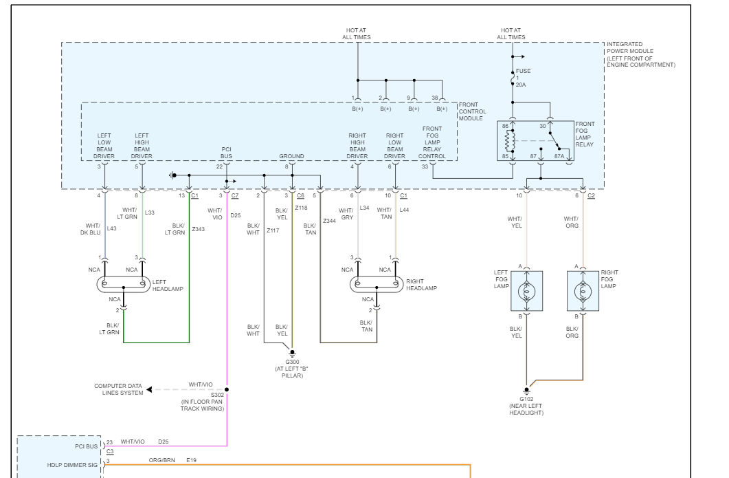

Headlight switch went out?
310,000 MILES • 2.4L • 4 CYL • 2WD • AUTOMATIC
ROGER THADY
Can I add a toggle switch if so what wires would I use?
Apr 20, 2023 at 11:00 AM
  • 55,616 POSTS
Yep, for the low beams use the white/dark blue for the left and tan/white for the right headlight. here is the wiring diagram so you can see how the system works. Check out the images (below). Please let us know if you need anything else to get the problem fixed.
