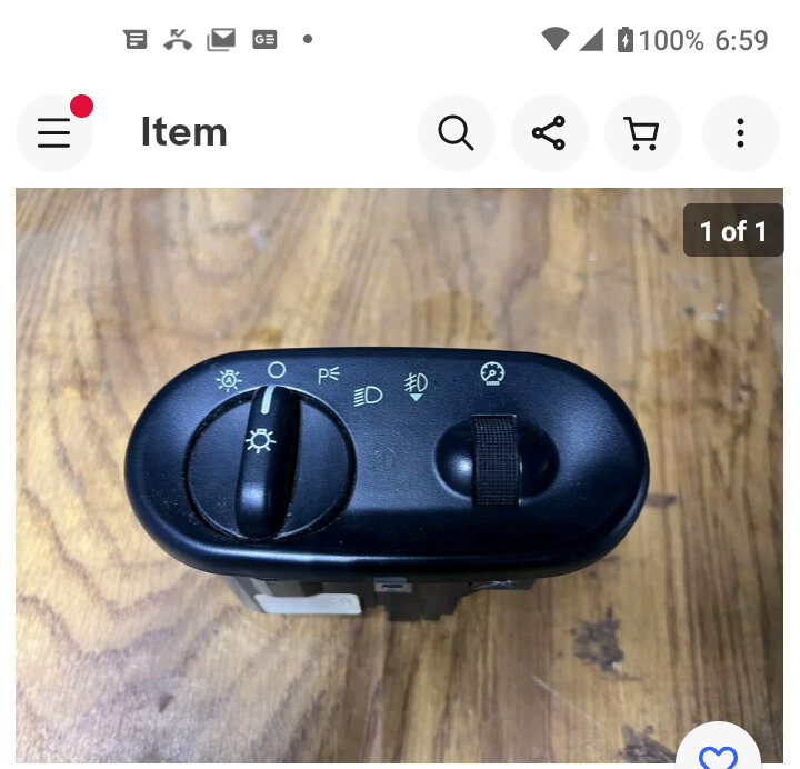

Hi, I lost my owner's manual to check this.
May be a stupid question.
What is the function of the 4 settings?

Based on the switch you have, from left to right the settings are:
1) Automatic
2) Off
3) Parking lamps
4) Headlamps
5) For Lamps/which requires you to press the toggle switch
6) Interior/cluster dimmer switch.
Is that what you needed?

Yes, that helps! I thought the first position from the left was for fog lights?
Thanks for this!
Feb 15, 2023 at 11:45 PM
  • 110,194 POSTS
You are very welcome. The fog lights turn on by pressing the headlamp switch. Nothing is ever simple anymore. LOL They had to throw a push button in there, too.
